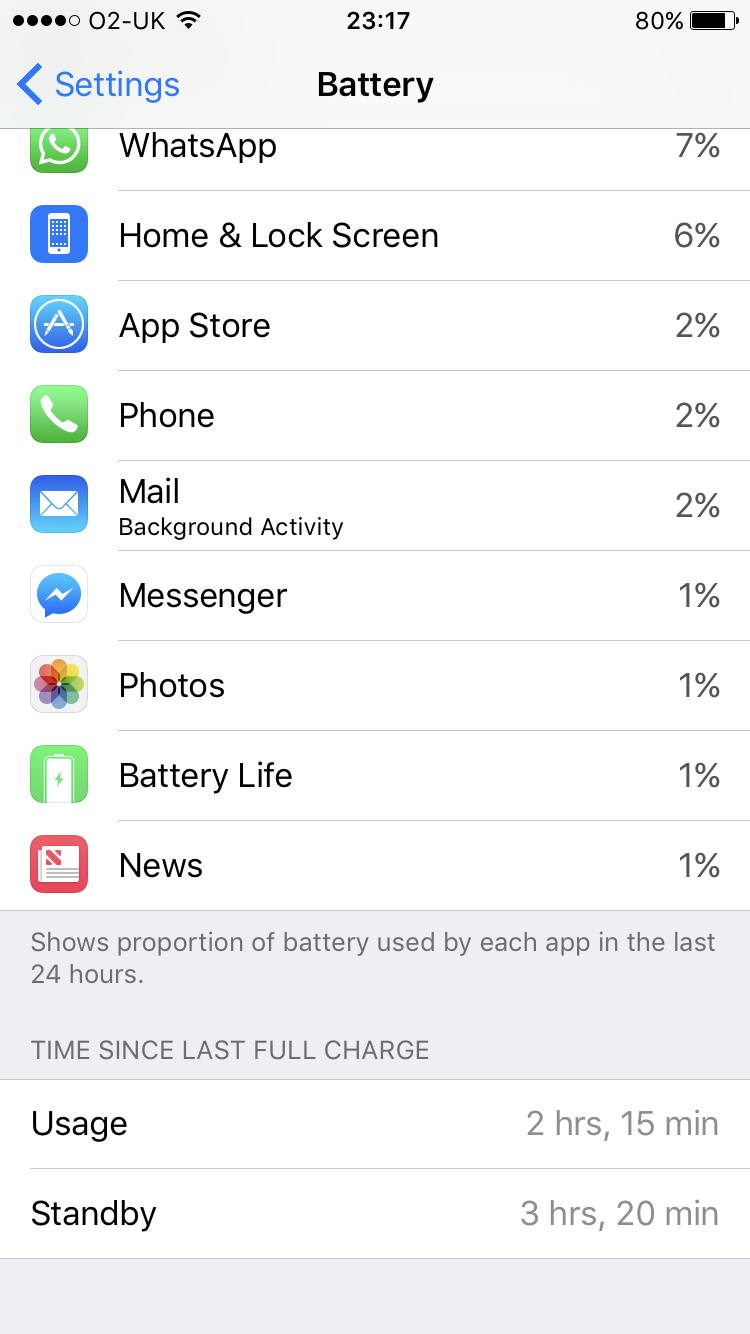

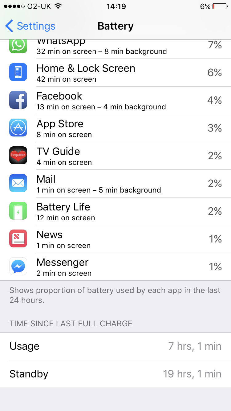

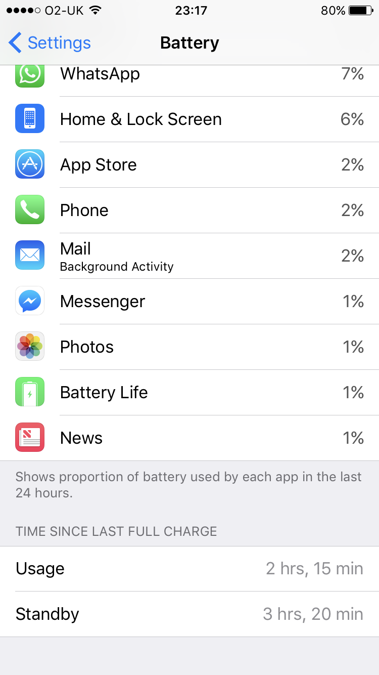

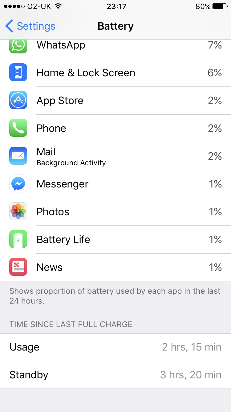

Well it's not that bad but I have a lot of things disabled and low power mode was in use half the time but maybe I just got a better battery than what normally comes in the 7

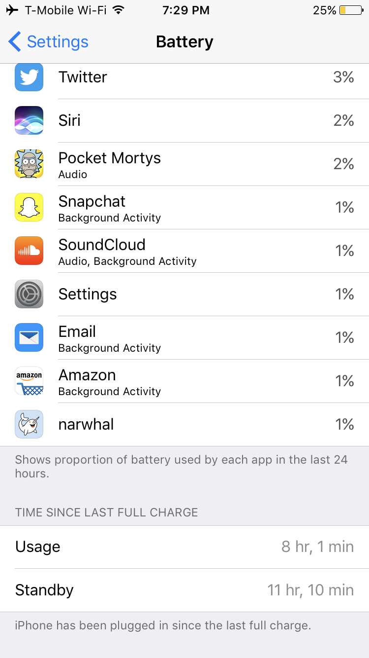

yours is decent but the other iPhone 7 we have here will do 9 hours+ usage and 50 hours standby from a full charge. (This is roughly how it should be if it's not faulty either software or hardware)
This phone would do 9 hours usage if it didn't lose 2% per hour on standby idling (which nothing can prevent it seems)

I'm going to try another SIM card in this one with the standby drain issue .. just a hunch I've got ., cus there's absolutely no reason it should be draining idle and battery is fine when I'm actually using it.

Try putting it in airplane mode and low power mode while in standby
Tried this no difference 2% per hour drop
DFU restore set up as new phone no change
Turn everything off you can possibly think of no change
But if the battery was faulty wouldn't it drop quicker while I'm actually using it too? But it competes with the super 7 we have here when the screens on so it's quite perplexing why it drains on idle for no reason. It's either faulty hardware somewhere in the phone or the SIM card now, that's all that's left. When you eliminate everything whatsevers left is the answer no matter how improbable.

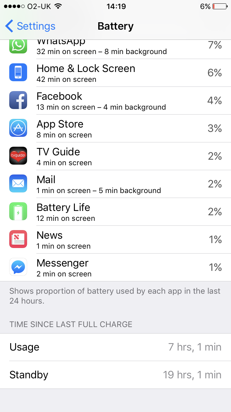

I did consider the cpu being faulty and not switching down yes
As you can see though with screen on time it works how it should
That 2 hours 15 mins is pretty much all screen on time .. the battery only falls down on standby/idle

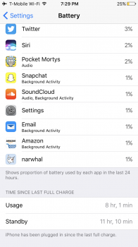

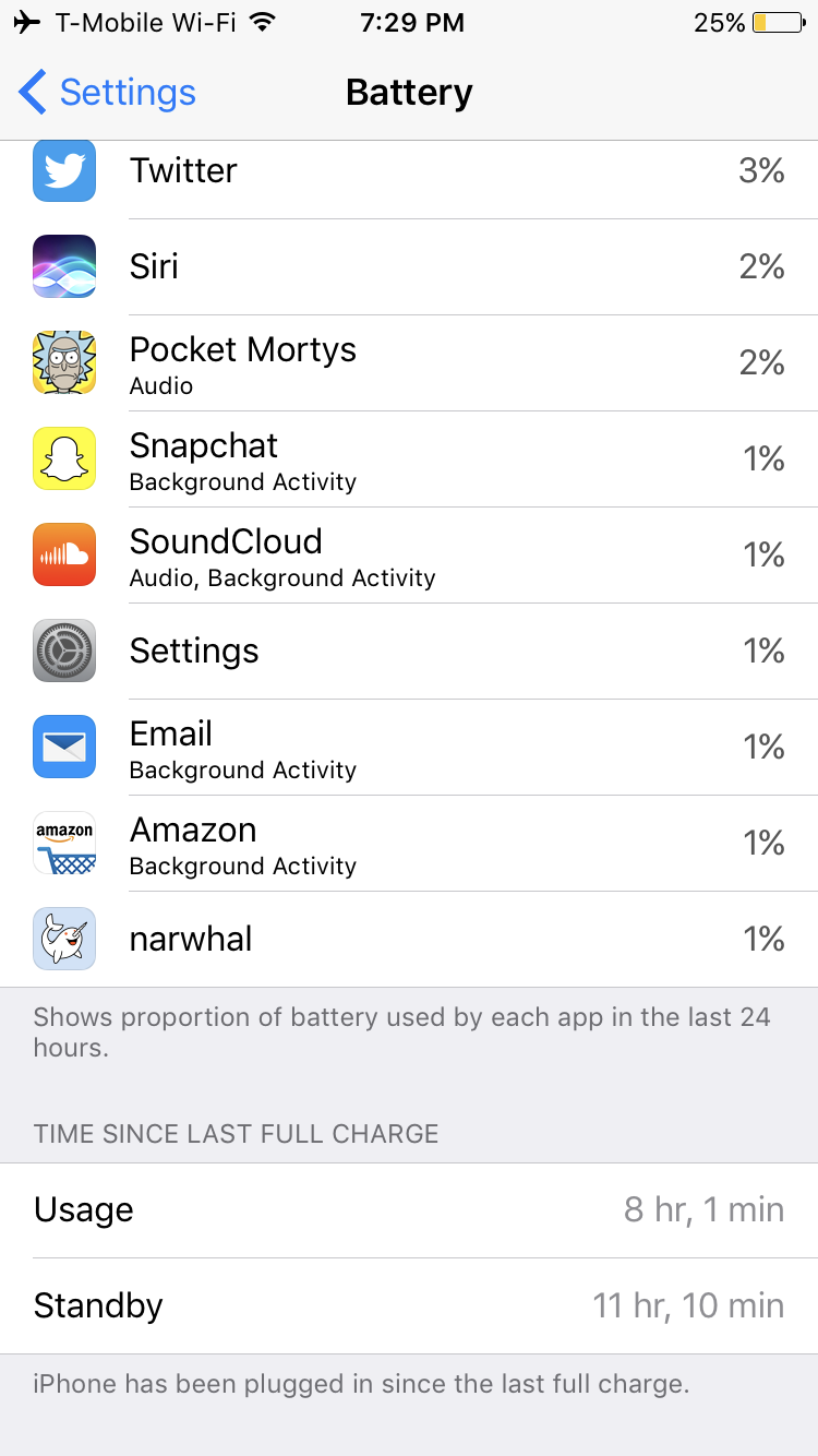

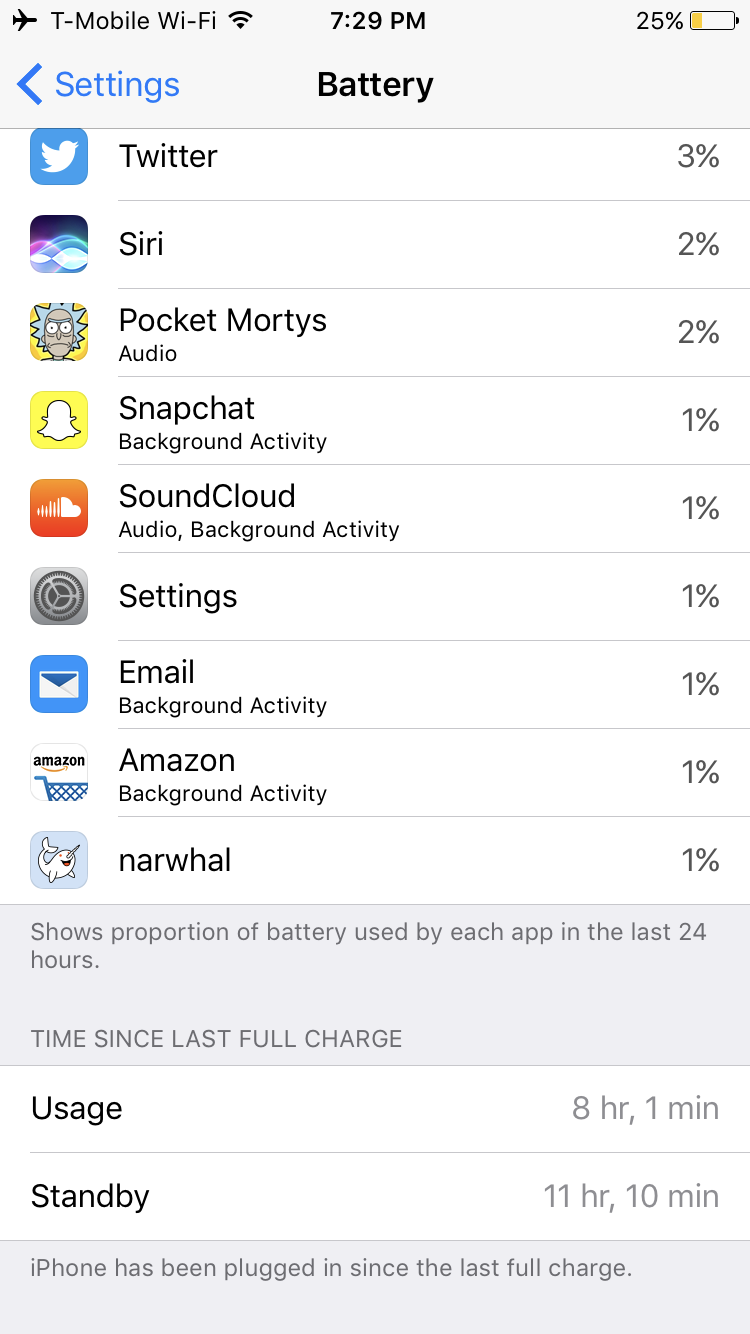

I don't know if my standby time is good or not but I'm pretty satisfied with it.
Depends how much of that was in airplane mode? Usage time certainly looks very good ..your on for 10 hours + there out of a full battery .. nice!
well I put it in airplane mode around 50 same with low power mode.

I reckon yours looks ok

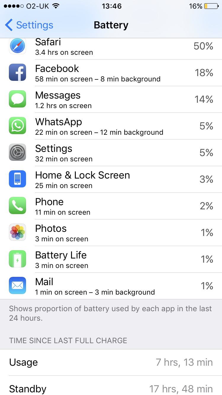

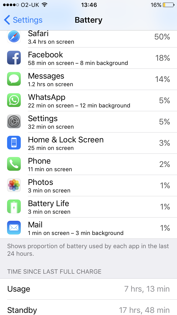

Can you show the apps that used the most power in your next full drain? Some are more demanding than others and some may be inefficient (like Facebook was for ages but I see you have low usage on that).
I'm satisfied with my 7 but I've only done a couple of full drains. I'm going to try again just for curiosity.
Can you show the most used apps in your next full drain? Some are more demanding than others and some may be inefficient (like Facebook was for ages but I see you have low usage on that).

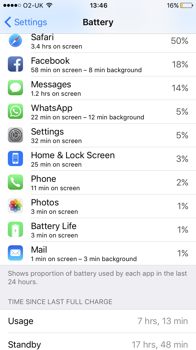

That's my current drain .. safari is top of the list but that is actual screen on time no background. There's enough battery left to get way over 8 hours usage (this doesnt go up much really with the screen off) out of it .. but I need to charge it now for work later.
I've tried uninstalling Facebook and messenger and using the website instead but I didn't notice any difference at all and as you can see it's not showing that much background activity for it really.
TBH I think my battery is pretty decent considering it strangely drains 2% per hour idle, as it's still capable of over 8 hours usage in a full day. I reckon it would do 10 without the drain issue. When I get chance I'm gunna try a different SIM card out of curiosity .. it's either the sim or a faulty part in the phone now.
That idle drain is a problem but likely software I'm guessing. Apple knows batteries pretty well.
Just out of interest, are you using any Safari content blockers and if so how many/which ones?
