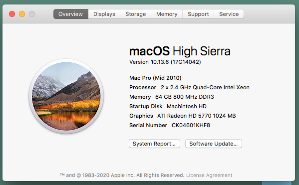

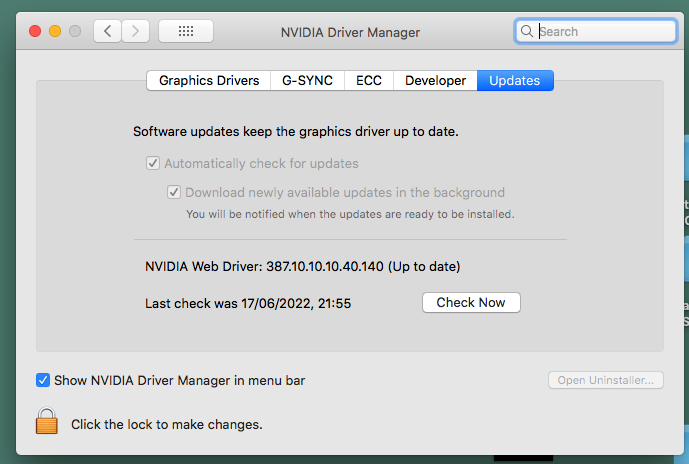

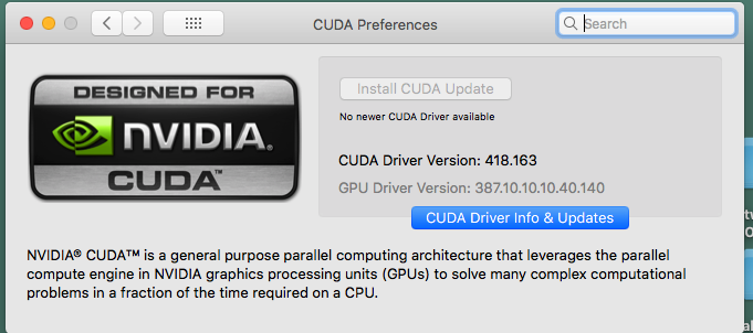

Okay here's the system report before the crash. I'm actually using the board and monitor now I had to unplug the screen briefly so this is progress at least I just wondered what had gone wrong... Thanks all. Sorry it's a bit long.
Hello, after weeks of watching this thread and the incredible support of the contributors, I am going to attempt to install the updated drivers. I have read the post detailing the uninstallation of CUDA. Is there a similar post I have missed to uninstall the display drivers also? Obviously, none of the Nvidia panels/uninstaller will open. So is there a terminal procedure like the CUDA procedure for uninstalling the Nvidia display drivers? TIA & so much appreciation for the folks in this thread and their hard work!
Reactions: Aldo006

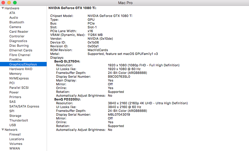

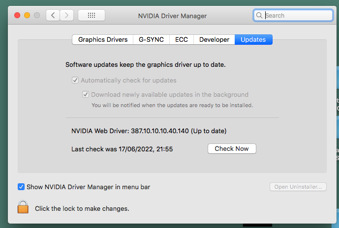

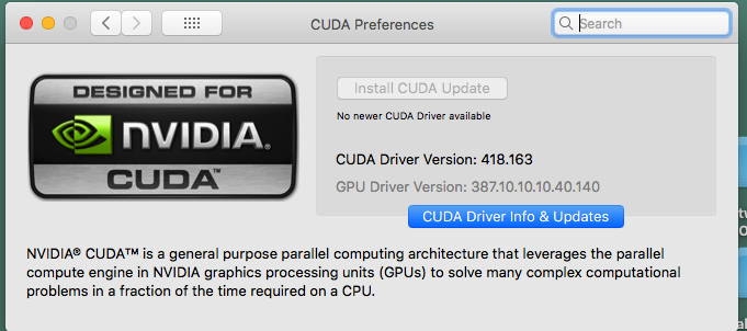

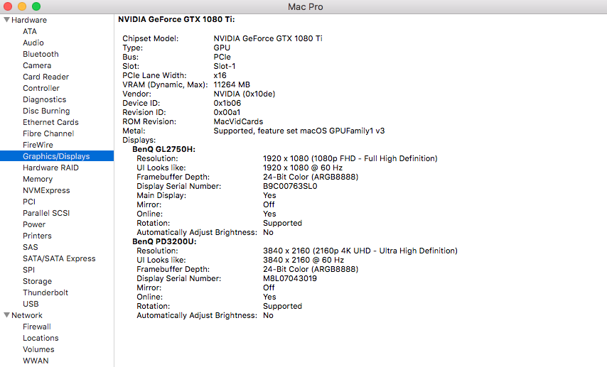

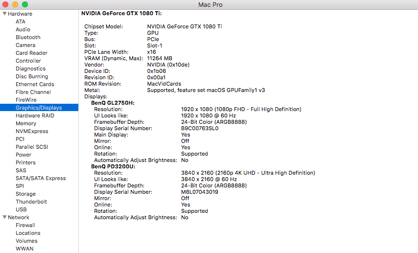

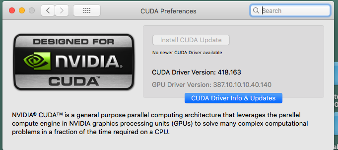

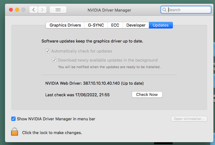

Screen shot above is after a successful installation of software and hardware. See my description below.
Nvidia successful installed after 005 and 006 security updates.
View attachment 2020816View attachment 2020815
005 and 006 security updates installed with the Radeon 5770 still installed.
Swapping out the ATI Radeon for The GTX 1080 Ti was my final action.
My workflow is described below.

I'm currently back up and running on my GAINWARD Geforce 1080Ti from macvidcards thanks to you all.
I tip my hat.
I followed the post #662 with some deviations due to my specific machine.
I could not safe boot with the shift key nor could I safe boot with the terminal. No safe boot.
I have to hold down the option key on the chime every time my Mac starts as a result of a bootcamp problem last year.
This I believe prevented me from accessing safe mode I think.
Regardless it all worked out as I'm up and running again on my Nvidia card.
Please not I also have my old ATI Radeon 5770 in during this entire process and only swapped it out for my 1080Ti at the very end.
Here is what I did as I hope it may help others.
1. I couldn't safe boot at all as I described above but I went ahead anyway in normal mode.
2. I manually uninstalled all the Cuda and Nvidia files I could find. I also used cCleaner and App Cleaner & Uninstaller. They found extra files.
3. I was on 10.13.6 (17G14019) on my Mac Pro (Mid 2010). So I installed Security update 005 first. This took 45 minutes. Upon successful installation I was now on 10.13.6 (17G14033).
4. I then installed security update 006. This took a further 40 minutes. Upon reboot I was now successfully in 10.13.6 (17G14042). Please note my booting problem is now resolved. I now no longer need to hold down the option key upon the chime during start up. Thank you updates.
Remember the ATI Radeon is in the entire time.
5. I installed the Nvidia driver posted on this thread. (No GPU detected) as the ATI Radeon is installed.
6. I installed the CUDA driver.
7. I shut down the Mac Pro. Took out the ATI Radeon. I then installed my Geforce 1080Ti. I hit the power button and she booted up into dual monitors with no problems.
I hope this will help others. Thanks a million again.
I'll keep in touch of any further developments or not.
Basically I'll let you know its all good and there is nothing to report over the coming days and weeks.

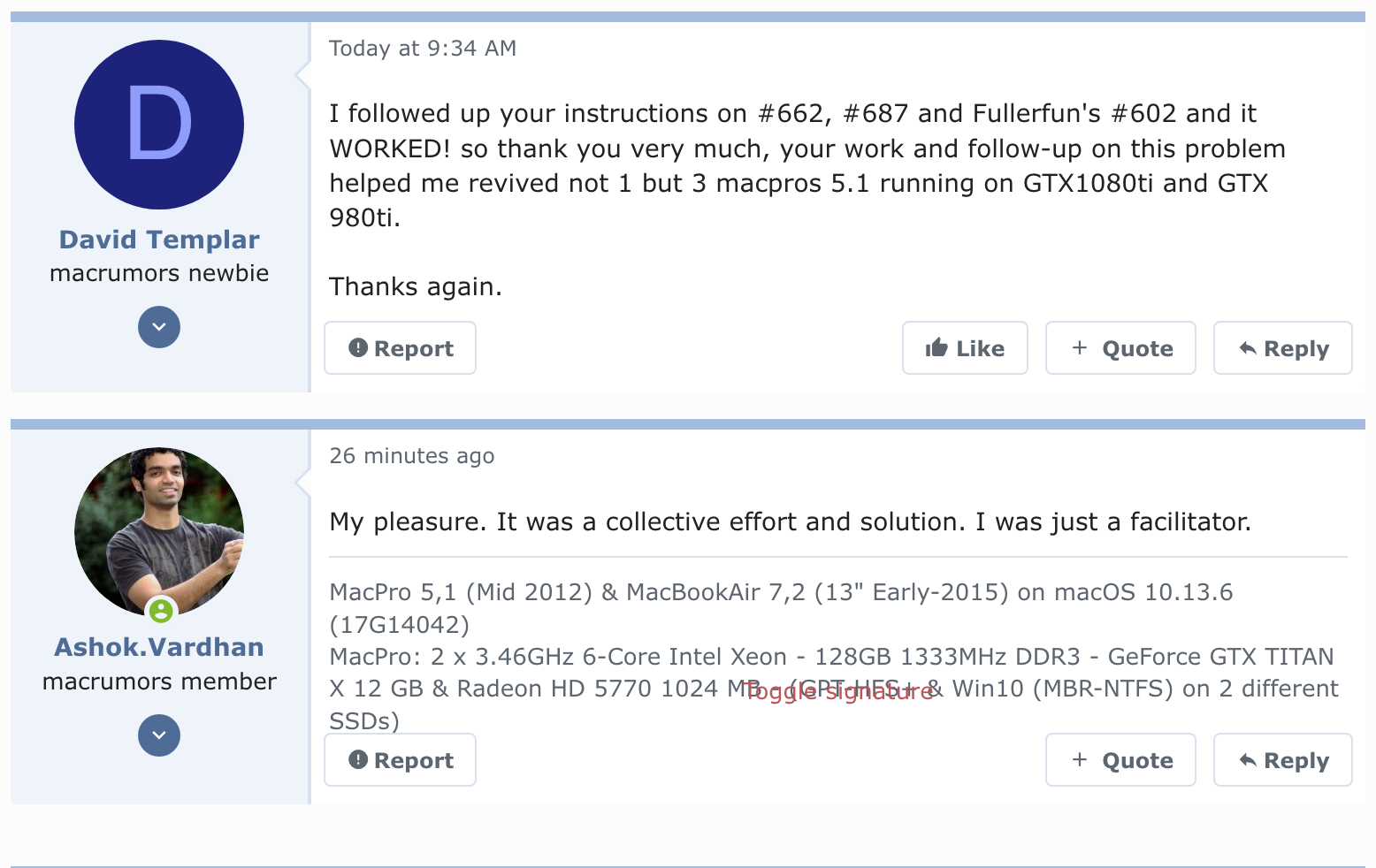

THANK YOU to all who have run this problem to earth, especially Ashok.Vardhan. My 5.1 with nvidia was all but unusable, but thanks to the information and postings here, I'm back in business. THANK YOU ALL AGAIN!!
Reactions: Aldo006

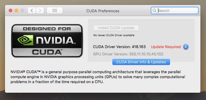

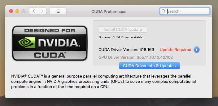

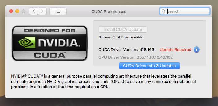

So, I started to have some issues similar to when the NVIDIA Drivers security cert. expired. I started getting the "spinning wheel" during scrolling or moving between tabs. I decided to zap PRAM to see if it would help. After reboot and log in to home page, the Pref. Pane launched and the CUDA Pref. Panne came up showing 418.163 "update required." This wasn't there after I installed it initially. I relaunched installer and reloaded CUDA 418.163 but the same "update required" highlight appears, yet nothing happens when I click on "CUDA Driver Info & Updates" button.
Anyone else running in to this CUDA msg.? At least the "spinning wheel" hasn't come back as yet!

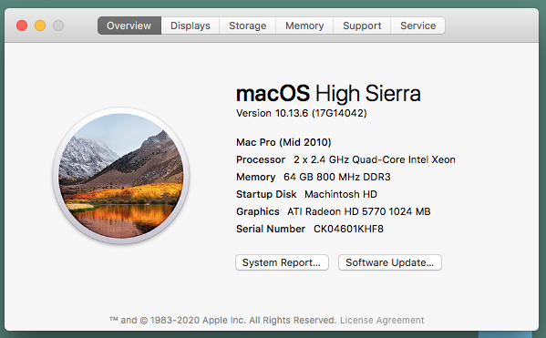

I have a MacBookAir 7,2 (13" Early-2015) on macOS 10.13.6 (17G14042) which I used to make clean installs of bootable macOS drives on SSDs (using a USB-3 to SATA adapter cable) as external drives, which I then transfer (i.e. plug into) to my older MacPro 5,1 on the SATA connectors as the primary boot drive. Works every time for Mojave, High-Sierra.
Did this for Mojave to circumvent the necessity to have a Metal compatible mac EFI card (which I did not have at that moment as my WX9100 was not getting detected by macOS) to upgrade from High-Sierra to Mojave, and I had to fly blind. Since the installer will not proceed till it detects a Metal compatible card, there was no other way other than this method to check whether the WX9100 would work in a booted Mojave install or not.
Transferring these clean install macOS drives worked every instance from the MacBookAir 7,2 to the MacPro 5,1 since the macOS versions (i.e. Mojave, High-Sierra) were officially backward compatible between these specific models.
