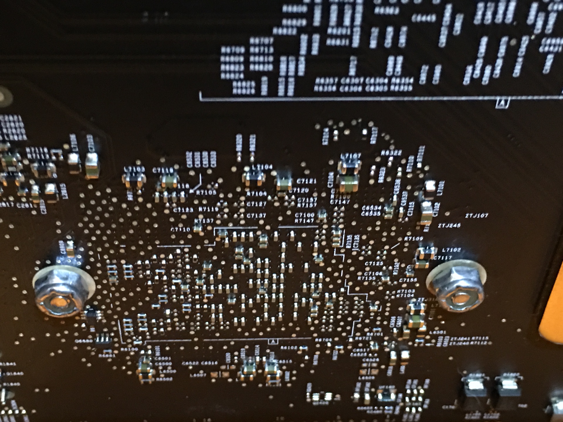

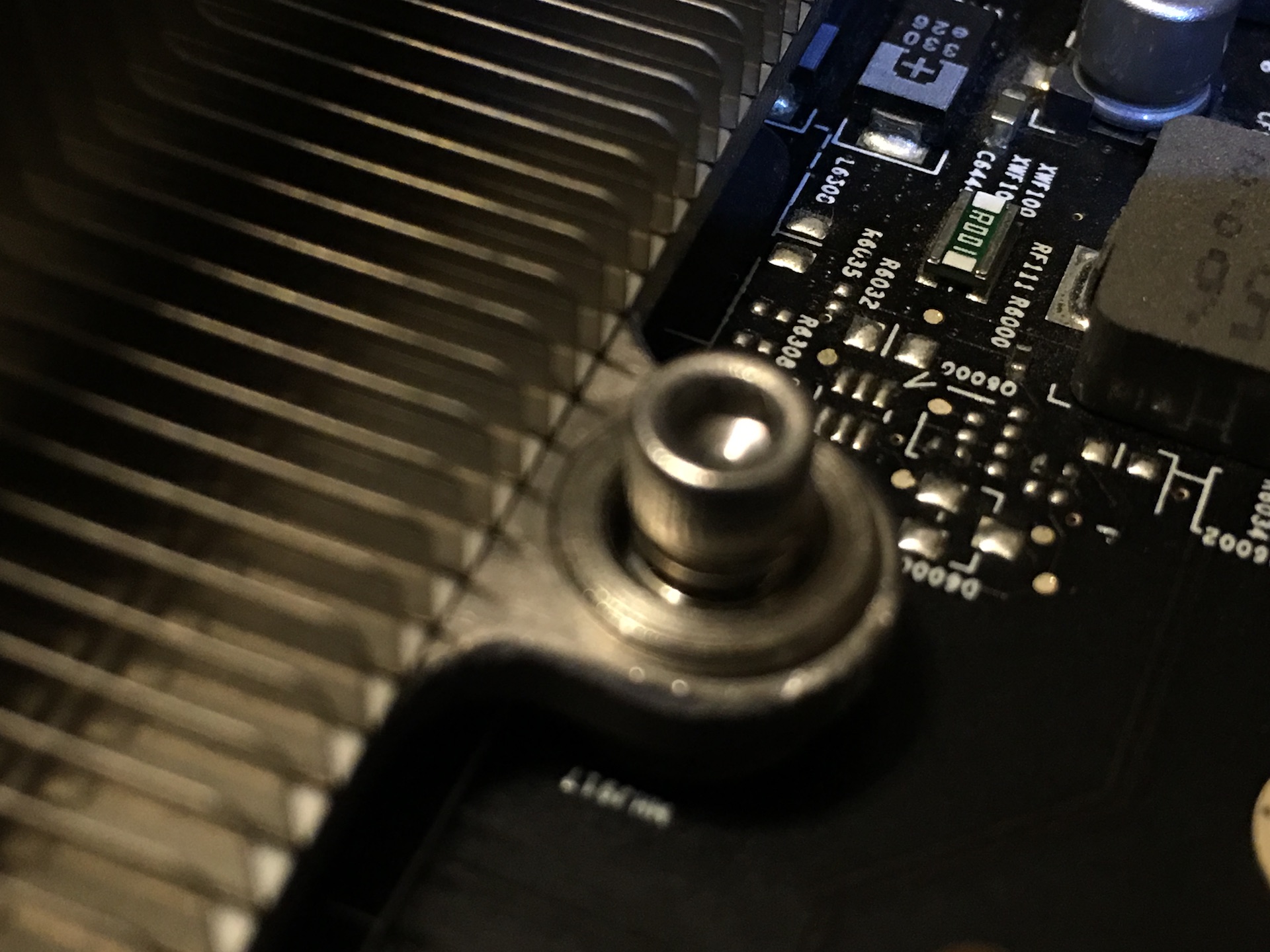

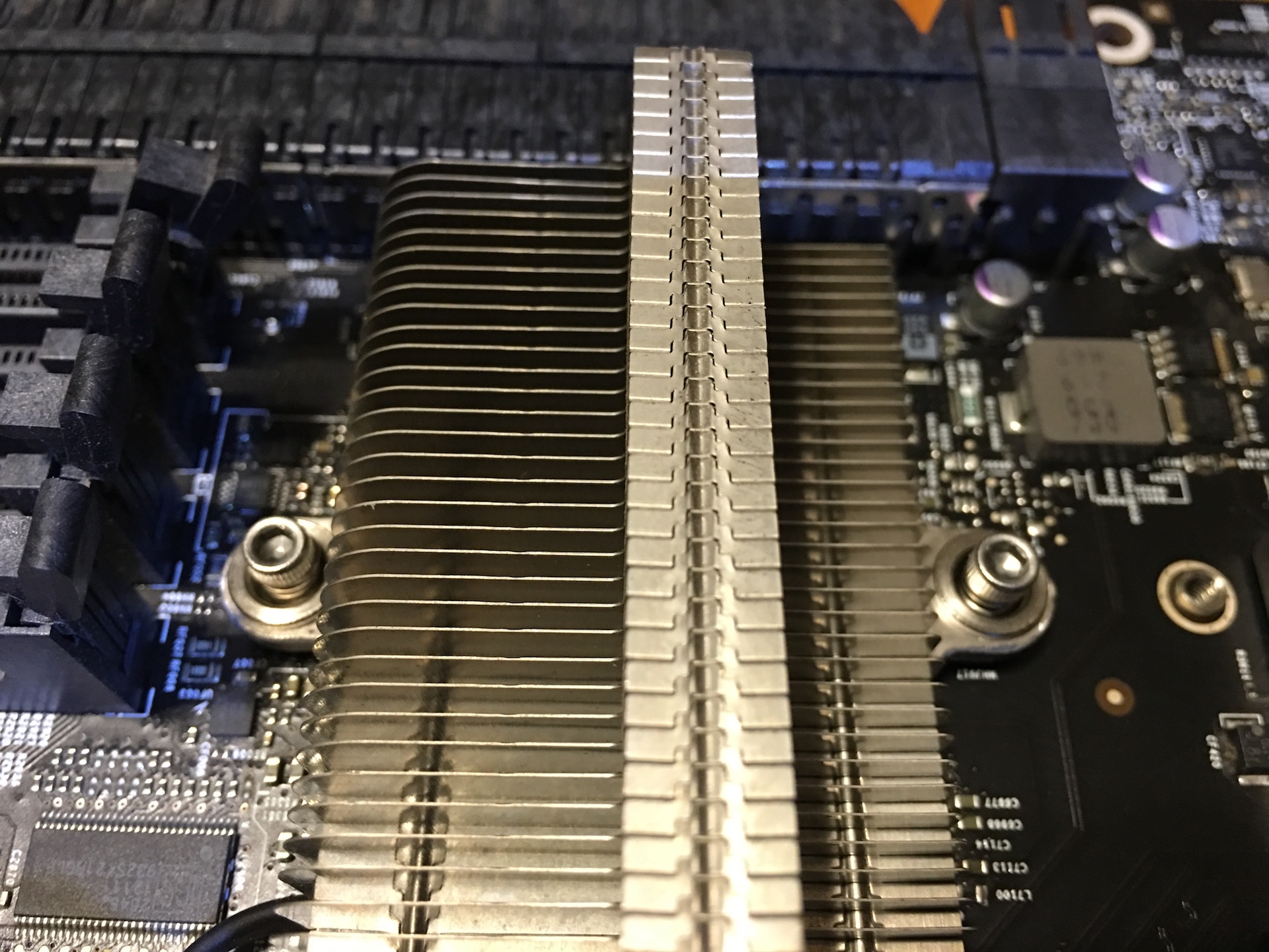

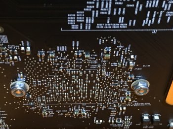

After reading this thread, I bacame worried about the snap rivets on my two 2009 and 2012 mac pro breaking...
At work, we had a customer bring in a 2009 single cpu, that had a dead cpu board, caused by a snap rivet breaking.
That made me paranoid, so I decided to fix it immediately.
I refuse to use the plastic rivets I got from china, I just dont trust them.
The plastic is flimsy, and the springs are about half as strong as the original Apple ones.
I went to the local ACE Hardware, and picked up a set of 6-32 stainless screws.
They were too big by a hair, dont use 6-32!
Then picked up a set of 4-40 stainless Allen cap screws, 1/2" long. These are a PERFECT fit.
Also got a set of "stop nuts" for them, these are the kind with the hard plastic ring embedded that keeps them from unscrewing.
I used the original Apple springs, which perfectly fit the 4-40 cap screws.
Tighten them down until you get about half a thread showing past the nut, almost nothing.
Remember when tightening the nuts to keep pressure on both screws! you dont want the thermal paste squeezed out one side because your pressing down the other side.
This will give about 2-3mm of up/down movement on the spring/screw, which is more than enough for heat expansion.
Problem solved, permanently.
Looks very nice, the only question I have - is it possible those metal screws could conduct heat out of the heatsink and into the PCB on the underside where the washer is, damaging the plastic?
There is no washer, the nuts are resting against the metal pads on the pcb.
I wouldnt worry about a warm spot there, the underside of the i/o hub would heat the pcb more than those two screws ever could.

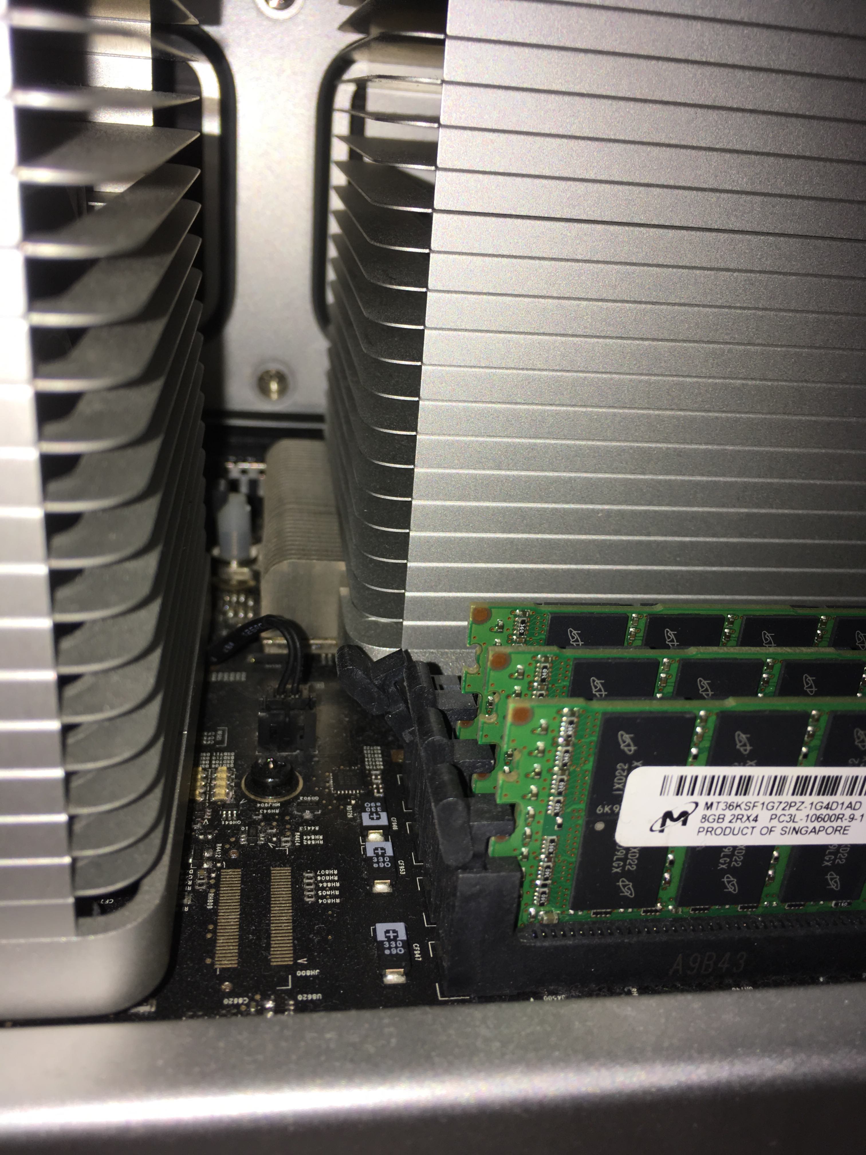

Thanks very much to everyone who posted information in this thread - it helped me survive my own "Northbridge moment" on my 4,1->5,1. I was just web browsing a few nights ago when I heard a loud pop/crack and the machine went dark except for a solid red light inside the case. I thought it was curtains and that I would probably need to start searching eBay for logic boards or power supplies.
HOWEVER, I soon found that the machine would power up just fine, so no issue with the power supply. The nVidia 980 was illuminated and its fans were running. Saw that the CPU-A red LED was illuminated on the logic board, and also down on the CPU tray just as others had experienced (mine is a single-CPU model with an X5690). Everything seemed to be in order except for the lack of a boot sequence. Hoped fervently that it was "just" the Northbridge rivet because I had laid up a bag of the Chinese ebay rivets and a spare tube of Arctic Silver 5 for this very eventuality after reading this thread about a year ago.
When I removed the CPU tray and tilted it to get a better look, pieces of plastic rivet fell out the bottom. Mystery solved. I ended up pulling the CPU heatsink and Northbridge heatsink, cleaned off all the old thermal paste on the heatsinks, CPU, and Northbridge chip, and reapplying fresh Arctic Silver 5. Popped down the Northbridge heatsink with the Chinese rivets (I replaced both rivets), new paste on CPU, reassembled the whole thing, and fired it up, hoping that the exploding rivet didn't do any collateral damage. And we are back up and running.
