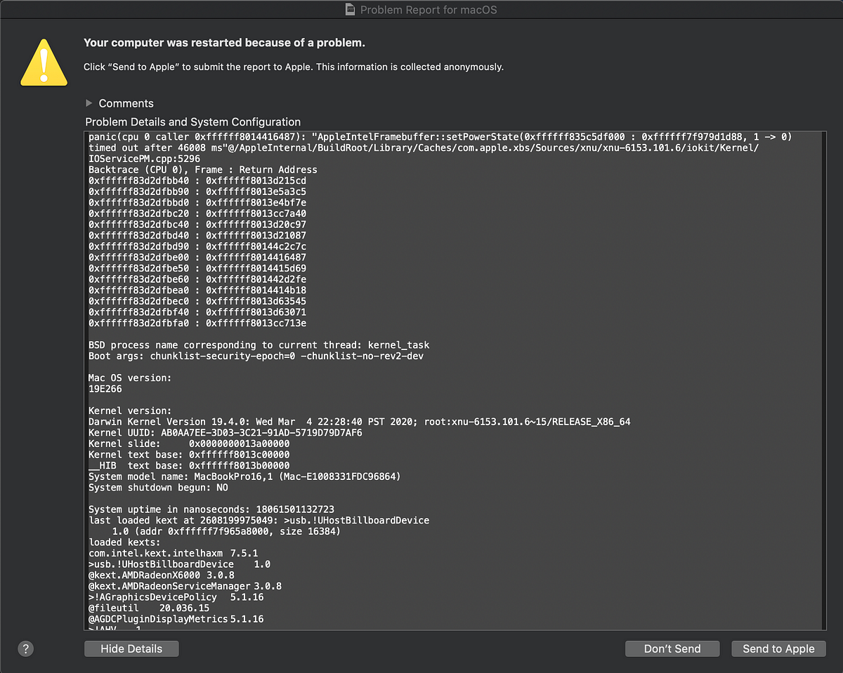

I am also seeing -20 as crash shutdown reason
Code:
2020-11-19 22:12:06.240157+0530 0xd0       Default     0x0                  0      0    kernel: (AppleSMC) Previous shutdown cause: -20
I can also confirm that I am also getting -20 as the shutdown reason.
This problem had gone away for me in 10.15.6+
Back with a vengeance in Big Sur (including the 11.1 beta).
I can resolve this issue by unplugging one of my two external monitors. (iMac Pro)
Have you tried the the SMC reset I suggested above?
Been having kernel panic crashing for a while now on my 2019 iMac but it seems to have gotten worse and sometimes happens multiple times a day. I updated to Big Sur yesterday hoping it would fix it but it happened again just 10 minutes after. I've attached my crash log and report to see if anyone can help with it being something specific. I don't use an external GPU but I do have 2 external displays connected over USB-C to HDMI.
Maybe you could try to remove one of those drivers at a time (if you don't need them) and see if it makes any difference:
com.Cycling74.driver.Soundflower 2
com.displaylink.DisplayLinkDriver 5.2.4 (82)
com.intel.driver.EnergyDriver 3.6.0
I would start with the DisplayLinkDriver.
Oh, I see now that you have an old version 5.2.4 of the DisplayLink driver. Maybe you could try to uninstall the one you have with the installer found in the 5.2.4 version under ”Legacy Releases” here:
After that install the ”DisplayLink Manager Graphics Connectivity” there at the top which says it is for Big Sur. Or maybe skip installing it at all if you don't need it. :)

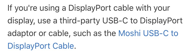

Absolutely! I'm wondering how far off a class action is.
What video card are you using? I have the Radeon Pro Vega 64 with 16gb of ram. Also using 2 x single thunderbolt to DisplayPort cables.
Also find it interesting that Apple no longer supports this cable on their site...

Same for me. I do nothing in particular. I went to bathroom and when I went back I found my Mac restarted...
panic(cpu 2 caller 0xffffff8006b53a13): userspace watchdog timeout: no successful checkins from com.apple.WindowServer in 120 seconds
service: com.apple.logd, total successful checkins since wake (2590 seconds ago): 260, last successful checkin: 0 seconds ago
service: com.apple.WindowServer, total successful checkins since wake (2590 seconds ago): 248, last successful checkin: 120 seconds ago
service: com.apple.remoted, total successful checkins since wake (2590 seconds ago): 260, last successful checkin: 0 seconds ago
Backtrace (CPU 2), Frame : Return Address
0xffffffb0a5773670 : 0xffffff80038bc66d
0xffffffb0a57736c0 : 0xffffff80039ff073
0xffffffb0a5773700 : 0xffffff80039ef6aa
0xffffffb0a5773750 : 0xffffff8003861a2f
0xffffffb0a5773770 : 0xffffff80038bbf0d
0xffffffb0a5773890 : 0xffffff80038bc1f8
0xffffffb0a5773900 : 0xffffff80040bee84
0xffffffb0a5773970 : 0xffffff8006b53a13
0xffffffb0a5773980 : 0xffffff8006b536ba
0xffffffb0a57739a0 : 0xffffff80040460ee
0xffffffb0a57739f0 : 0xffffff8006b52b0a
0xffffffb0a5773b20 : 0xffffff80040502bb
0xffffffb0a5773c80 : 0xffffff80039aaa61
0xffffffb0a5773d90 : 0xffffff80038c1d77
0xffffffb0a5773e00 : 0xffffff80038985d5
0xffffffb0a5773e60 : 0xffffff80038afb82
0xffffffb0a5773ef0 : 0xffffff80039d3823
0xffffffb0a5773fa0 : 0xffffff8003862216
Kernel Extensions in backtrace:
com.apple.driver.watchdog(1.0)[7948A279-A8B8-3650-AFBF-B1E3EB68942A]@0xffffff8006b52000->0xffffff8006b53fff
Process name corresponding to current thread: watchdogd
Boot args: chunklist-security-epoch=0 -chunklist-no-rev2-dev
Mac OS version:
20B50
Kernel version:
Darwin Kernel Version 20.1.0: Sat Oct 31 00:07:11 PDT 2020; root:xnu-7195.50.7~2/RELEASE_X86_64
Kernel UUID: 84C6DC45-6B02-335F-9439-5D2A9BC385A4
KernelCache slide: 0x0000000003600000
KernelCache base: 0xffffff8003800000
Kernel slide: 0x0000000003610000
Kernel text base: 0xffffff8003810000
__HIB text base: 0xffffff8003700000
System model name: MacBookPro16,2 (Mac-5F9802EFE386AA28)
System shutdown begun: NO
Hibernation exit count: 0
System uptime in nanoseconds: 31481167029169
Last Sleep: absolute base_tsc base_nano
Uptime : 0x00001ca1c7c73411
Sleep : 0x00001a46780fb591 0x0000962504bbfebd 0x000018e1bae90d5f
Wake : 0x00001a467ce7f38e 0x00009a93e63b790f 0x00001a467b6da330
last started kext at 29796798380665: >!AXsanScheme 3 (addr 0xffffff8005061000, size 12288)
last stopped kext at 29955840430525: >usb.!UUserHCI 1 (addr 0xffffff7fa33ef000, size 98304)
loaded kexts:

Is that on the Big Sur 11.1 beta?
Edit:
Aha, it's the newer 20B50 build of Big Sur 11.0.1. I passed on the log to Apple in my old, still open ”watchdog timoute” report. Not sure if it's of any value to them.
star-affinity
macrumors 68000
Nov 14, 2007
1,996
1,333
Big Sur 11.0.1. I will try to reproduce....
The best thing is if you can generate a ”sysdiagnose” in close proximity of the Kernel Panic. More info here (still valid for newer macOS releases):
It's great if you can estimate the time of the Kernal Panic occurrence too – will be easier for engineers to find a possible cause in the logs then.
I can then attach that to my bug report with Apple, if it's okay with you. If you can think of a good way to share the file – it tends to be a few hundred MB in size. :)
If you want to share the ”sysdiagnose” with Apple yourself there's more instructions here (requires login with Apple-ID):

Okay, damn. I got my first Kernel Panic since Big Sur now – sudden restart when opening a link in a new window in Firefox. But no mention of ”watchdog timeout” like I used to get.
Instead talks about ”panic(cpu 7 caller” and ”kernel trap” and ”Fault CR2”.
Strange – it has been super stable for almost two weeks of usage, and wake/sleep several times,
Oh, well… ?
