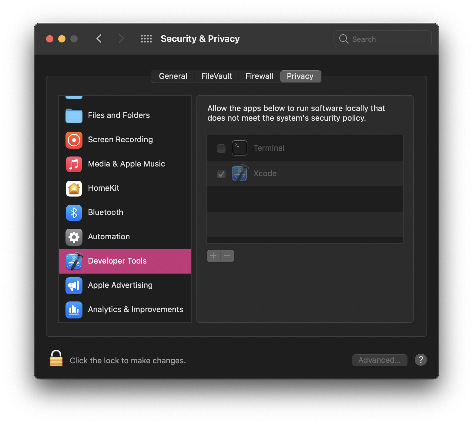

I think you've fixed my problem, I removed references to terminal from Security & Privacy in system prefs from developer tools tab & others (belt & braces and all that) and my ~2015 MBP Big Sur hasn't crashed since. Before this, I couldn't use my Mac unplugged from power, or without an external monitor (weirdly it was stable if connected to external screen). Without power & external monitor I was stuck in an endless panic loop, had major display & performance issues. I almost bought a new MacBook thinking this was the end for this machine.
Also another point, even if Terminal/iTerm does not have the checkbox next to it checked, remove it anyway.
To reiterate & expand johnalan's fix:
- Boot into safe mode (Hold shift at power on) if you are in a panic loop
- System preferences -> Security & Privacy
- Remove terminal from Developer Tools section (I also removed it from accessibility & other areas)
- Power off
- Power on
Computer hasn't crashed since, been around 24 hours now, able to use it without external monitor and power supply. Previously without external monitor & power my laptop was useless. I now have my laptop back.
- Power off
- Power on
