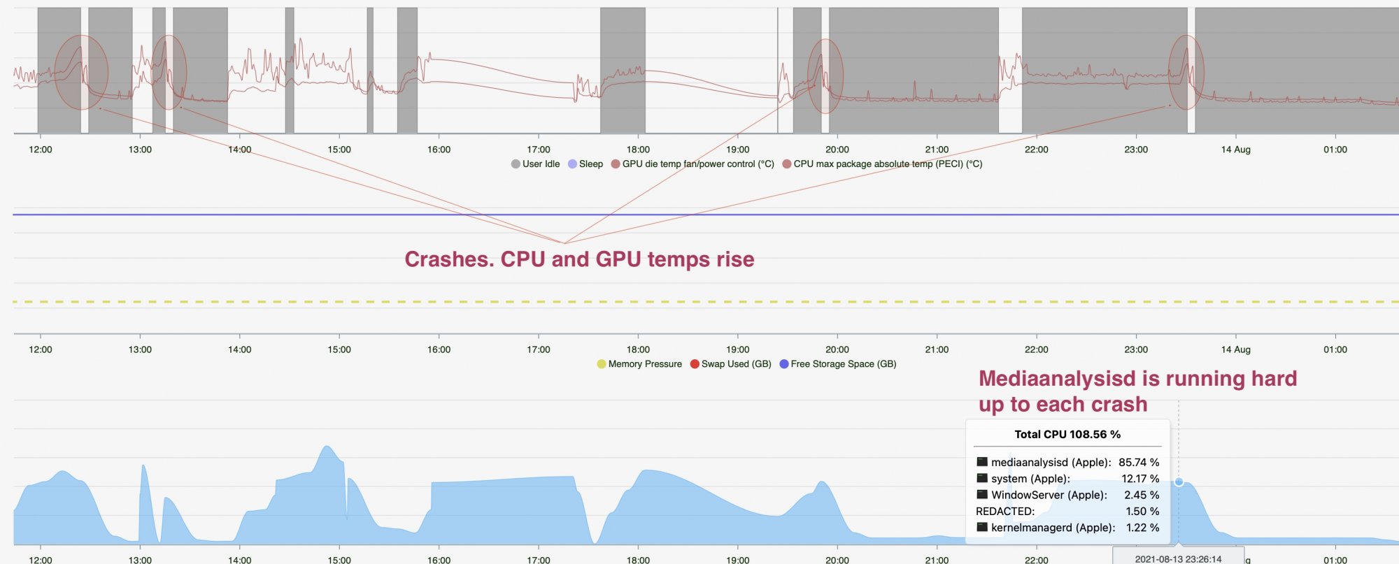

cjmildenberg, thanks for your post.

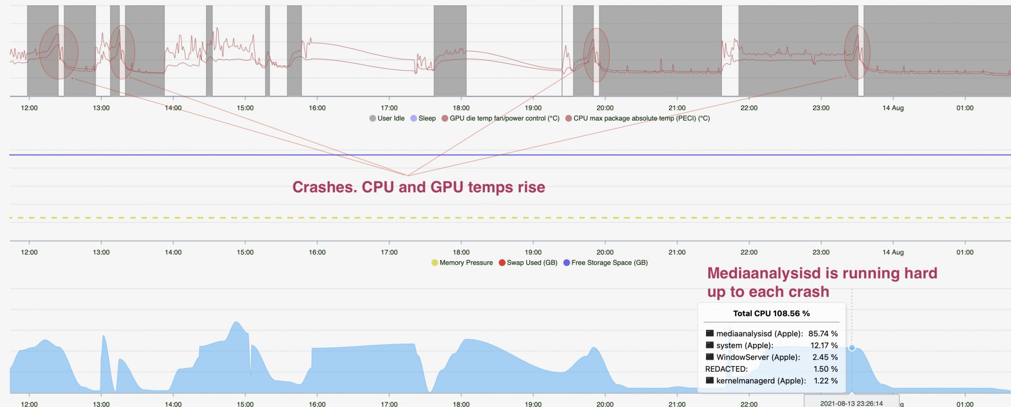

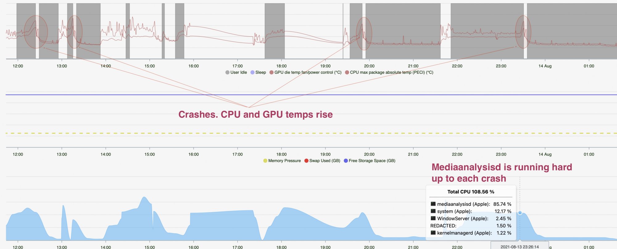

Here is a little bit more corroborative data pointing to mediaanalysisd.
Using EtreCheck's Analytics graph, I found that the CPU and GPU temps rise sharply coming into the time of the crash - top graph. (times taken from WindowServer spin reports in Console.app) It looks like something is "running away".
Every time of a crash, the mediaanalysis program was consuming a fairly large amount of resources - bottom graph.
In the chart below, the grey bars represent "User Idle" status. The white slip after each crash is the 5 minutes that the computer is not in "User Idle" state, because it has restarted. The other white spaces are where I was using the computer.
This is a frustrating crash to debug.. because mediaanalysisd doesn't always run (it depends on what work there is to do in photos.app media) and it doesn't always crash.. as cjmildenberg noted, it may depend on stumbling over a broken image file.

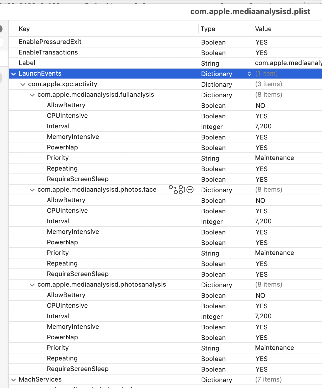

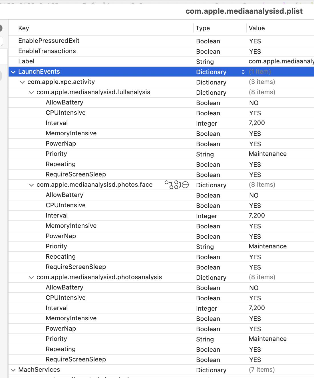

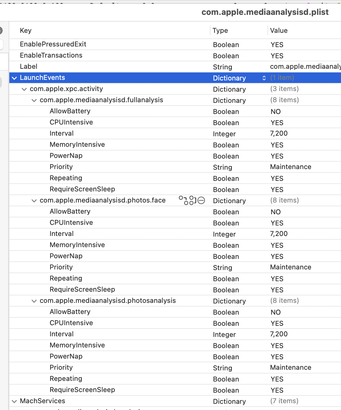

Looking at the parameters for the mediaanalysis.plist it shows that it should only run with "Requires Screen Sleep" -- which is an ambiguous term, since in System Preferences, you get options for computer to sleep, and the display to power off.
I suppose that you could toggle that to "No" and it would run without waiting for screen sleep to kick in, allowing one to use tools to monitor what is going on as it is happening.
Likewise, I hope this helps get this bug fixed some year.
These stats are incredible, and I'm certain we are on to the root issue many are having on this thread.
Thank you for doing this. It is 100% verifiable for me that if I disable mediaanalysisd that I get zero crashes.
