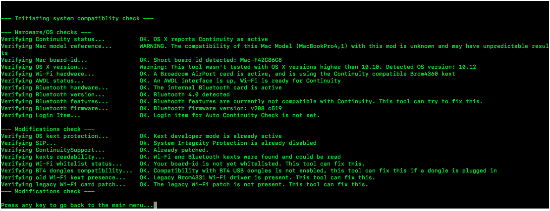

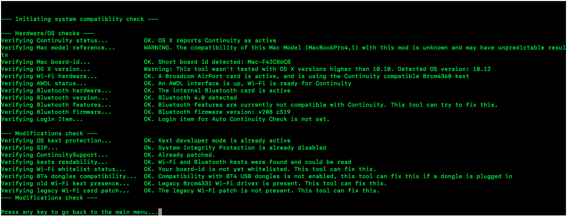

Mine "broke" the other day. Was working fine at night (and days before), the next morning, go to unlock, nope. And couldn't get it working again. Tried taking the BT and 80211 kexts back to Sierra vanilla, repatching. Removed all systems from iCloud, re-enrolled, nada. (but, pretty apparent from the logs that this bundle has a lot of iCloud issues).
MacBook Pro 17" 2008 (4,1), mCard 2.0 using BCM2046 for BLE, BCM4360 for 802.11AC.
CAT diags screen:
Errors related to unlocking attempts:
error 23:06:29.736053 -0400 kernel UserEventAgent is not entitled
error 23:06:29.941234 -0400 wirelessproxd Failed to start a scan - central is not powered on 2
error 23:06:30.083541 -0400 wirelessproxd Failed to start advertising - peripheral is not powered on 2
error 23:06:30.083626 -0400 wirelessproxd Advertising failed to start for client identityservicesd type 12 with error: CoreBluetooth is currently powered off
error 23:06:30.084778 -0400 identityservicesd Continuity advertising failed to start of type: 12 with error: CoreBluetooth is currently powered off
error 23:06:30.096375 -0400 sharingd Did fail to start advertising for Activity (The operation couldn’t be completed. (com.apple.identityservices.error error 200.))
Tried whitelisting my Board ID in the IO80211Family.kext's BCM PlugIn, but the system wouldn't take it.
Any thoughts?
CAT diags screen:
Any thoughts?

I went ahead and rebuilt my Mac Pro - realising since I've been doing upgrades since Mavericks I thought it would be best to do a proper clean build for Sierra (2nd time round).
After the clean build and CAT 2.4beta, continuity worked nicely, so my OS was probably to blame here.
I ran through your advice of a force CAT patch via terminal and now everything comes up as OK which is great. :)
Though Apple Watch auto-unlock still failed to unlock (even with the option selected) :(
