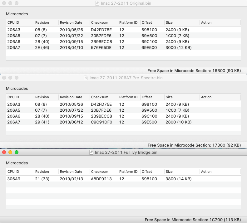

I had time to recover your firmware "MX25L6406E/MX25L6436E" (obviously I wouldn't use it for me...) I modified it with a 206A7 Pre-Spectre microcode and also with only one microcode but this time from Ivy Bridge.
I'll give you this in MP.

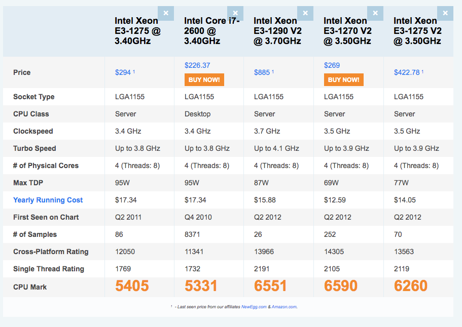

Before I order anything, can anyone confirm that the Xeon 1275 will work in the 27-inch 2011 iMac? Thanks!
Why you want to go this route? It breaks sleep and you get no real more power than with the i7-2600.
Does it break sleep? I've read a few places that said it only breaks sleep with the Xeons that don't have onboard graphics, but the 1275 has graphics so it should be OK. But that's one of the things I wanted to double check before ordering one.
The main reason for going this route is because the Xeon is half the price of the i7, and at least according to the CPUboss benchmark comparisons, you get even better performance at half the price, so it seems like a win win.

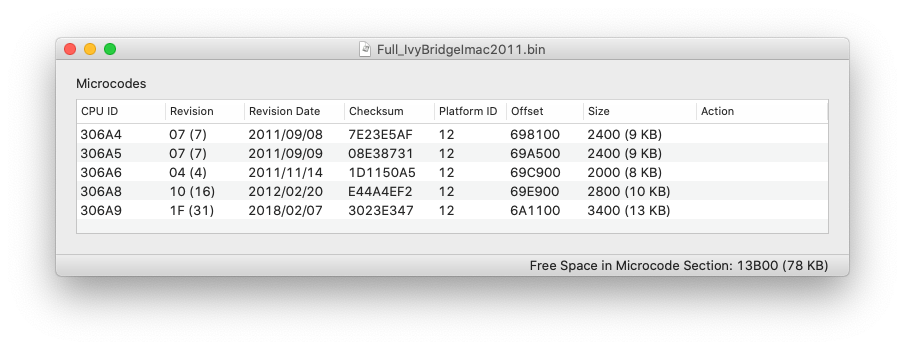

Edit: I have taken exactly the Microcode (x2 for us) part of the iMac 13,1
More than seeing the famous question of a BootCode to change, but which one?
I would add my questions on this same post, there I look a little bit at all the "differences".
For example I saw a AppleIvyBridgeGop, no equivalent.
