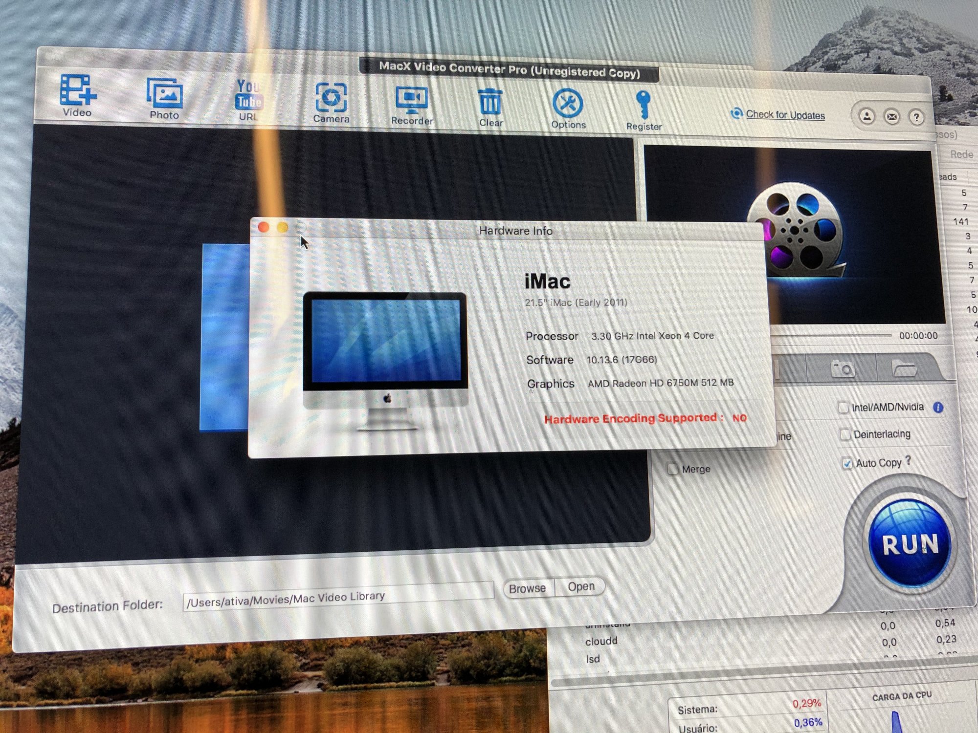

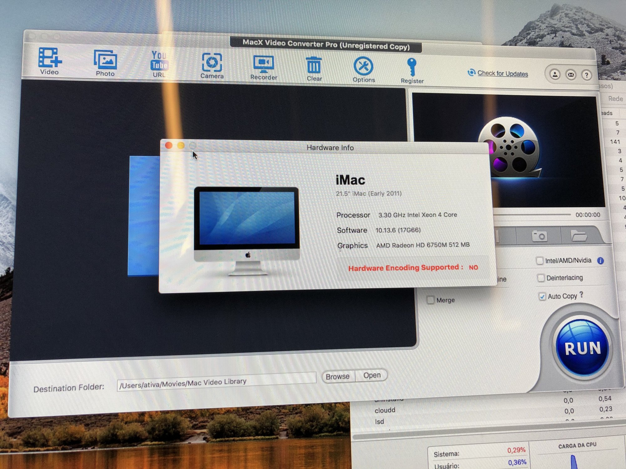

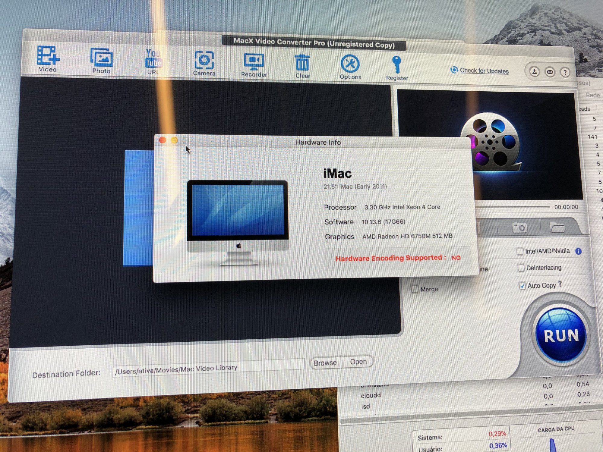

Ok, part I of the iMac 12,1 (21.5") upgrade completed.
Core i5 S2400S replaced with Xeon E3-1245v1, as per below picture.
Computer does not recover from Deep Sleep, as expected, even though processor has an integrated Intel GPU. Therefore, there is no reason to go with the E3-12x5 variants, as it consumes more power and gives no additional benefit.
Next we will try to replace the stock AMD Radeon HD 6750M GPU with the Nvidia Quadro K2100M.
By the way, since the iMac 12,1 power supply can only deliver 210W, I originally thought it would be possible to replace the 12,1 PSU with the 12,2 PSU, which is capable of 310W. Well, apart from the obvious different dimensions, which did not bother me even if I had to somehow mount it on the outside of the case, I learned that there is also a difference in the PSU DC connector. The 12,1 PSU DC connector has only 14 pins, while the 12,2 PSU connector has 16, so there is no guarantee that each pin position deliver the same expected volts. Because of that, I intend to try the Xeon E3-1245v1 AND the Nvidia Quadro K2100M with the stantard 12,1 PSU. I'm almost sure it won't work...
Will report back as soon as I successfully replace the GPU. Stay tuned...
