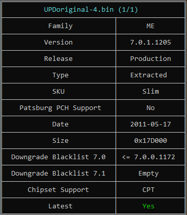

Bonjour,
After testing 4 different IMEs, the one for the iMac 2012, the last 8, the last 7 and the last 7 "SLIM", this one works, more than I have to test with my new graphics card to confirm (just tested the boot with the Linux flash drive).

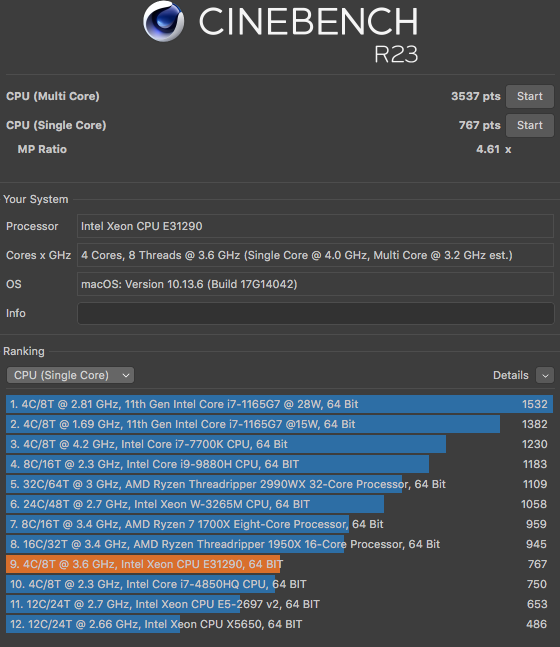

Hey all,
i upgrade my iMac 2011 to an Xeon E3-1290 3,6GHz, the fastest Sandybridge CPU. Its cool and running very stable. I can really recommend this all who wants to max this out. The iGPU of the Sandybridge is rarly used in the software so its not really used. The CPU get reconised as an i5.
Not sure about HS, but on Catalina with metal GPU k2100m, without patched sandy bridge kexts most video editing app would crash or render wrong and be painfully slow.
So sleep does not work, right? Anything else that does not work, apart from the wrong CPU detection?
Can you run Cinebench, see how that goes?
It was assumed that the sleep problem is related to the non-existing integrated GPU, which apparently is not as Xeons with iGPU also showed the sleep problem.
Edit: Other that that, the integrated GPU is not used at all anywhere within MacOS. So "rarely" is the wrong term. There isn't a requirement for integrated GPU on this iMac, it simply happened to be there in the Intel 2nd generation chips. Incorrect, see post 251.

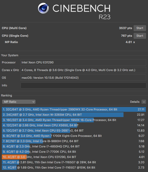

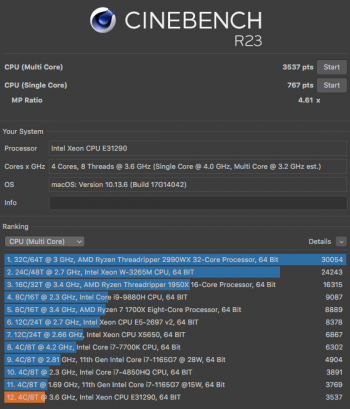

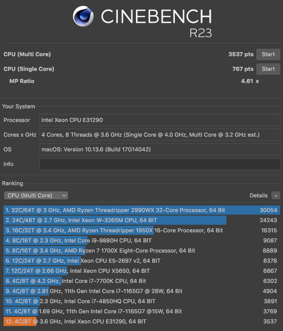

Ok was Running Cinebench. Hope this helps. Yes sleep is broken, but this issue i had too with the i7-2700k. But it was a bit strange with the 2700. The system felt a bit slower vs the i7-2600k to me. Anyway sleep isnt so important to me. The machine works fine. Would be glad to move to the i7-3770K if this would possible today.

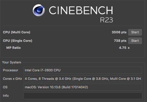

Thanks.
So the E3 1290 is slightly faster due to higher core clock, no surprises here. Here's the i7 again:

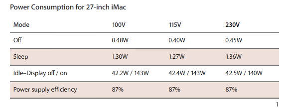

As they are close, both in price and performance, it probably depends on whether you value sleep. The power dissipation in non-sleep state (display off) is around 42W, whereas sleeping it is only 1.3W:
If it is in non-sleep (display off) for 24 hours, compared to 24 hours sleep, your power consumption will be approx. 1 kWh higher (per day). If you use it 8 hours a day and have 16 hours non-sleep, you use 240kWh more each year.
So make sure you switch it off after use, or you pay dearly for the (slightly) lower price of the Xeon.
