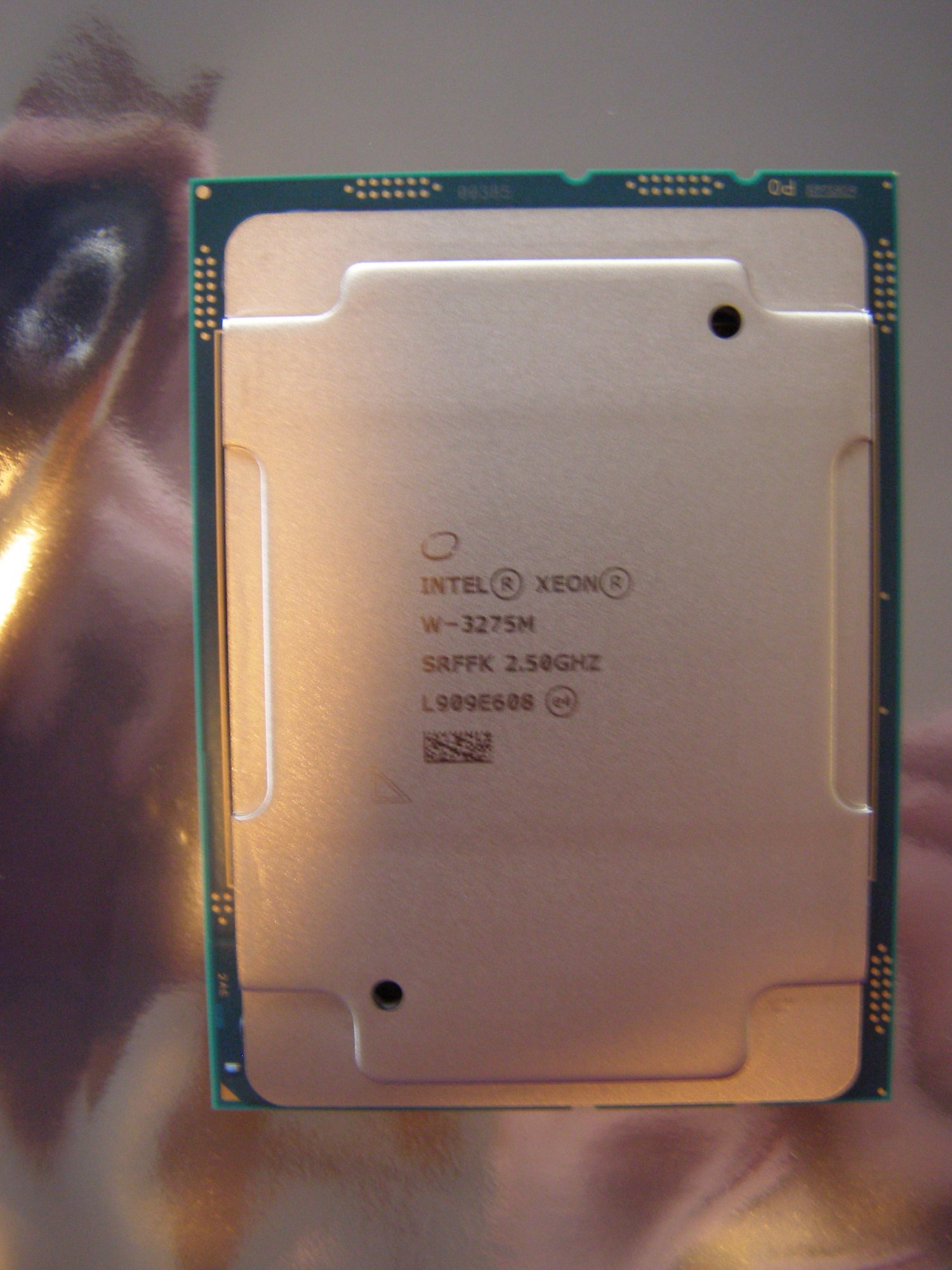

eBay from China . User zhpenn got his from taobao .
But there is a lot of risk in making a purchase like this :
The seller also sells ES / QS versions of this chip , so the buyer might wind up receiving something they didn't order and might not catch the mistake in time . So , at the very least , verify that the chip's serial number and other chip markings match via the method detailed in a previous post in this thread .
And while my seller appears honest , a dishonest seller could easily swap IHSs turning an ES / QS chip into a production chip , visually .
And , the seller categorically refused to send actual pictures of the item being purchased . A red flag .
And , if the processor doesn't work properly , sending the item back to China expedited and insured will be expensive from the American continent .
And Intel will not warranty this item , as it is a Tray version . So if it dies , you're out of luck . It's unlikely , but an expensive situation all the same . There's a reason why I burned my chip in for a week ...
And because this silicon is heavy and large , the buyer will have to carefully inspect the SMC and lands before installation . Its common to see damaged silicon offered for sale on eBay , being sold "as is " . So , use the posted pictures here of an undamaged chip when performing a visual inspection to verify all the tiny SMCs are still intact - it's easy for them to get knocked off . The lands ( the 3,647 little gold contacts on the reverse of the chip ) also can come loose , which would make the chip worthless until repaired .
And the chip needs to be cleaned properly , before installation . The installer needs to be immaculate about this .

Just to clarify, the 28 core cpu you purchased from the Chinese seller, was it made in Malaysia? Malaysian cpus works just as good as the Costa Rica CPUs? Unless I’m wrong, most of the sellers from China sell Malaysian cpu versions. Thanks
There are no country of origin markings on the chip I received , unless they are in some indecipherable code :

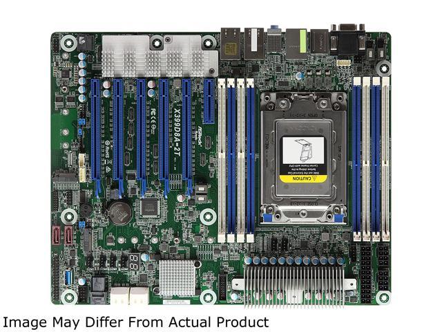

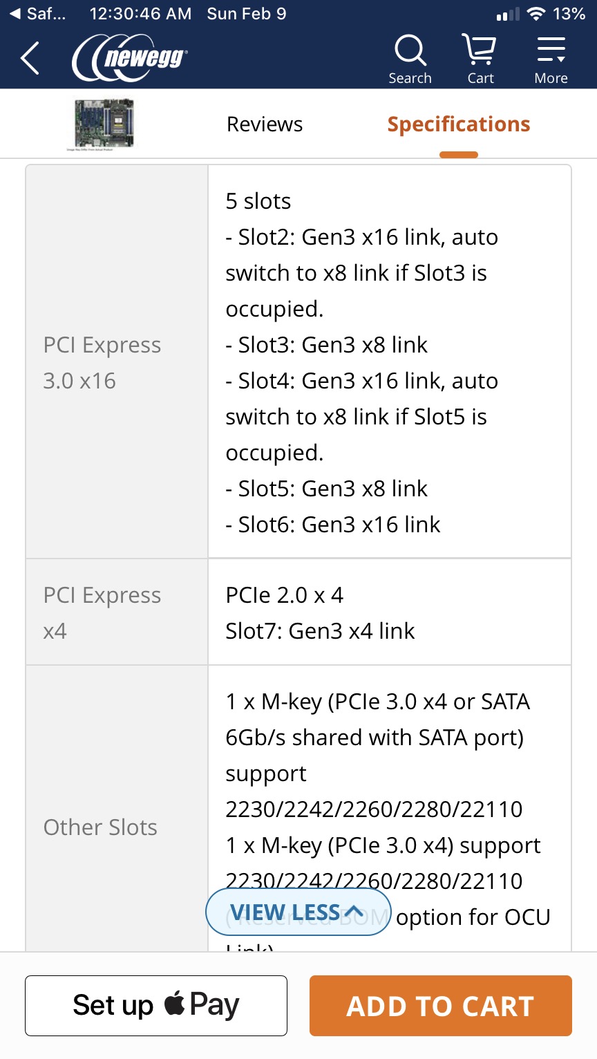

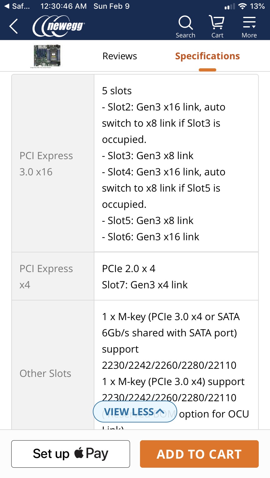

You're right . I actually just looked at NewEgg , SuperMicro and AsRock for an AMD board with more than four 8 or 16 lane PCIe Rev 3 Slots . I found just one and its slim pickin's at that ;
AsRock Rack X399D8A-2T ATX Server Motherboard AMD TR4 4094P AMD X399 Dual 10 GLAN
But the board does nothing to inspire me to get into threadripper with GPGPU . All the action is with Intel .
Since it’s still ATX the extra slots are a paradoxical trick. ‘Sure you can have an extra slot or two as long as you only use single-width cards. Oh you want a decent GPU too? Well then what you really need is one of these four-slot models.’
that board also has a complex list of variables as to how many lanes which slot gets when.

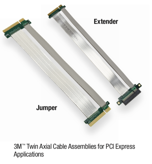

A clever Builder might find a way around that , to a degree . You'll need a big chassis , though .
Meet my friend : the magical shielded PCIe extension cable :
