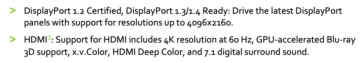

Based on the user guide, this card can only support DP 1.2 with max resolution of 4k (hres of 4096, a tad better than 4k).
But according to NVIDIA's specs page for the GTX 1060, the card does support DP 1.43 and resolutions up to 7680x4320 @ 60Hz. Looks like the user guide is out of date. It was probably never updated after the release of the card and seems to say that at release, DP 1.3/1.4 support was either present but not yet certified or would be add/certified sometime later.

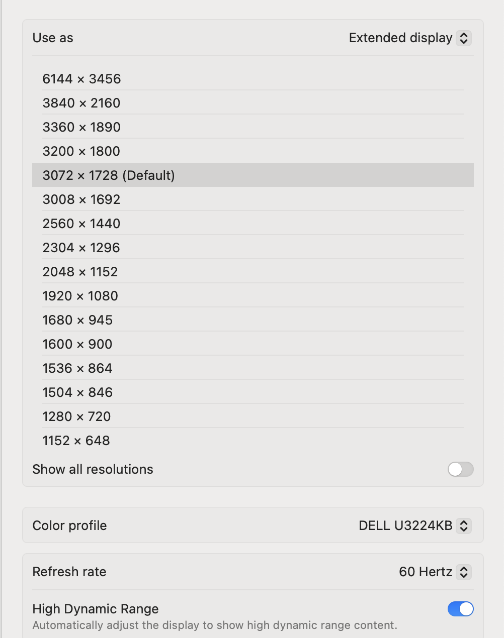

Hmm. So I'm on 14.6 and just double checked. I'm able to get HDR at 60Hz.
I should clarified that I meant over HDMI. HDR @ 60Hz used to work on 14.2 I think, but it hasn't since 14.4 (?). Anyway, I've updated my post above to be clearer and that I am again getting HDR on TB at 60Hz after doing your toggle trick on the Dell's OSD.
