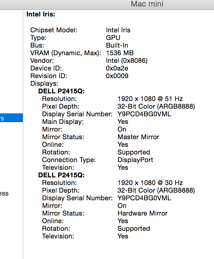

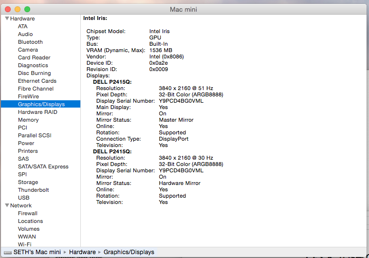

yea, it's strange. my mac mini seems to be working just fine with the dell 4k, so long as it's running two connections to the same monitor. the mini actually works best if it thinks it's driving (2) 4k displays... 1@30hz and 1@51hz... bizarre...
