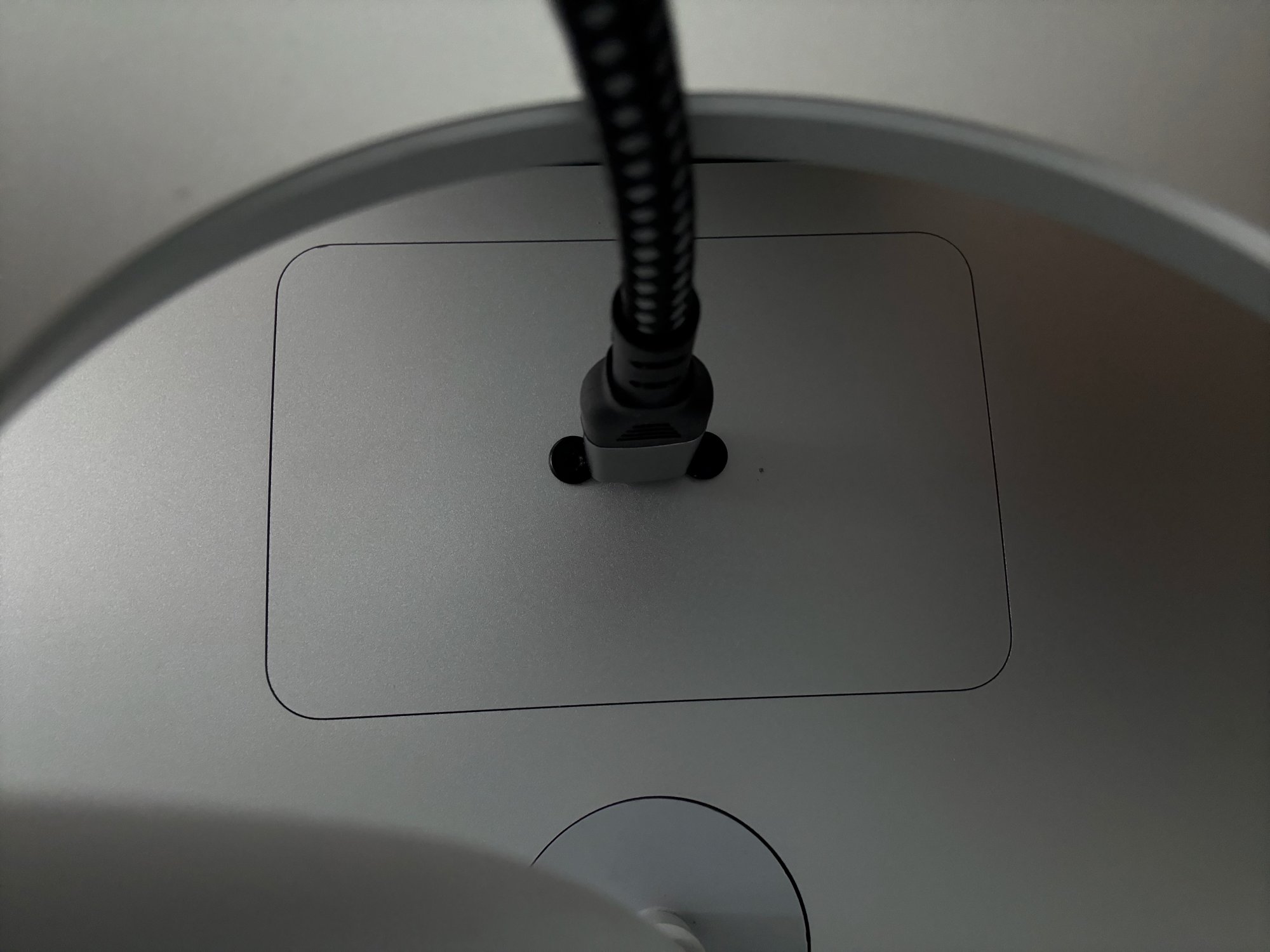

I pried out the stock power port on my 21.5". It was unnecessarily difficult as it's very securely adhered to the body, but it was doable with some patience and a metal spudger.
I used some white mesh cable tubing so the DP and power cables going in kinda just look like a really fat stock power cable.
Not perfect, but I like it. The only other options I've seen involve cutting up the fan grille, which I don't like at all.
