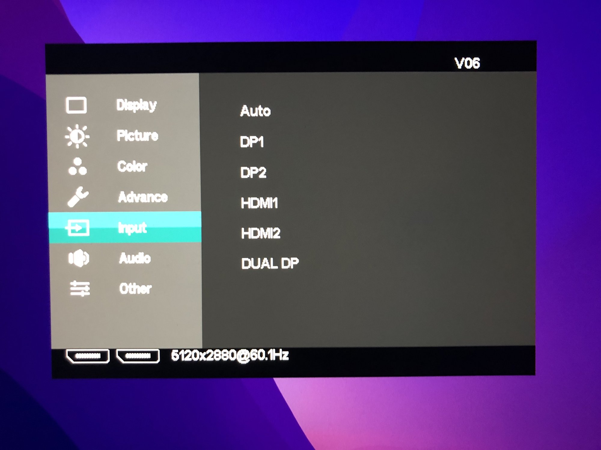

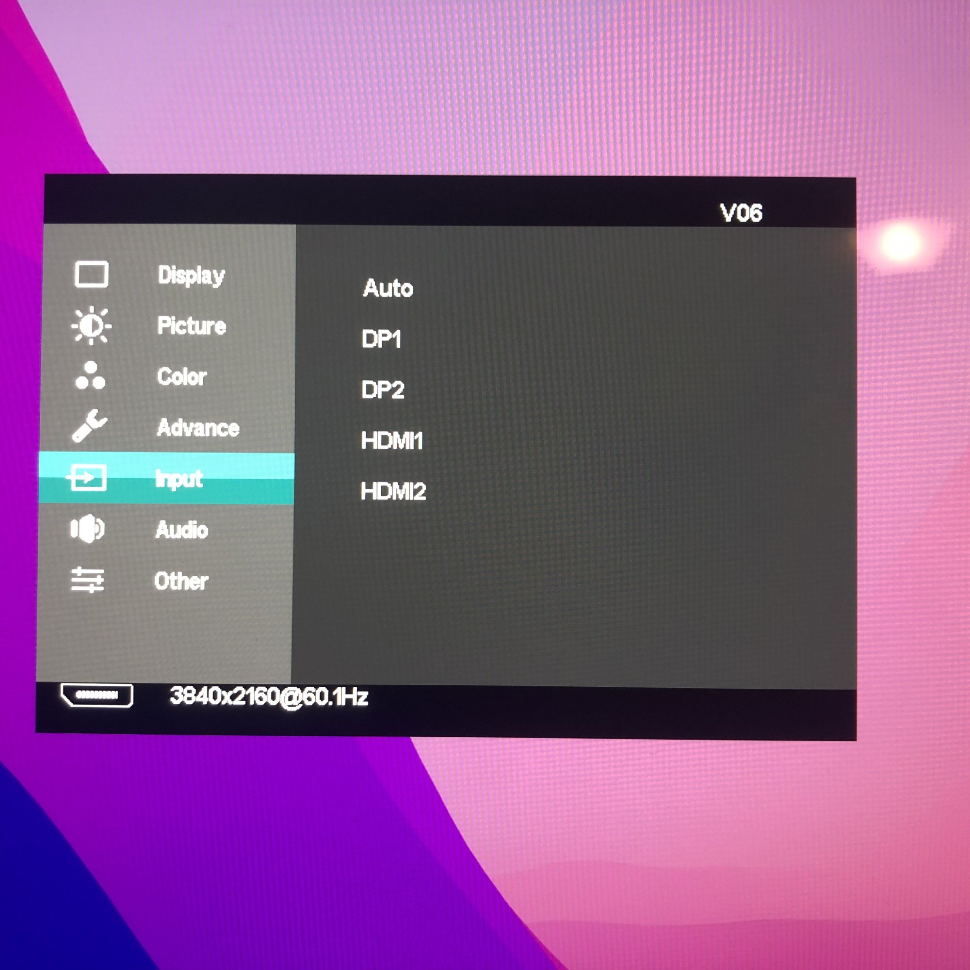

Received all the parts and assembled everything but... can't get the 5K resolution on the second display.
My iMac 27 5K 2017 sees two external displays with 1080 each instead of one with 5K.
I remember to have read somewhere that another user got to upgrade the firmware of the driver board in order to get the additional input option of DP1+DP2.
He received the file from the supplier of the driver board and had to use a Windows Pc connected with a DP cable in order to perform the upgrade.
Anyone can help me to find again these posts ?

if you're using the R9A18 board the firmware should already be in place. Select the input source that has 2DP as one input
The only input sources available are:
AUTO
DP1
DP2
HDMI 1
HDMI 2
That's strange, auto doesn't do anything either? If not I would message the seller and let them know you don't see the double DP to one input option. Page 2 here had some posts about upgrading firmware etc but it was for the newer version of the board.

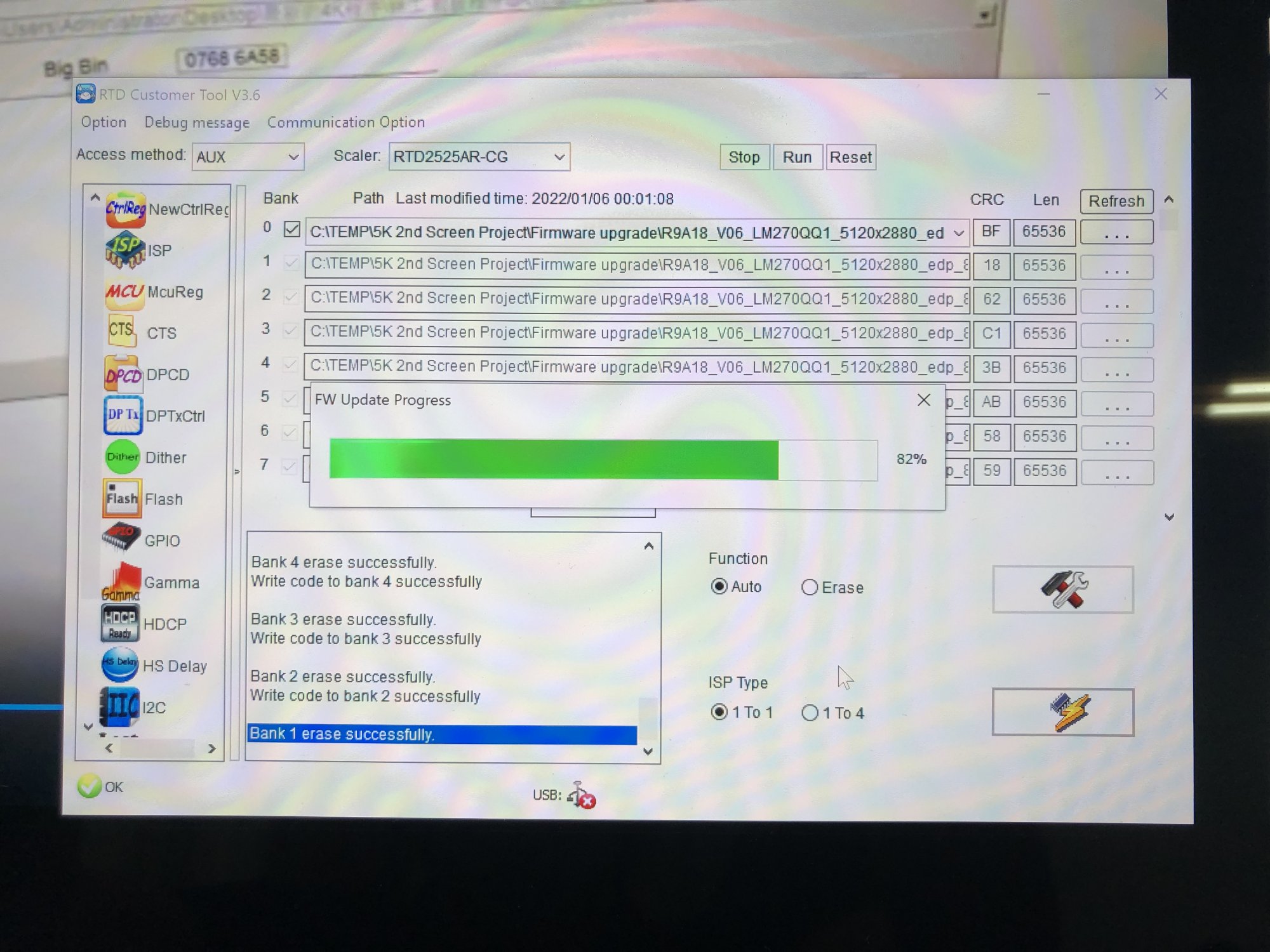

The supplier emailed me the files and instructions to perform the firmware upgrade in order to add the 2DP option to the list of inputs. It will be performed using a Windows Pc via one DP cable connected to the driver board.
Wish me luck ! Will keep you posted.

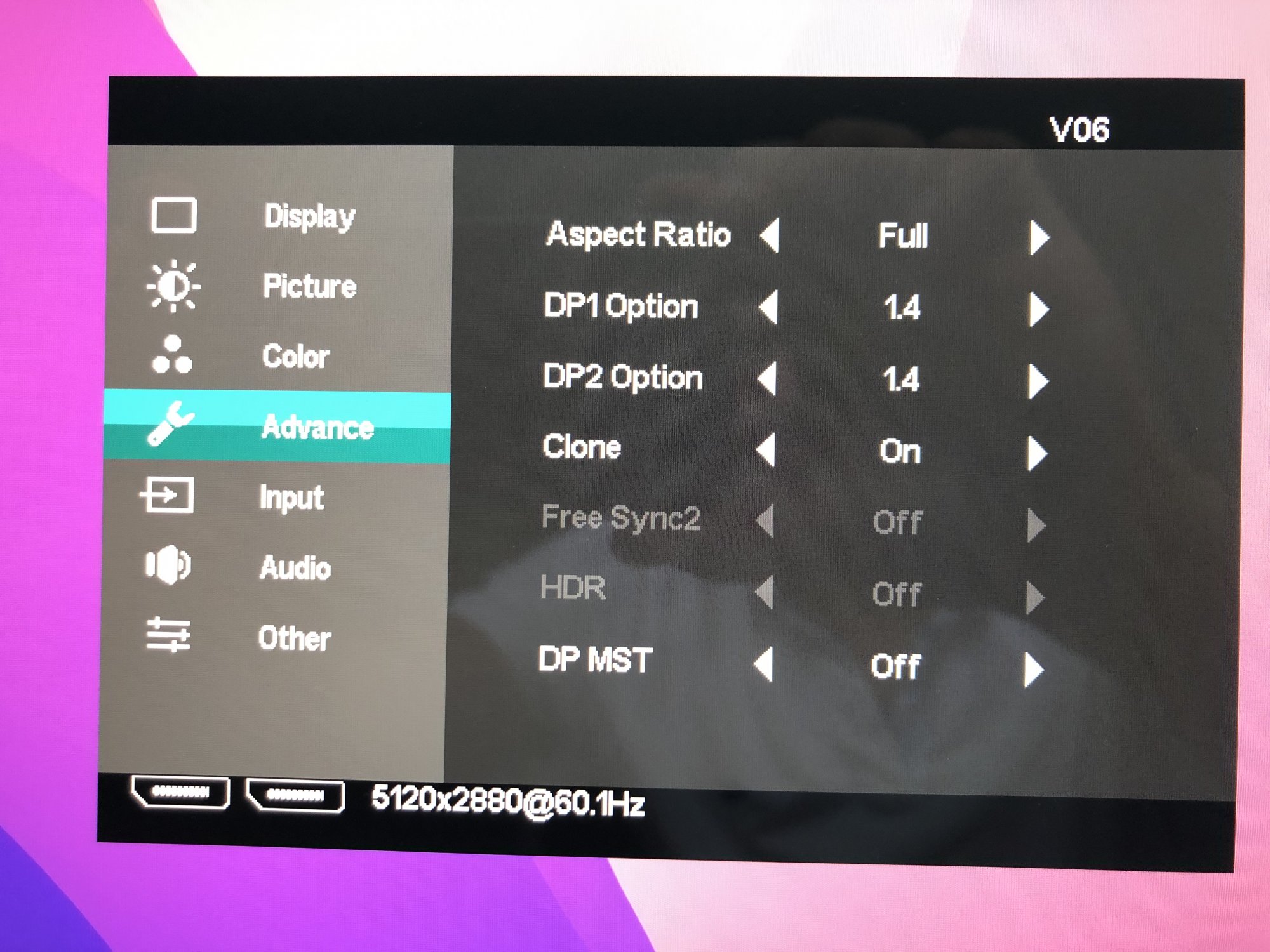

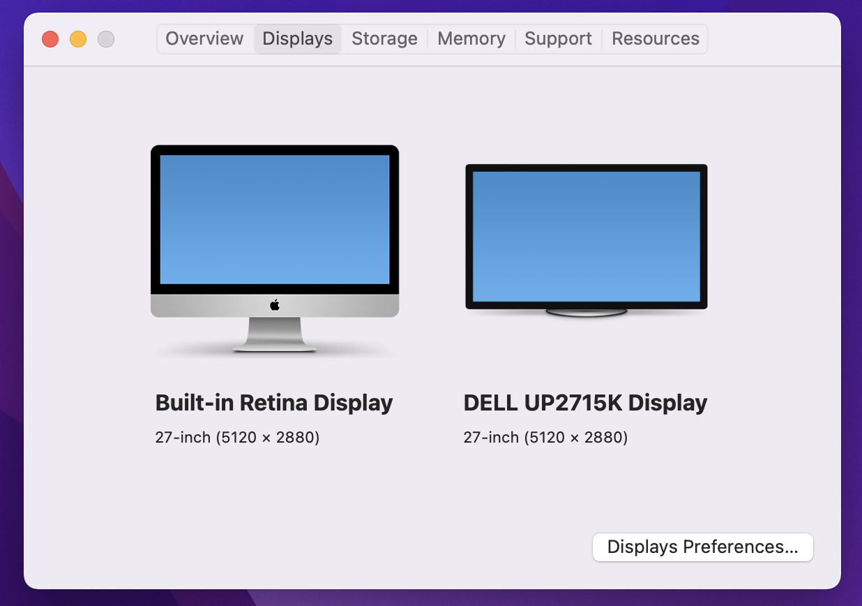

Success !!! I was able to upgrade the firmware of the driver board. Now the DUAL DP input option is finally present and was able to get the full 5K resolution on the second monitor. The crack on the second screen is basically invisible so even more happy with the budget of this project. Thanks to everyone for the good advices and info! P.S. After firmware upgrade, my iMac sees the second screen as a Dell UP2715K.

Can you supply a AGDCDiagnose output? That RTD Customer Tool seems really interesting. Is there a download link?
Can you guide me to create the AGDCDiagnose output ? I can send you the RTD Customer Tool via PM if you want.

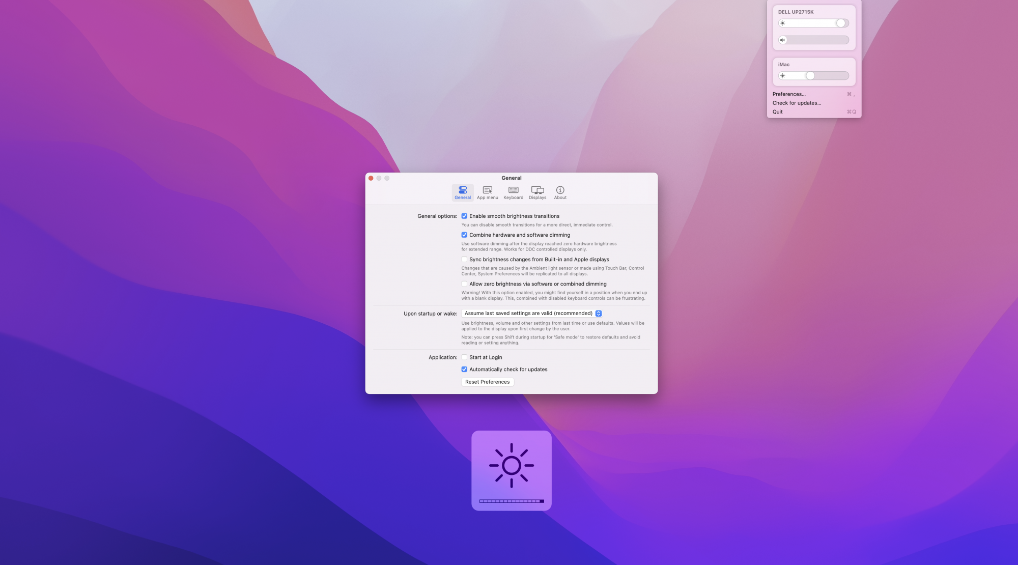

I am also able to control the brightness of the second screen via the app Monitor Control.
Just to be sure I have set the DP1 and DP2 option as 1.4
/System/Library/Extensions/AppleGraphicsControl.kext/Contents/MacOS/AGDCDiagnose -a > AGDCDiagnose_RTDdualDP.txt 2>&1
zip the result and attach. Please send a PM with the RTD tool.
