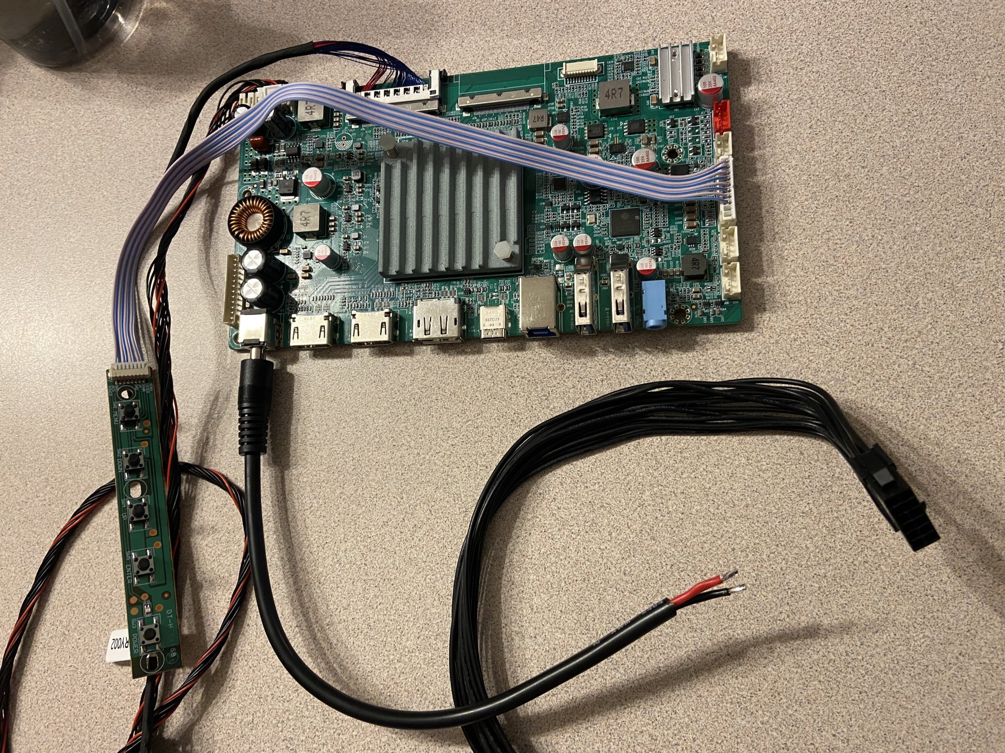

@traxap - I'm very interested in your method of connecting the PSU to the SA1. I am strongly considering the same thing once I get the components to do my conversion (also a 2017 iMac). Which male connector on the SA1 board are you connecting to and how are you adapting the PSU connector to it? Or are you soldering directly to the pins on the back of the board?
SubDriver - I will post pictures tomorrow. I will use the connectors shown in the picture below. Most likely splice and solder wires to the male power supply plug. I got the idea from post #1409. He did a nice job.

The SA1 board does not work well with the original iMac power supply. I suspect not enough power. It will turn on and the display works at 5K res., however, there is a high pitch noise cumming from the power board that I suspect is related to the 24v that the SA1 board requires, which the iMac power supply cannot deliver. Too bad!!! - I also tried an USB 3 4 port hub and the OS immediately disabled it due to "not enough power."
That’s too bad. Was really hoping it would work.
It is unlikely the iMac PSU isn’t powerful enough - pretty certain yours is 300W. Just not the right voltage.
I think that leaves you with 2 options… 1. Buying a 24Vdc power supply (either a laptop style power brick or a more formal internal power supply like the LRS-200-24).
2. Getting a 12Vdc to 24Vdc step up converter (probably need one rated for 10A/240W) and using the existing power supply. I am not certain if this method has been tried by anyone in this thread previously, but it should work since the output is exactly what the board needs.

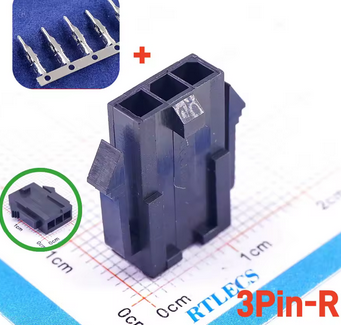

This approach requires tapping/connecting into the iMac's power connector for a better look and fit inside the unit. You will need a female 3 pin Micro-Fit 3.0mm connector.
Again thank you for all your suggestions.
Female 3 pin Micro-Fit 3.0mm connector
