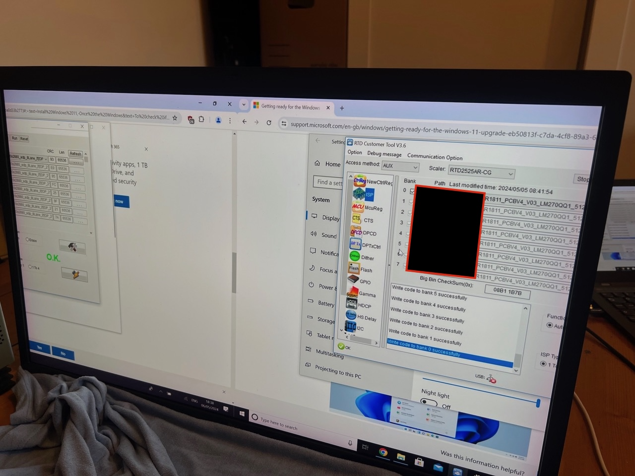

Hi everyone, I could use some assistance with an issue I’m encountering.
I ordered an R1811 for my LM270QQ2 panel, which comes from an LG Ultrafine 5K. It seems I might have received the wrong firmware—the device doesn’t boot at all with the ‘stock’ firmware. The seller provided “R1811_PCBV4_V03_LM270QQ1_5120x2880_edp_8Lane_双DP_210121.bin,” which improved things slightly. The screen now displays, but the left and right halves of the screen are flipped.
Does anyone have the correct firmware for the LM270QQ2 panel? Or any advice on how to resolve this issue? Thanks in advance for your help!

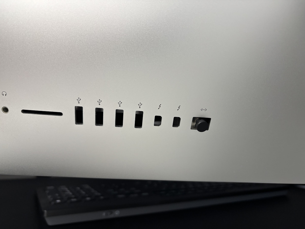

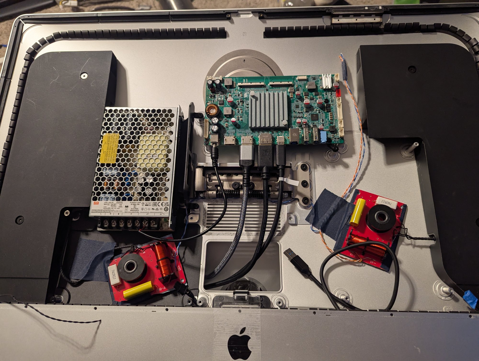

I also did this, I have the following things working:
- 5k 60hz 10bit (HDR) (Over usb C at least)
- Audio (with crossovers)
- USB 3 hub (At usb 3 speeds) (Similar to this: https://forums.macrumors.com/threads/diy-5k-monitor-success.2253100/post-32089129)
- 2.5GBE

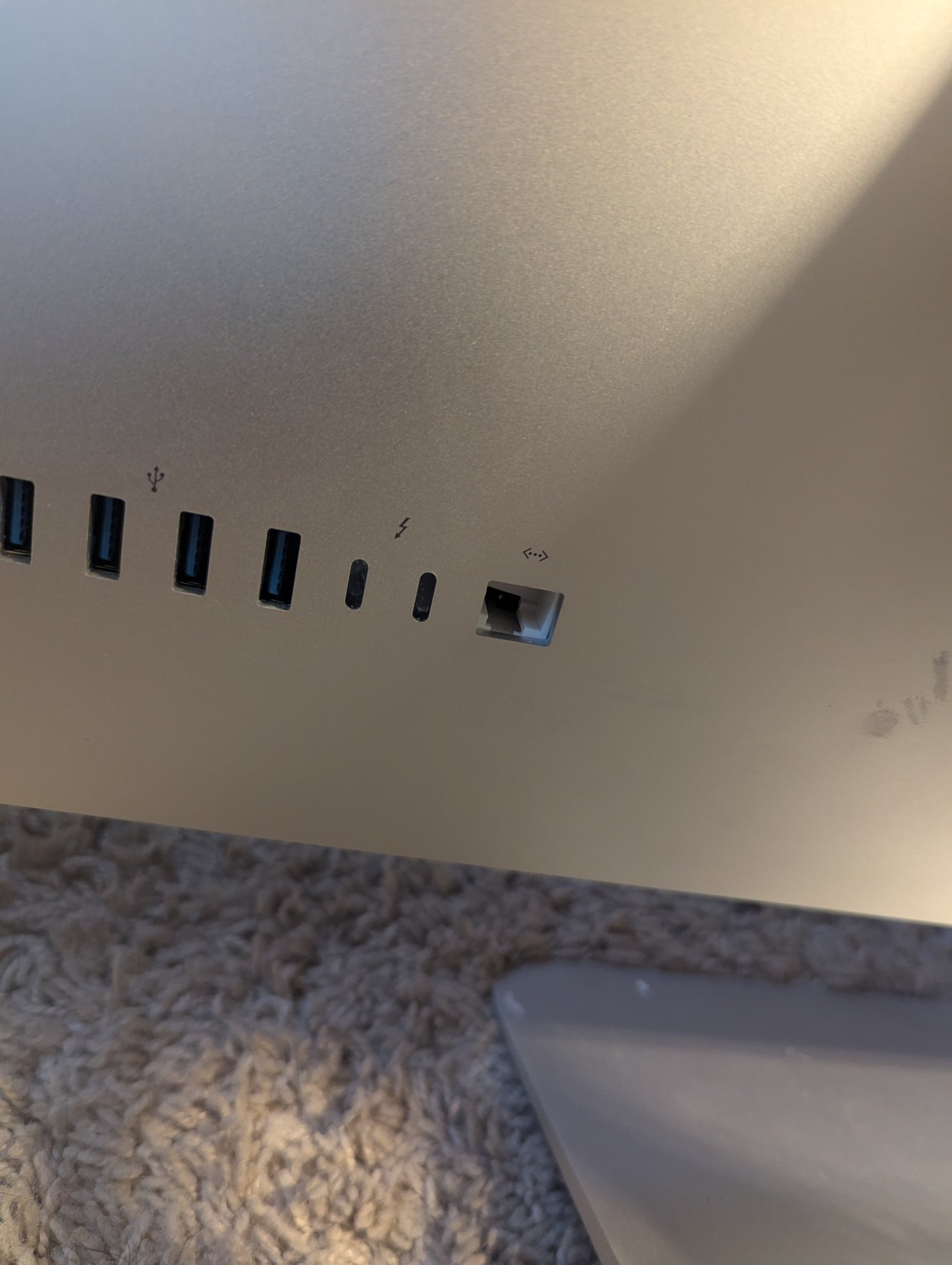

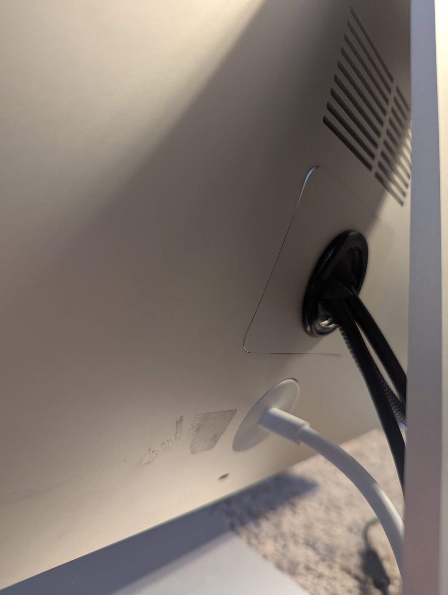

Admittedly my solution for mounting the control buttons is not ideal, but it works. I simply drilled holes above the right speaker and super glued it in place.
A similar situation for the ethernet jack, I had to remove the rear plastic ethernet housing to get it to fit.
The control board is plug and play, worked right away with my panel.
Parts List:
- 2017 5k iMac
- JRY-W9QUHD-SA1 (StoneTaskin)
- USB 3 Hub (Amazon)
- USB 3 to 2.5 GBE (Amazon)
- RJ45 Keystone (AliExpress)
- Mean Well PSU (Amazon)
- Molex 3 Pin for C14 AC (AliExpress) (Choose Male option)
- Ring Connectors for PSU (AliExpress)
- HDMI 2.1 Extension (Amazon)
- DP 1.4 Extension (Amazon)
- USB 4 Extension (Amazon)
- Rubber Grommet (AliExpress)
- Display Adhesive (Amazon)
- Audio Crossovers (Amazon)
- JST Connectors (Amazon)
3D designed parts:
PSU Mount
USB Hub Mount
Control Board Mount

Are the crossover units giving good audio from the speakers?
They look quite nice but the long inductor is iron-cored so too high value, so it might be not the best impedance?
Nice to see a JRY--SA1 build. :)
Are you using Better Display or Monitor Control for brightness/volume keyboard control?
Is that working as you would want?
I havent tried adjusting the brightness yet. The crossovers give *good* audio, but its not gonna stand up to a pair of DT770s. But overall, not bad audio. (I did goof when taking apart the screen as there is some slight discoloration in the top right due)

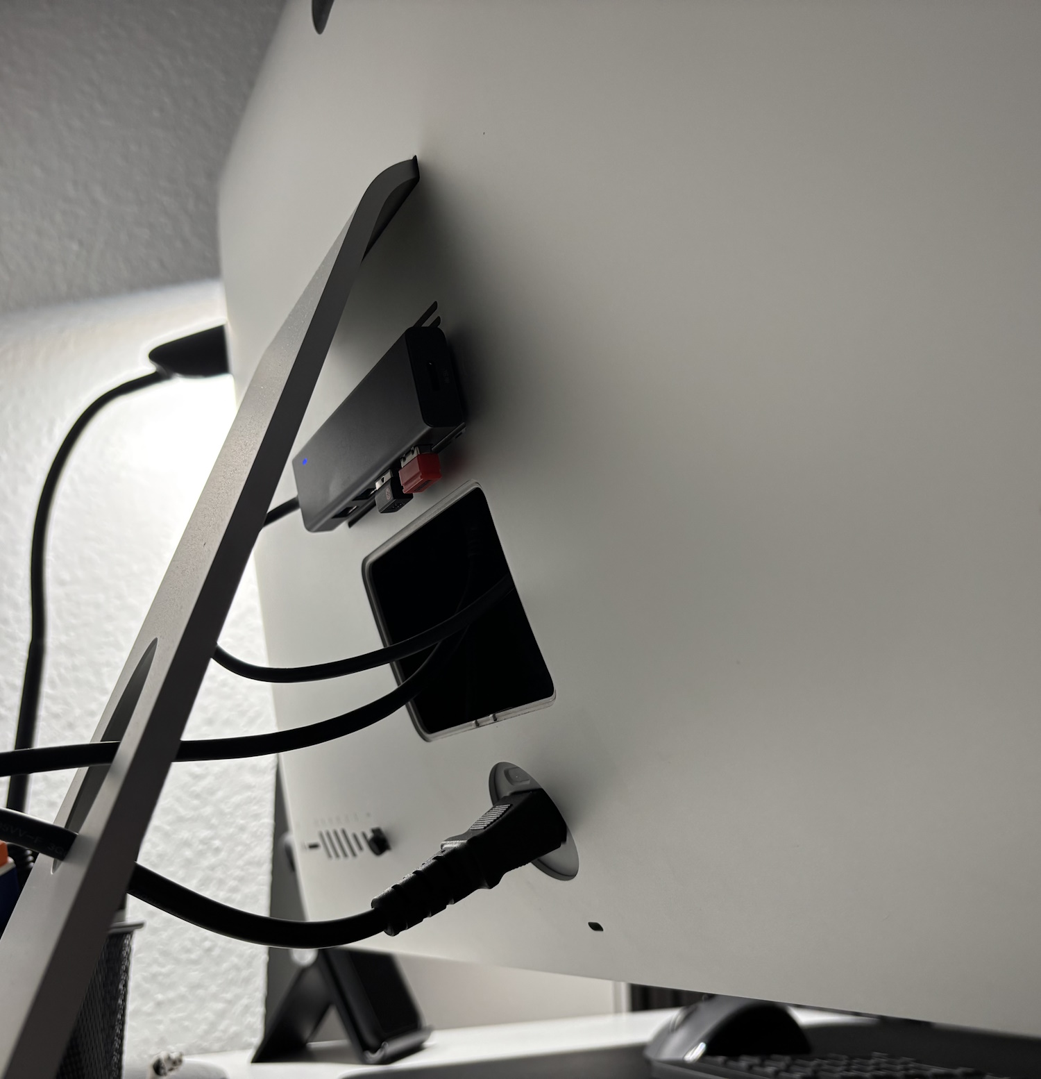

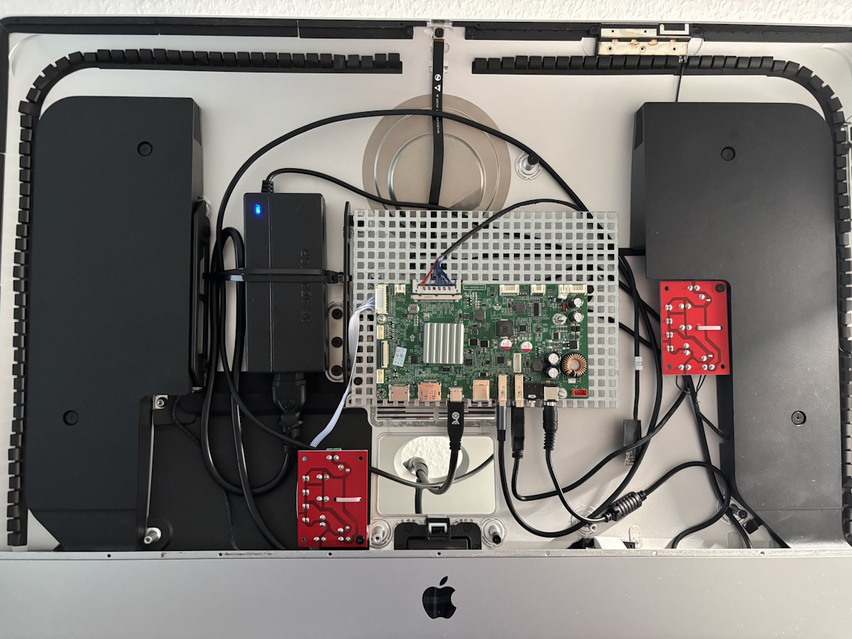

Hey everyone,
thank you for this enormous informative thread.
I just want to show you my setup, maybe it will help someone.
The display is connected to my MacMini M4 with USB-C / TB4 Cable or my work Lenovo Thinkpad T14 21AH00CXGE.
The Thinkpad (Intel UHD graphics) can do 5K but it works more fluently @ 4K
Charging the Laptop works very well.
Parts list:
  • iMac 27" 5K Late 2015 (LM270QQ1)
  • JRY-W9CUHD-AA1 (AliExpress, delivery to Germany <2 weeks)
  • Webcam: OV5693 5 MP/ IMX258 4K 12 MP HD USB-Kameramodul AF/FF 75 (Aliexpress)
  • PSU: 24V 5A (Amazon Germany)
  • Crossover Audiofilter (Amazon Germany, removed jumper B, good sound but i'm not audiophilic in any way)
  • USB HUB (Amazon Germany)

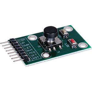

  • JoyIn 5-Way Switch as monitor control (DEBO SWITCH 5WS, Reichelt Germany)

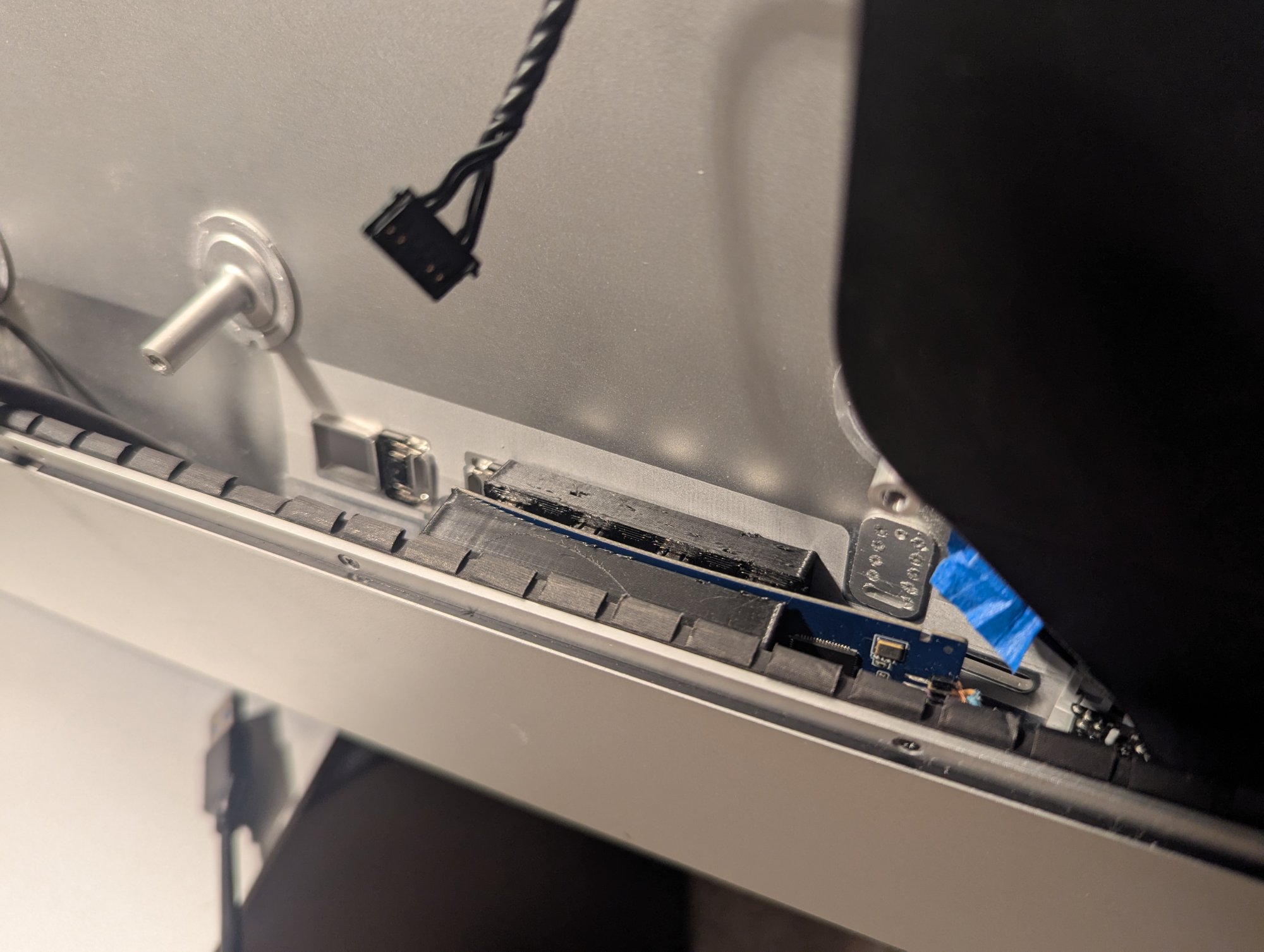

i used a standard metal plate from the hardwarestore to mount the board. For isolation i mounted little rubberfeet to the board.
I'm still waiting for the correct audio connector for the filters. But a test showed me the best results with removed jumper B.
As someone who only watches Youtube, the sound of my MacMini M4 was sufficient. Now with the iMac speakers I am really happy.
USB Hub for keyboard and mouse so I don't need a KVM Switch.
Here you see the 5 way rocker for display settings. Currently it is just held by foam parts. Right is menu, left is exit / source. Clicks very satisfying!
On / Off could also be realized with middle click but i wanted to preserve the original on / off switch.
Cheers
