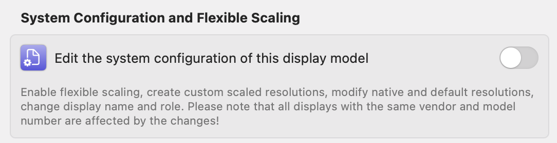

I tried to give this a go but HiDPI is won't stay blue when I pick 4K and 60hz. The display is forcibly refreshed back to a lower resolution when I try to enable HiDPI. Do I need to change my settings here:
And enable it for this to work?

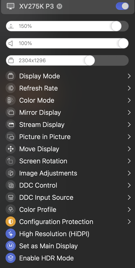

So, I'm looking to upgrade from M1 Max MacBook to M4 Max MacBook. One thing I noticed on my current MacBook since getting an external monitor is I can't do anything more than the following: 2304x1296 @ 120hz with HDR and HiDPI.
When trying to use BetterDisplay to increase the resolution, something has to be sacrificed, i.e HDR or refresh rate etc. My understanding is this has to do with the limitations of the thunderbolt port. I'm using direct USB-C to USB-C from MacBook to monitor.
Will my new M4 Max be able to do better than this? Could I get for example: 2304x1296 @ 144hz with HDR and HiDPI enabled all at once? Could I even accomplish that with an even higher resolution set?
Here is how my current config looks just to keep clarity:
Thanks.

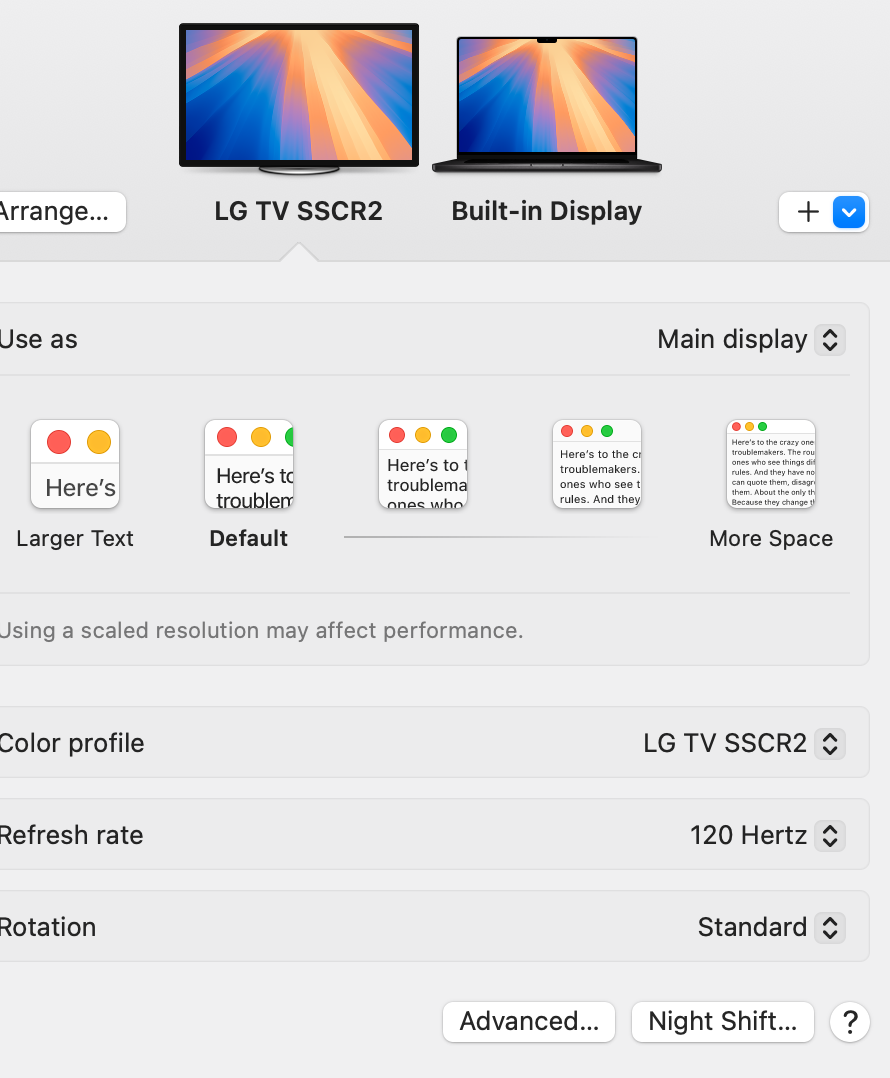

Hello, i am able to set 3840*2160 @ 120 Hz (HiDPI only) with LG C1 on Sequoia 15.2 on Mac Studio M1 MAX. After applying setting i see left right approx 1/4 of screen. Do you have any tips? Using middle model Ugreen HDMI 2.1 cable.

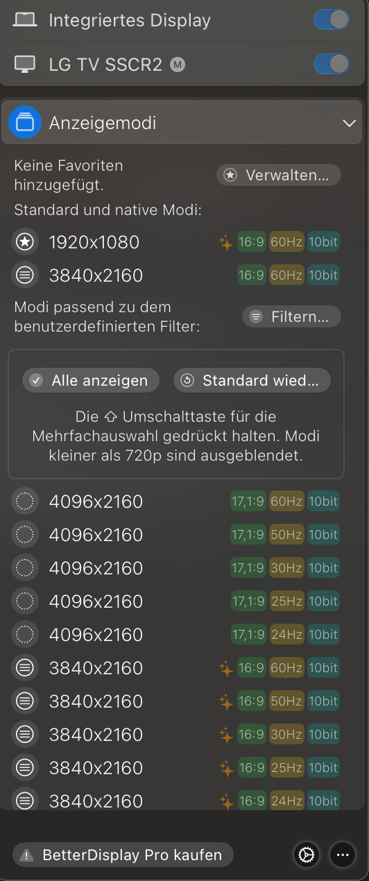

maybe someone can help me out.
Got this adapter yesterday https://www.amazon.de/dp/B08MSWMXT4?ref=ppx_yo2ov_dt_b_fed_asin_title
Flashed it with parallels and use it with this cable https://www.amazon.de/gp/product/B094Y2S538/ref=ppx_yo_dt_b_search_asin_title?ie=UTF8&th=1
with a Mac Book Pro M1 with 15.2 and an LG C2.
Tried with Better Display tool ( free version)
But get only 60 hz. In Better Display is no 120 hz shown.
Tried the whole day and night, gone thru the whole thread here, but no success.
Would be very thankful if someone have any idea.

When u flash the firmware attached in the OP u have to disable EDID override.
Another thing u have to be aware is this, with this workaround:

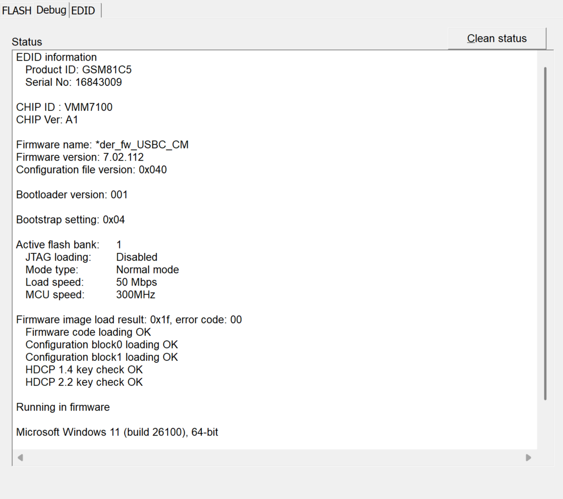

For anybody scouring this thread for clues (as I was doing a few days ago), I just received my MBP 16" M4 Max, connected to an LG C4 via a Cable Matters 201310 adapter (the one with HDMI, Ethernet, 2 USB-A and and power pass-through) and a Cable Matters 48Gpbs 2.1 HDMI cable (2m). Mac OS Sequoia 15.2.
I can confirm that before flashing the custom firmware, options in the resolution panels were severely limited. I then immediately flashed the one from the knowledge base (while the one in the OP works and I'm sure it's safe, the procedure from the official source seems safer and more streamlined), this particular model as already described requires a Windows PC with USB-C and DP Alt mode. It updated it from 07.02.100 to 07.02.105.
Everything now behaves exactly like using the internal HDMI 2.1 port. Resolutions up to 3840x2160 with HiDPI and HDR at 120hz, 4:4:4 passthrough enabled. I didn't even need any workaround from the OP (maybe it was needed for earlier M processors?) everything works straight out of the box. Can also set brightness directly with the Apple keys, and sound volume too (that's why I chose that particular adapter, to plug in a USB audio dongle which becomes the audio out interface).

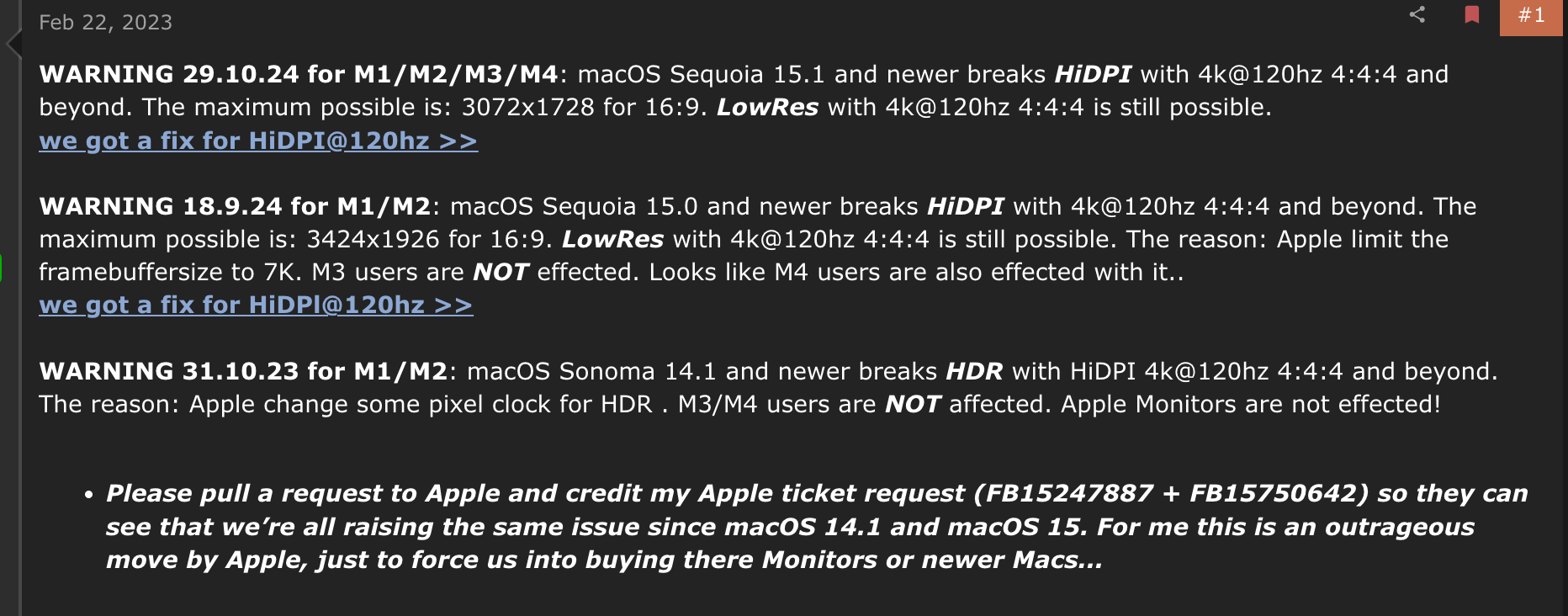

It’s amazing—Apple has probably enabled HDR and HDPI with the newest macOS version 15.2 on the M4 again like on M3 devices. But still, it’s a joke that we’re stuck with a workaround using DisplayPort-Transportstream on a Thunderbolt 5 connection just because Apple limits HDMI. That’s simply ridiculous. And this on a 4000 Euro device. AND older machines M1/M2 are still limited to force u buy newer Macs !
I need some confirmations of that to update the OP with that information.. Do u have some news about M4 Macs and MacOS 15.2 @waydabber ?
