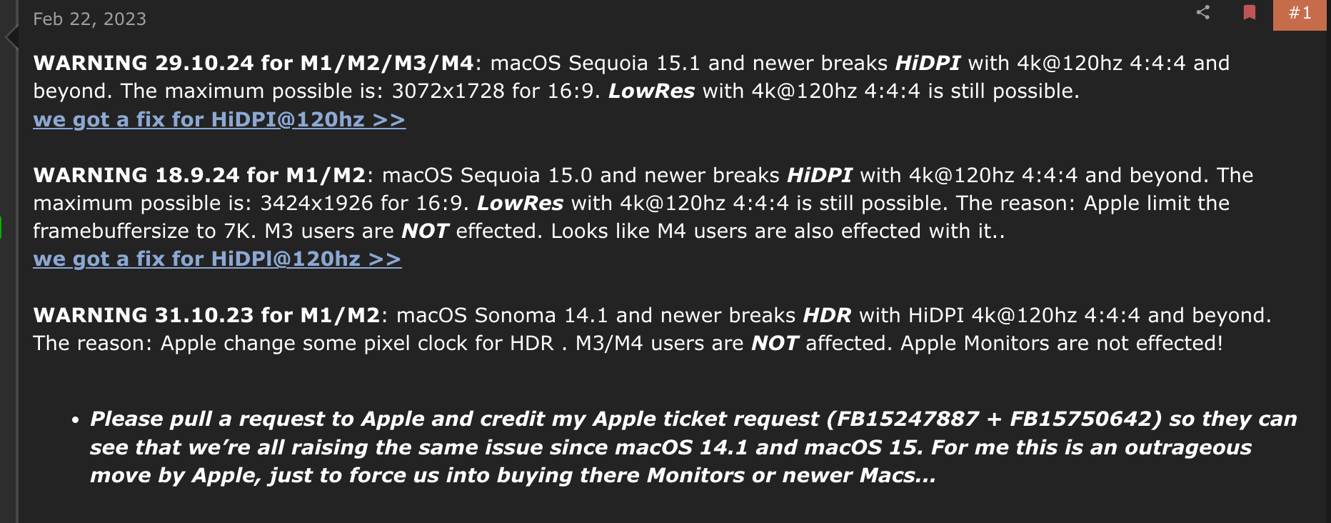

  • Yes, but Apple limit HDR/HiDPI functionality with macOS 14.1 and macOS 15

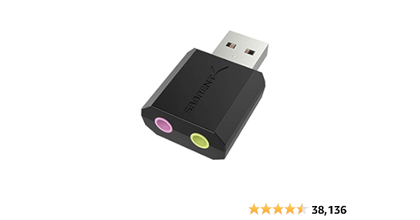

How do you specifically connect the USB dongle to control audio? I'm currently using EqMac to control volume on the LG C2.

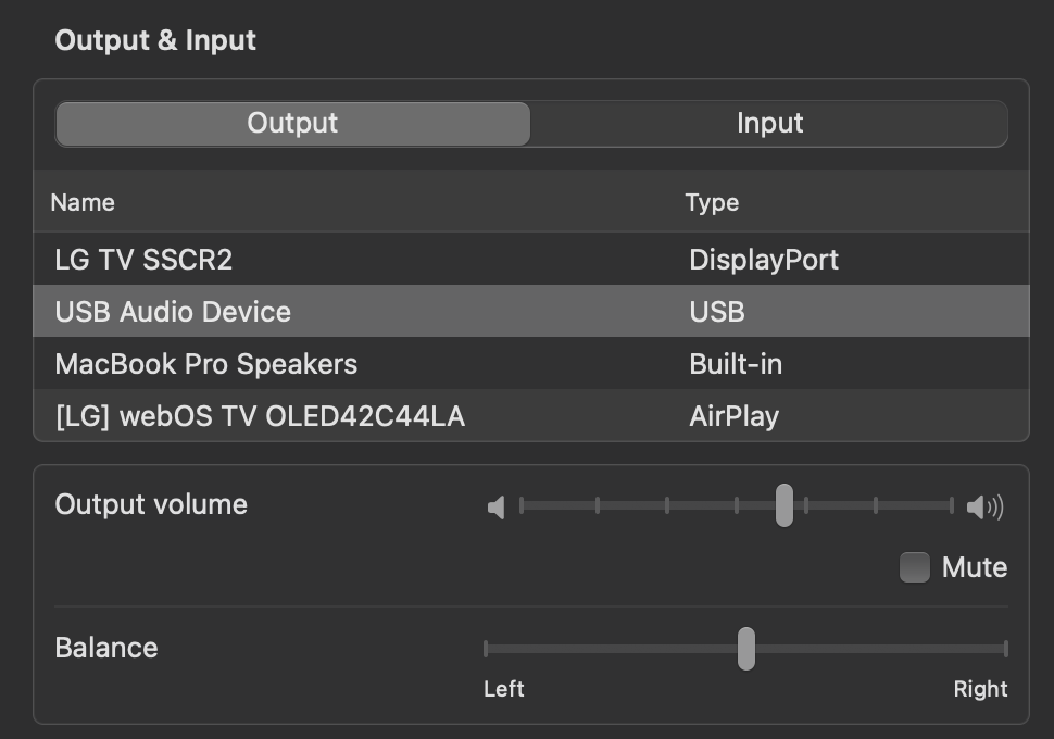

It's basically a USB audio device like this one:
It's plug and play and just shows up in the audio outputs in Mac OS:
I did this just because I frequently switch boot drive or even systems and frequently do clean installs, so I don't want to deal with software not being updated for newest OS or having to install it in every boot drive. With this 201310 setup I basically plug one cable and get 4K 120 video out with brightnesse control, audio out to my 2.1 system with volume control, and charge at the same time. The USB audio device becomes the default when you plug in, it's super cheap and has lasted me at least 8 years (of course if you're an audiophile maybe pick up a better quality USB sound card, but in my case the speakers are already the bottleneck 😃). No software needed, everything works out of the box.
Can you clarify whether the audio being controlled is coming from speakers connected to the sound card or whether it wil control the display's speakers in the absence of a connection?
Edit: Disregard. If you want no frills audio controll for your LG C tv, just download and install eqMac for free. Set your TV volume to your preferred maximum (mine is 45) and that's it.
You'll get a virtual audio device of the TV that you can control the audio of without worrying about CEC or DDC. If you want genuine audio device control, you'll need a USB CEC HDMI adapter.

So, just to clarify, for 4k 120Hz HiDPI with HDR on m1 / m2, the only option is to stay on macOS 13.4 - 14.0, using cable matters firmware, and betterdisplay is not needed? And if newer macOS is required, 4k 120 HiDPI can still be used with betterdisplay + other workarounds, but HDR is off the table?
I'm using the VMM7100 and LG OLED TV with the M1 Pro on 15.2. The default output is 120Hz 8-bit RGB, but the Better Display can set the output to 10-bit RGB. Is there any way to make the Mac output 10-bit by default?
yes, HDR works only without HiDPI when using 4k@120hz since macOS 14.1

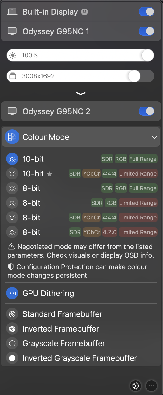

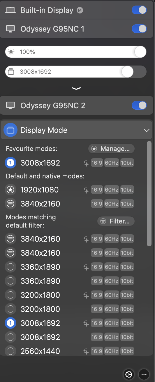

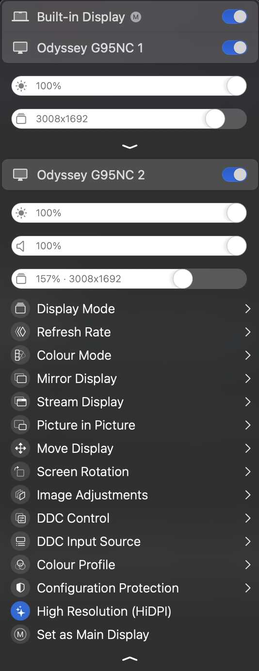

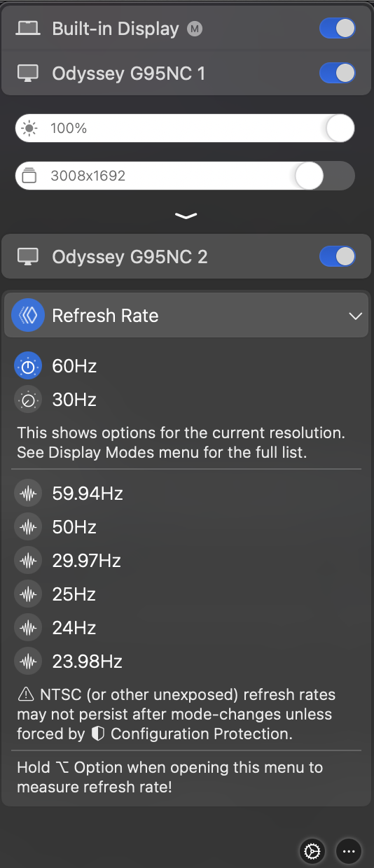

I have the following connections from a Macbook Pro M3 Pro (MacOS Sequoia 15.2) to a Samsung G9 Neo 57 (latest v1007 firmware):
- USB-C on the Macbook -> Cable Matters 201310-BLK Hub (flashed on a Windows PC using the official firmware update tool from CM) -> HDMI 1 on the G9
- HDMI on the Macbook -> HDMI 2 on the G9
For some reason, I can get 120Hz (SDR) only on one of the connections, always on the one that I connect earlier. The second connection always defaults to 60Hz. Holding down option to show hidden resolutions in BetterDisplay pro shows only 75Hz as the maximum available. I tried to play around with color modes and configuration protection, nothing helped so far.
Since HDMI-HDMI works fine as long as it's the only connection to the monitor, I cannot justify buying a second USB-C to HDMI adapter, but if the root cause is the dual HDMI connection, I guess USB-C to DP 1.4 for the second connection could solve it. What am I doing wrong here?
If I understood correctly, EDID override doesn't have to be disabled, since this is a VMM7110 adapter.
Screenshots from BetterDisplay:
View attachment 2469373 View attachment 2469376View attachment 2469375View attachment 2469374
I found the root cause in the meantime. Turns out that the HDMI 1 (120 Hz) input of the G9 Neo will give me 60Hz, doesn't matter which cable or adapter or cable/adapter combo I use. Using HDMI 2 and 3 for now, both of them can run at 120Hz, at the same time. I switched to a Maxonar USB-C to DP 1.4 cable in the meantime, so I have cables running only on the left side of the Macbook for better cable management, but HDMI out to HDMI in (2 or 3) was working fine too.

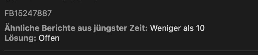

Reference my feedback on apple does show now about 10 same reports! Keep going @ all, 10 is almost way to less!
