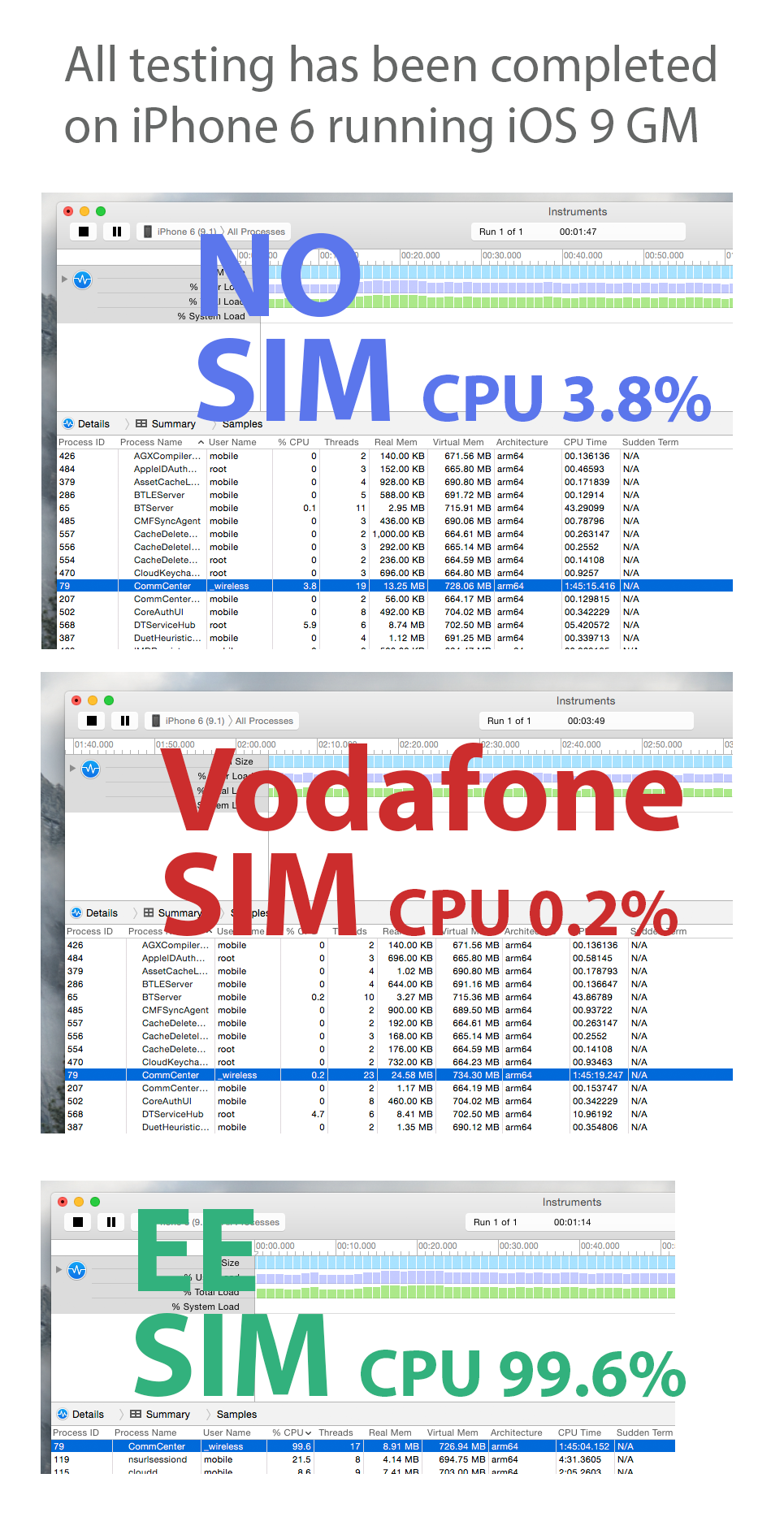

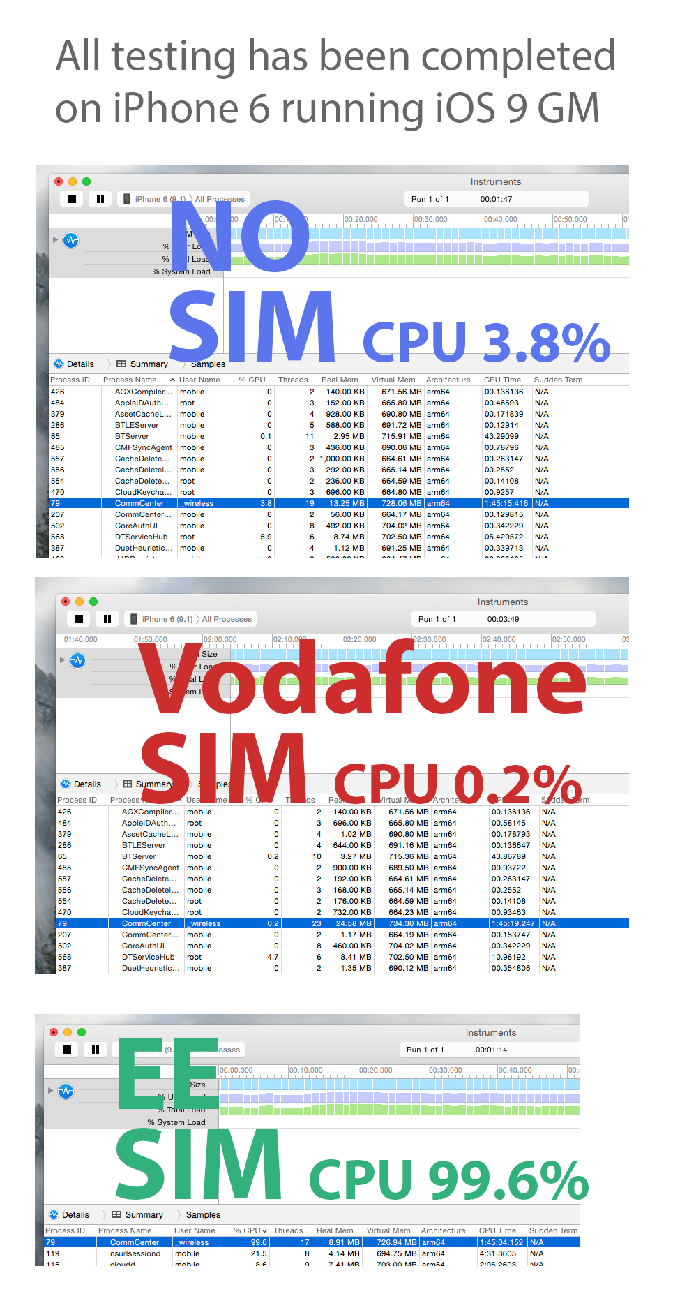

Just to share further clarity on the testing i've done.. Certainly looks to be something on the EE side, could it be due to they are the only carrier to offer Wi-Fi calling? Operate on a different 4G spectrum? Visual Voice Mail Services? Will try and highlight this to both EE and Apple to understand why this is occurring.

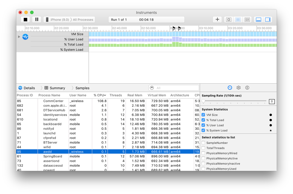

Same 100-115% CPU usage in CommCenter:

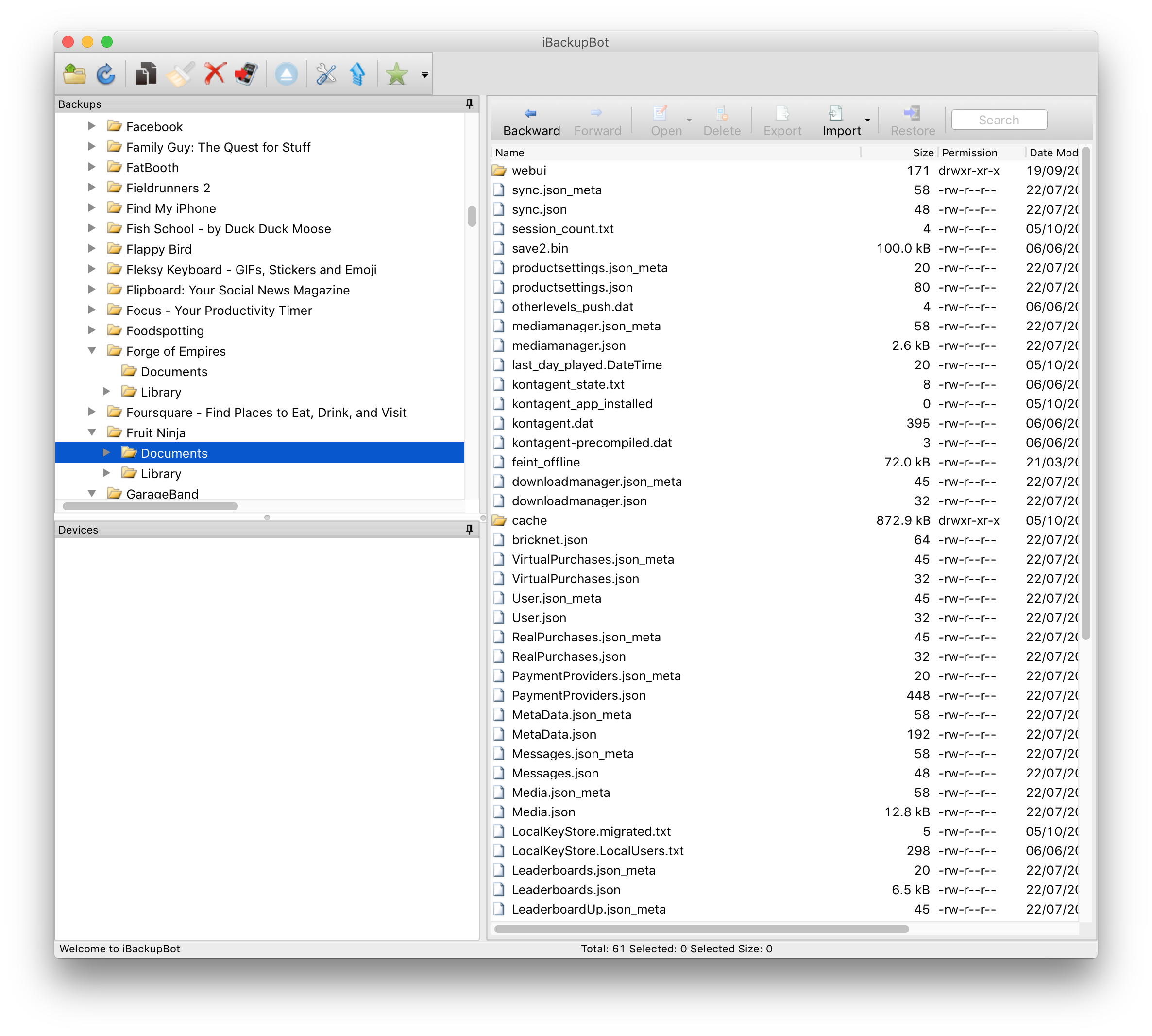

  7. Your messages will not be restored because SMS/iMessage is not backed up to iCloud (except as a full backup) but you can use iBackupBot (free edition) to restore your SMS/iMessage from the iTunes backup you made in Step 1. Follow the steps detailed here: http://www.idownloadblog.com/2014/03/06/how-to-back-up-restore-sms-messages

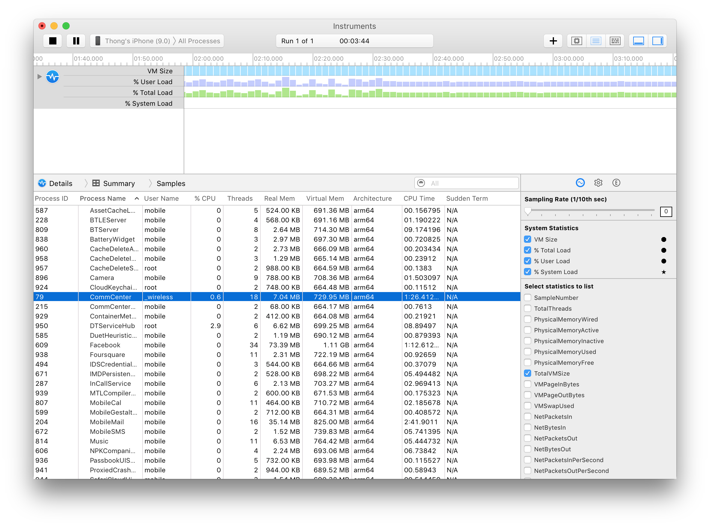

CommCenter before:
CommCenter after:

Thanks for typing this out - hopefully it solves the problem for others. I unfortunately can't go with this solution because I have quite a lot of app data that isn't in iCloud (e.g. game save files where the game doesn't support iCloud). Setting up as a new device would cause me to lose this data - I checked iBackupBot and it doesn't seem to allow me to view app data in the backups (Documents folder for every app is empty). Hopefully Apple/EE address this issue in a carrier update, iOS 9.1 beta 2 or 9.0.1..
Are you sure? I can see contents of the Documents folders under "User App Files"
