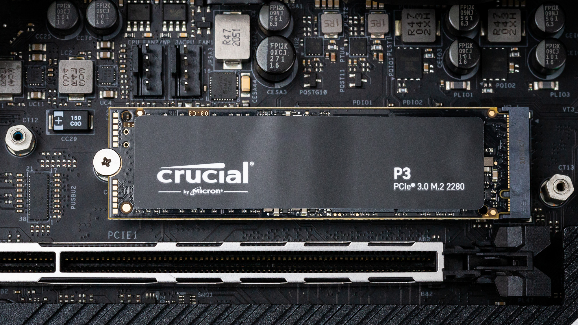

Oh my, apparently the whole SSD revolution is 90 percent nonsense as after some deep research . I finally am gathering an understanding of how write caching works and how low quality SSD memory and pricing works . I have found solace in going to TOMs Hardware for any SSD related testing and results . Everyone should pay attention to the 15minutes of sustained writes test and who can get above 1GB a seconds sustained writes in the bar graph!! not many SSD's can hit this level at a cheap price!! Busted these SSD makers ! Just had to study this
especially for Sequential SUSTAINED write test . no one else is doing a full 15 minutes + slamming terabytes of write data test.
Look at this example ,scroll down to the Sequitial write test !
