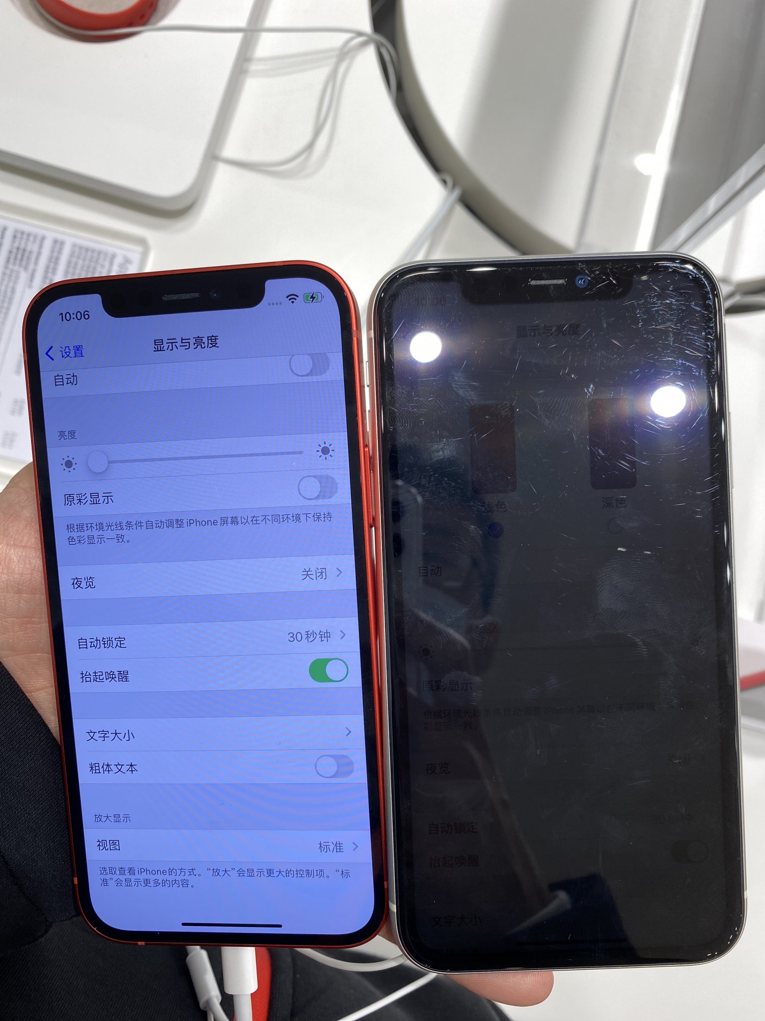

Did you see this post on Macrumors?
I attach a photo from that discussion. Here are demo iPhone 12 "Not for sale" from App Store and usual iPhone 11 from owner. For both iPhones is set 0% brightness. Do you see very hight "zero" brightness on iPhone 12 on left side? Of course, iPhone 12 doesn't show high pulsations in this special mode.
In fact, Apple used DC Dimming for demo iPhone 12 in the App Store. It's dishonest, because you may think that it doesn't flicker. So you need to check a real iPhone 12 from owners or from another independed shop. And compare zero brightness with your own iPhone to make sure that it doesn't use any tricks with brightness.

Check the photo above. Special iPhone 12 in App Store has very high minimum brightness. This iPhone cannot be used in real life.

Maybe they have other OLED Panels in the Demo Units, in the Thread the Poster wrote, that only some of the Demo iPhones had a flicker free Panel. I could imagine because this, because it is usual not only in the phone business.
These iPhones have special store firmware that limits minimum brightness to 25% or so, because stores are brightly lit and a phone with dark screen would look like a defective unit. They also have some apps and data pre-installed.
