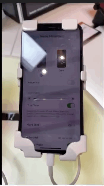

I dunno.. when I slow motion checked the Mini.. it was WAY more active (ripples) than the 13.

It's interesting how no flicker or bars at all show when you do slow-mo video of the 13 Pro. I am so tempted to give it a try, but would not be thrilled about moving up to a larger phone again.

Thanks for sharing! I see the pro doesn't show any visible flicker on slow-mo video, and some who were sensitive to PWM on past devices did not have trouble with the 13 Pro.
