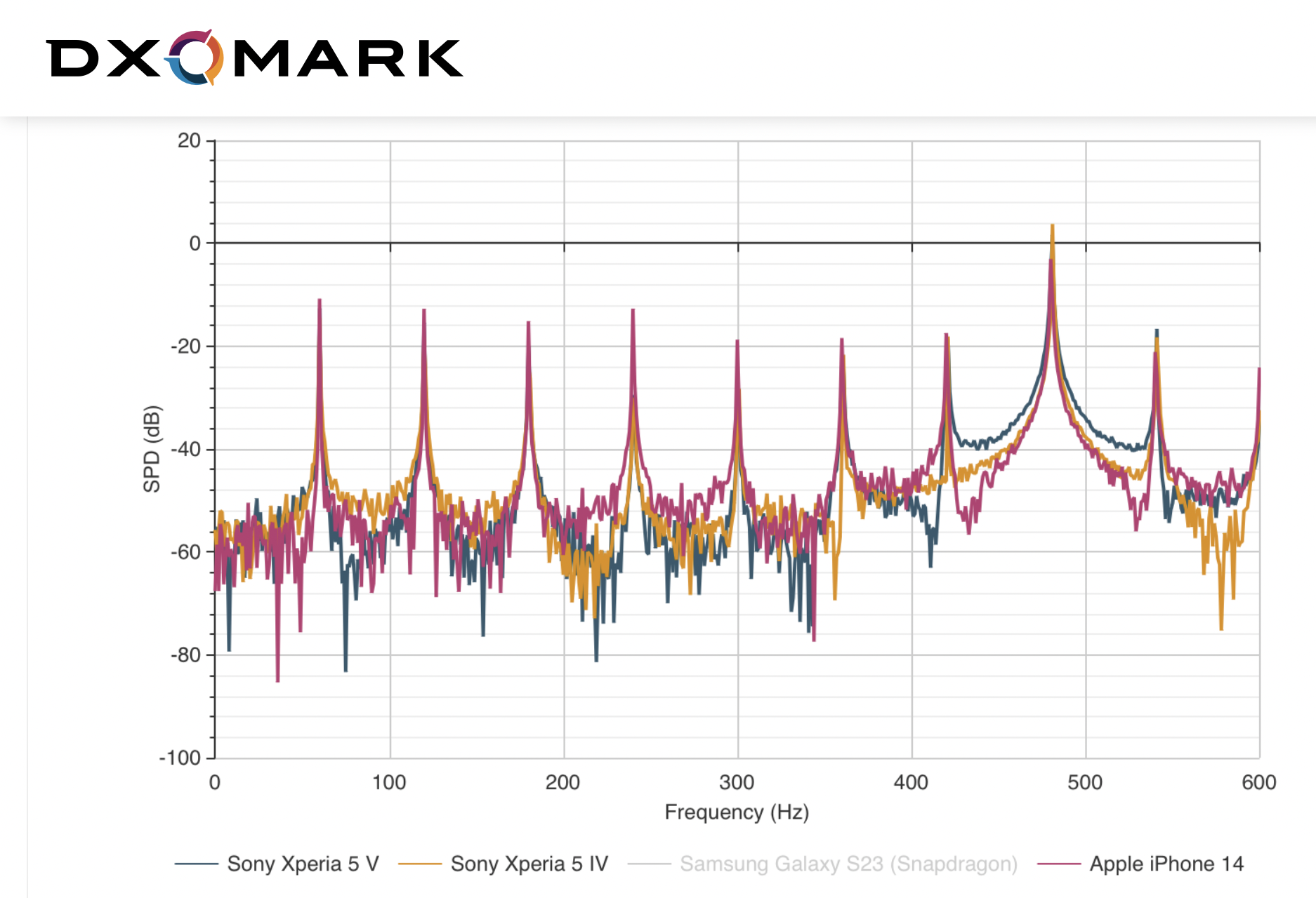

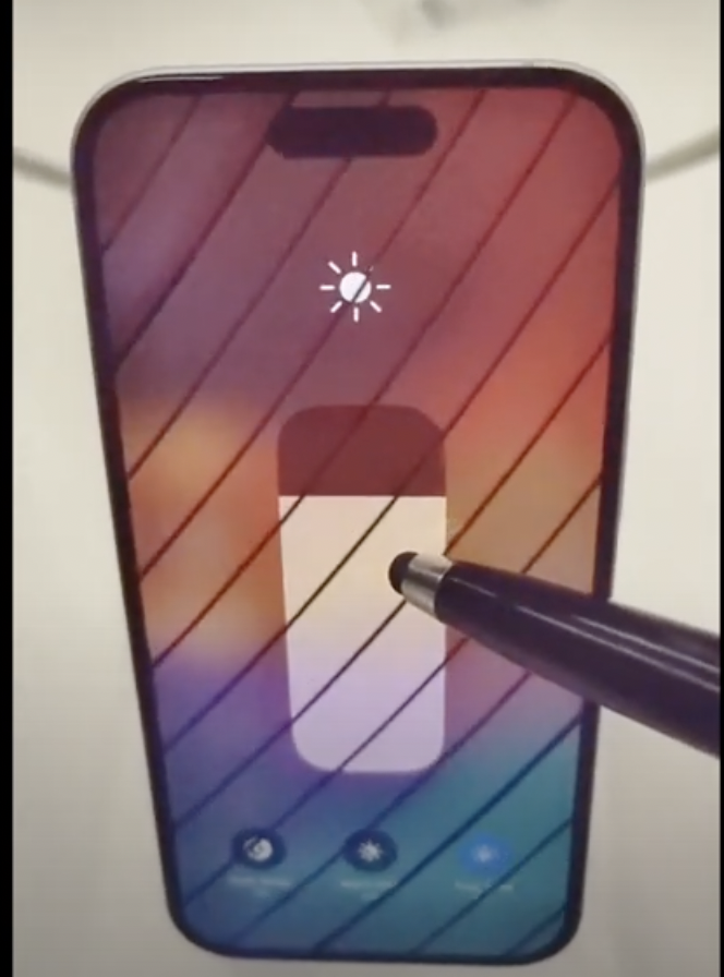

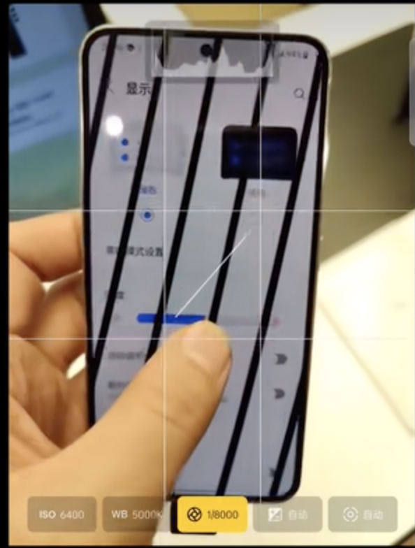

An interesting fact I just learned is that the iphone 14/ 15 appears to be sharing the exact same dimming customization of irregular pseudo 60 hertz sine wave (made from 480 hertz) as the xperia 5 IV and V.

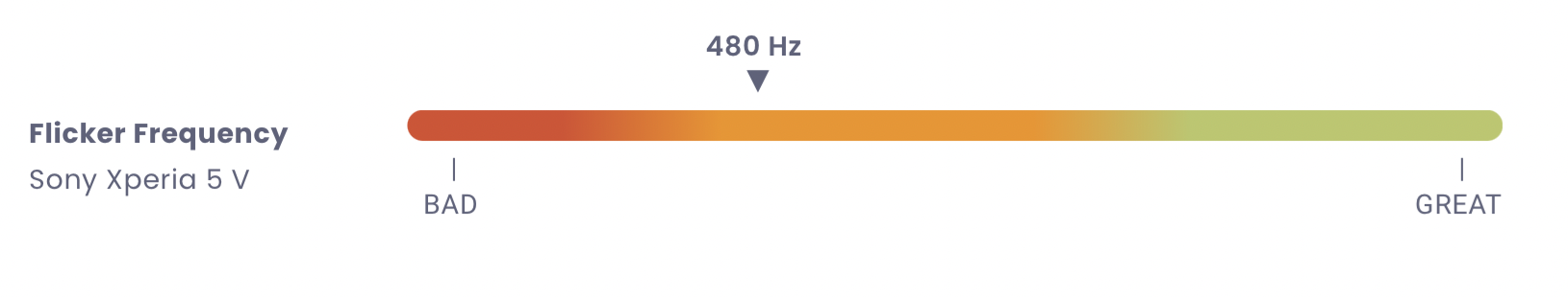

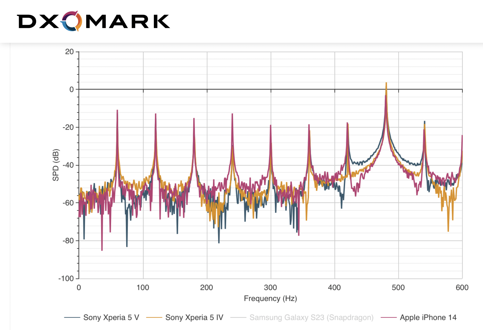

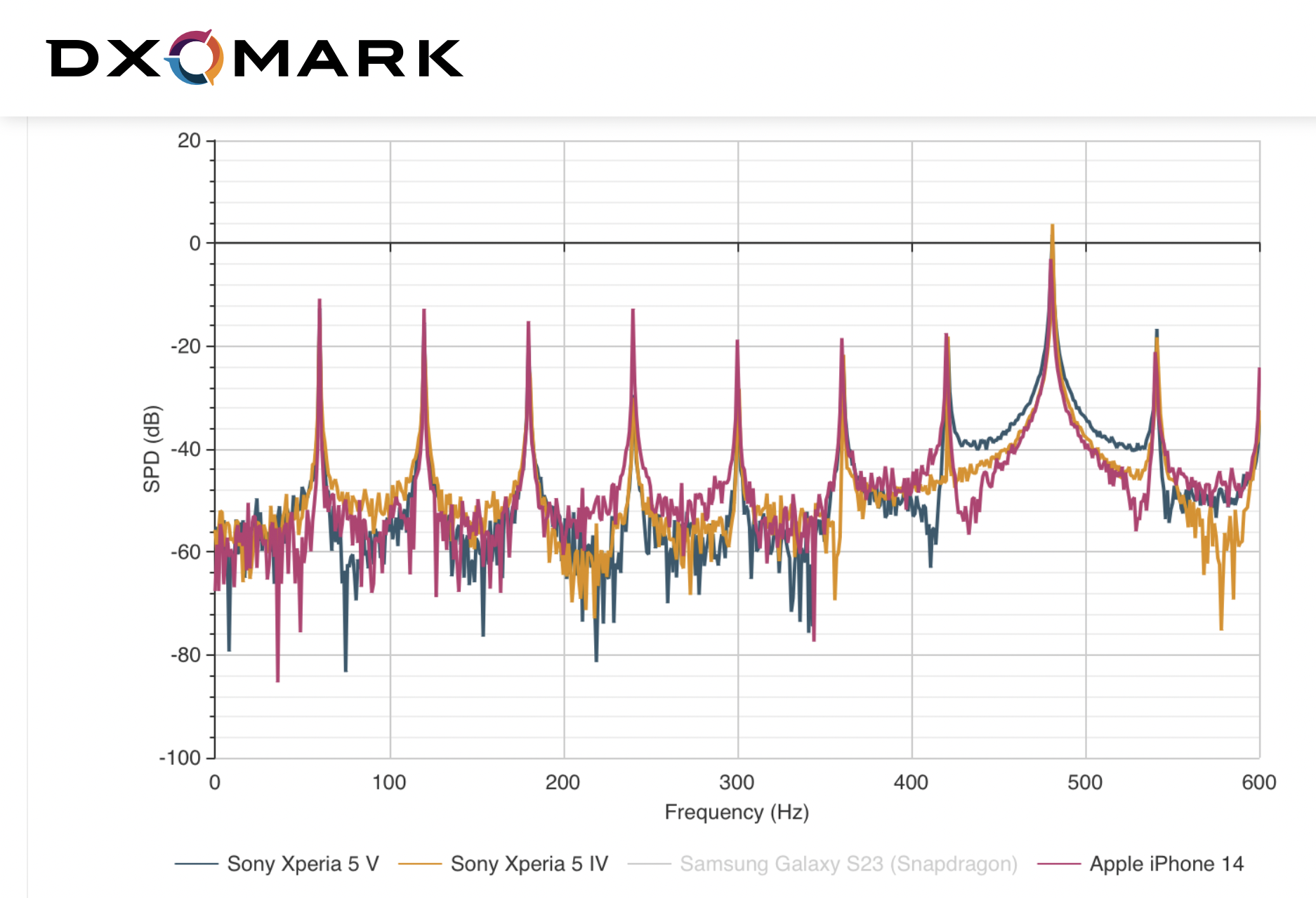

If we were to refer to reading from DXOmark display flicker test, we can see that this true.
If we were to verify DXOmark's data from difference sources such as fast shutter speed, we can observe that they are using the same 480 hertz implementation.

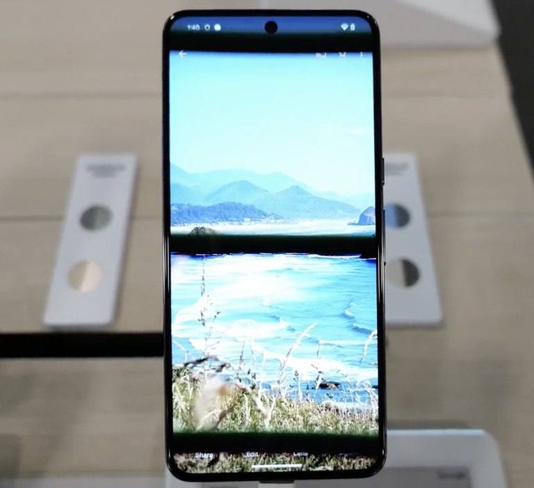

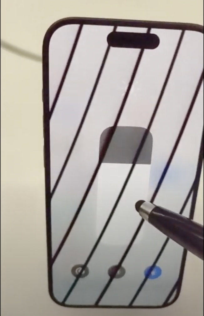

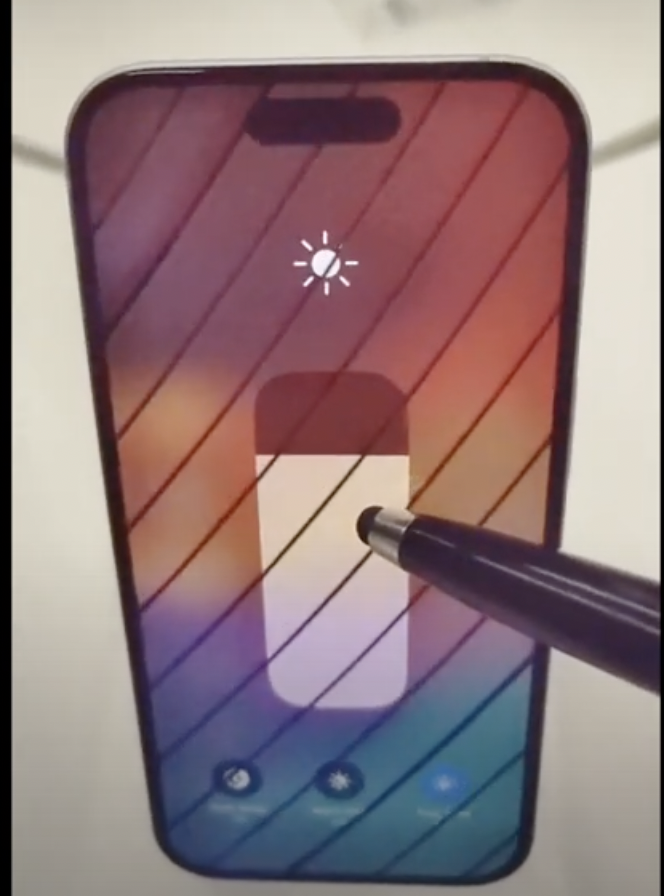

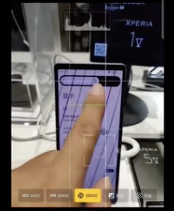

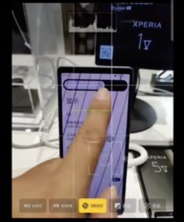

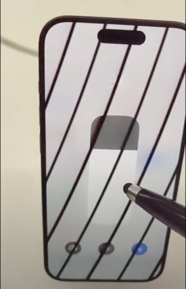

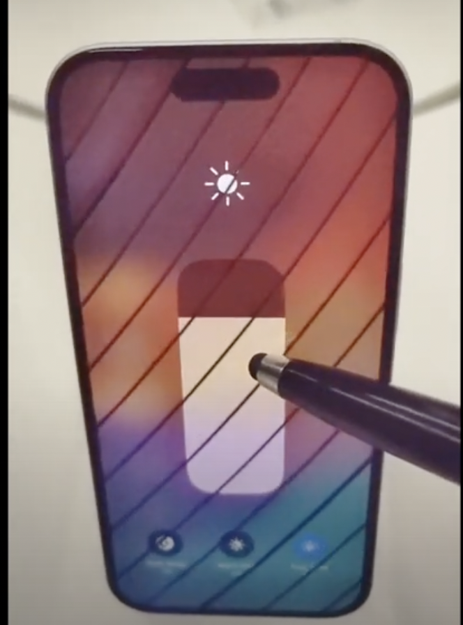

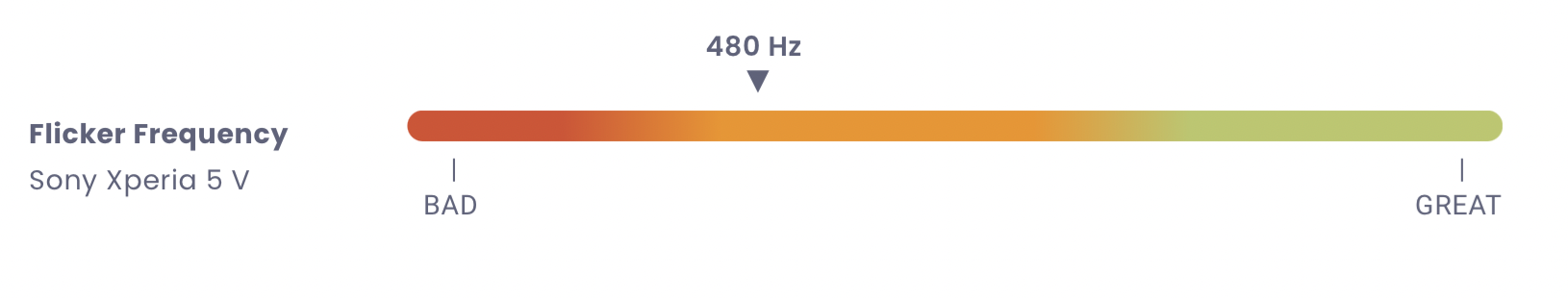

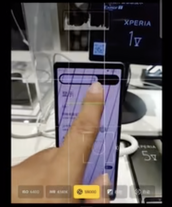

Xperia 5 V 480 hertz (custom modified to irregular pseudo 60 hertz sine wave - 9~12 banding lines artifacts found)

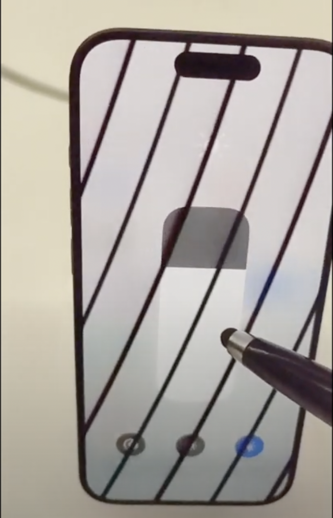

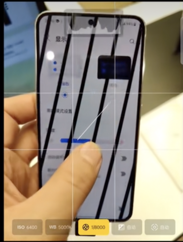

iPhone 15 480 hertz (custom modified to irregular pseudo 60 hertz sine wave - 9~12 banding lines artifacts found)
We observed that there are a total of 9~12 banding lines artifacts there. This is an indication of 480 hertz.

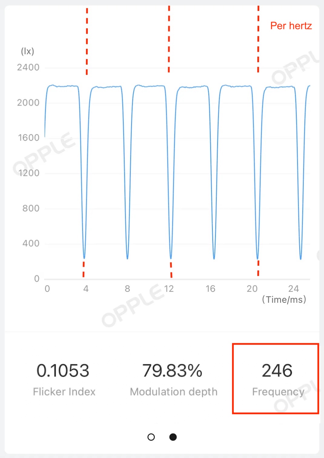

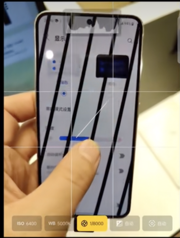

A native 240 hertz flicker hertz panel, however, like the iphone 15 pro;
will have 6~7 banding lines artifacts instead.

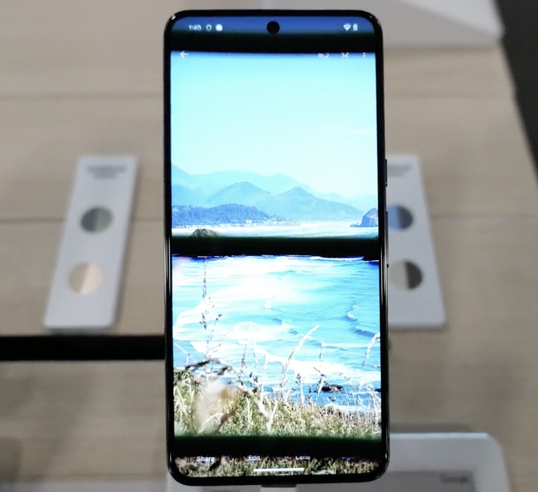

Iphone 15 pro - native 240 hertz flicker panel (6~7 banding lines artifact)
Galaxy S23 - native 240 hertz flicker panel (6~7 banding lines artifact)

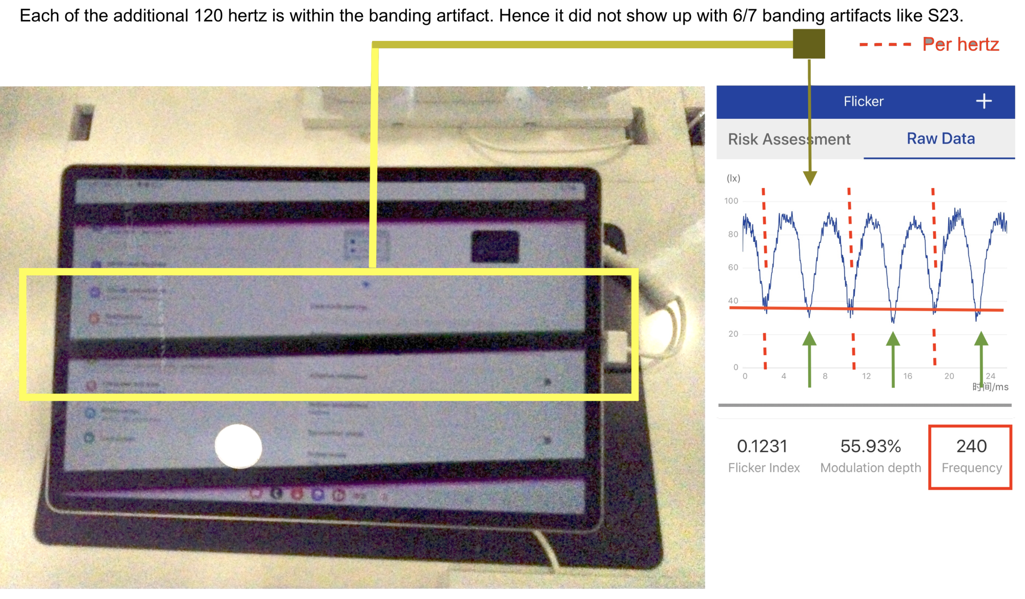

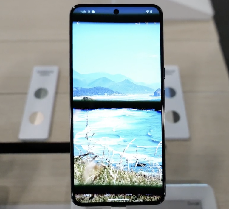

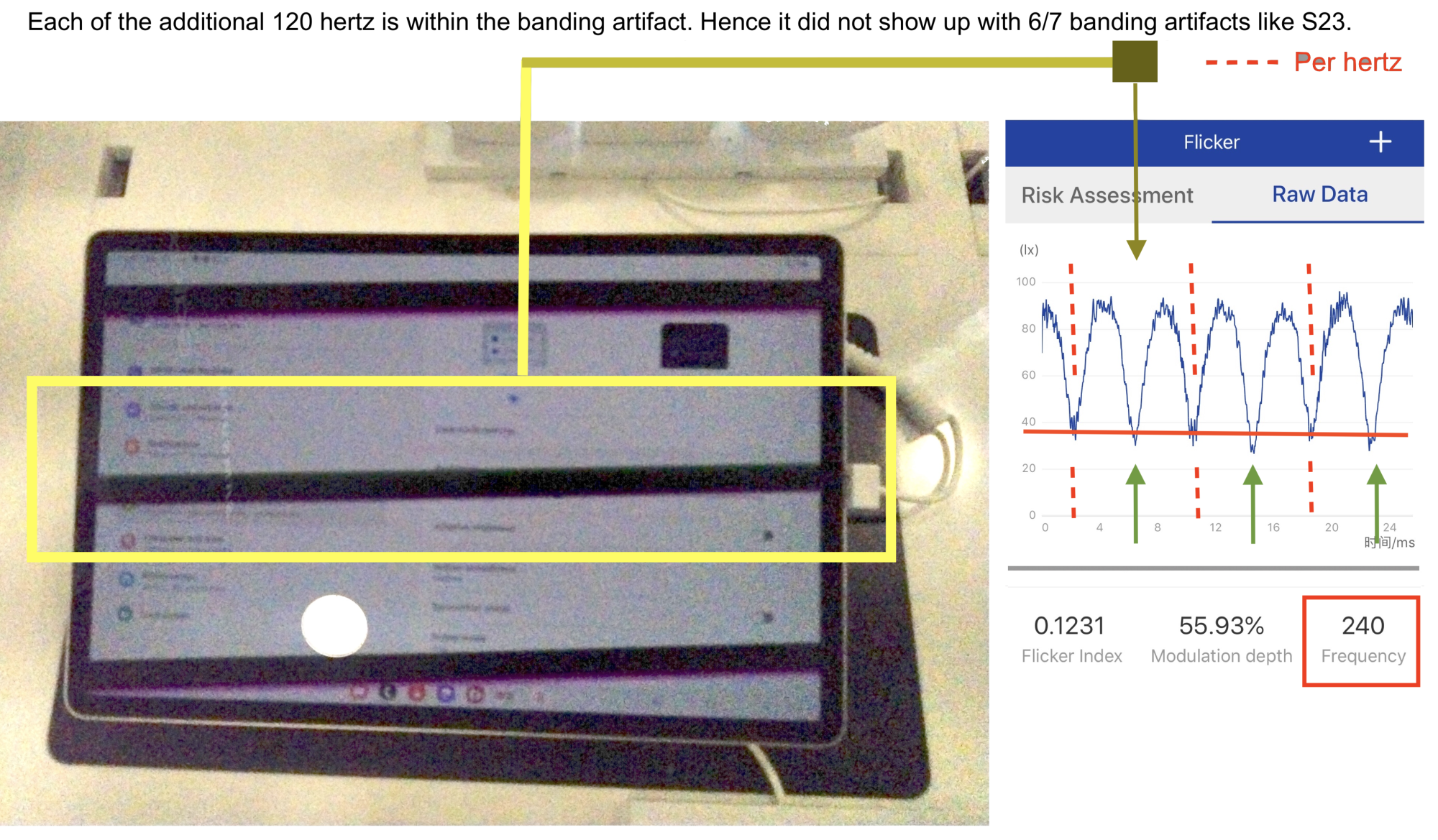

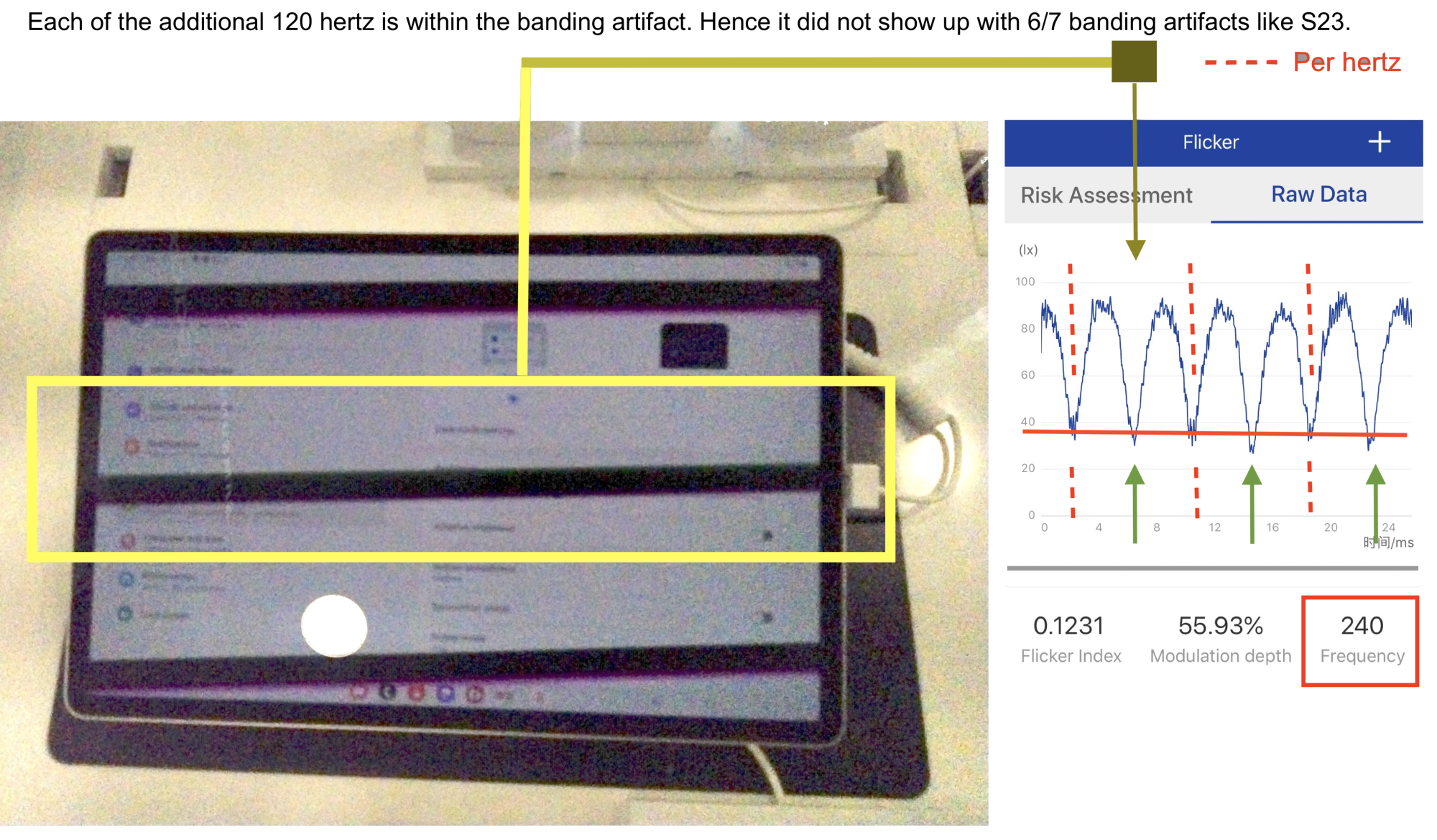

For some screen panels like the Pixel 8 Pro or the Galaxy tab S9 plus (below), they show up as only 3 banding artifacts because they were originally 120 hertz flicker panel.
Galaxy Tab S9+ - native 120 hertz with additional 120 hertz added in within each hertz. Totally up to a pseudo 240 hertz.
Pixel 8 pro - native 120 hertz with additional 120 hertz added in within each hertz. Totally up to a pseudo 240 hertz.
Pixel 8 pro source material contributed by reddit member u/madmozg.

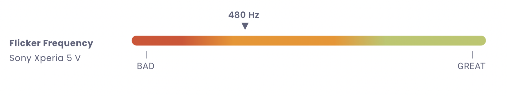

For instance with the Xperia 5 V, Sony customized it to:
• run DC-like dimming between 100% to 80% brightness,
• then switches to Pulse Amplitude Modulation(PAM) between 79% to 60% brightness (Duty cycle locked but modulation depth % increase),
• and finally Pulse Width Modulation(PWM) between 59% to 0% brightness. (Duty cycle changes, along with modulation depth % increasing)

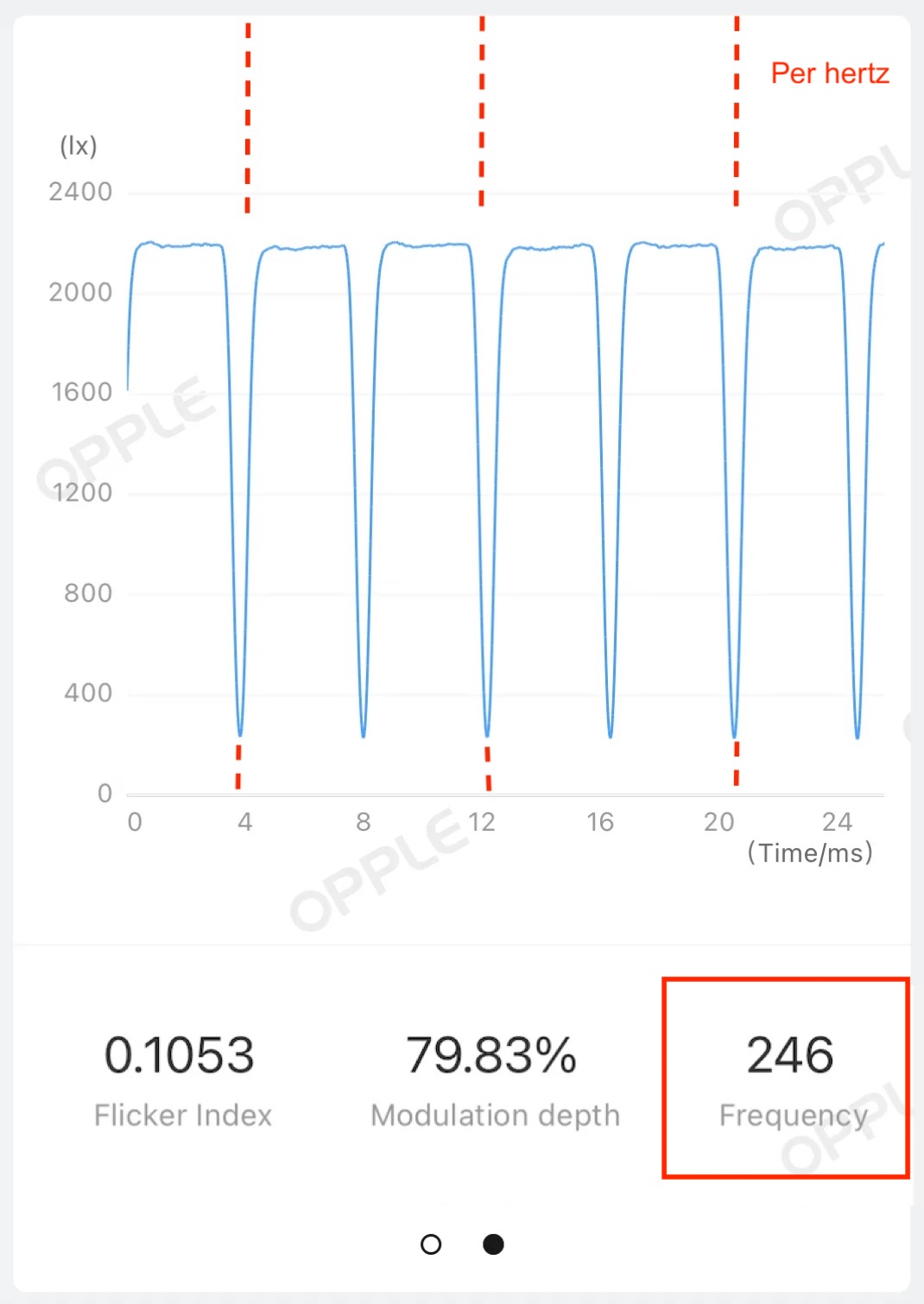

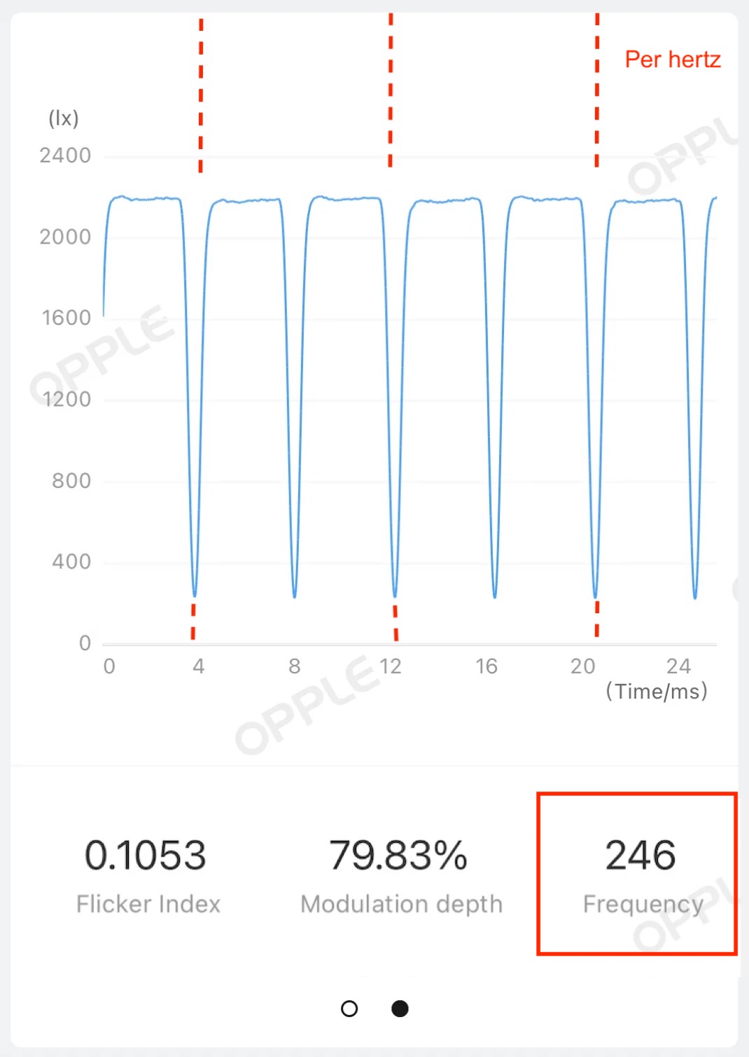

Thank you for sharing the above. Yes indeed, I was trying to gather more insights to this new dimming phenomenon. For it is something totally new and not commonly discussed, even among the Chinese communities.
It turns out for the iphone 14/15, underneath each the 60 hertz pseudo sine wave, perceivable flickering at every 8 intervals within the 480 hertz can be found. It is very likely that it is using Pulse Amplitude Modulation (PAM) to regulate the brightness, instead of DC-like Dimming.
As pointed out by a few reddit members, this "underlying" flicker can only be detected if we put the light flicker meter right up to the screen. The question back then was whether are we affected by this underneath flickering, or is this by design of some of the newer OLED dimming methods.
We want to avoid being in a situation where we falsely called out there is a wolf - in this case; flicker that affects us - when in reality there isn't one. Or vice versa.
Thus now we have evidence to confirm that the underlying flicker does affects us. This is because Pulse Amplitude Modulation (PAM) is at work here.
