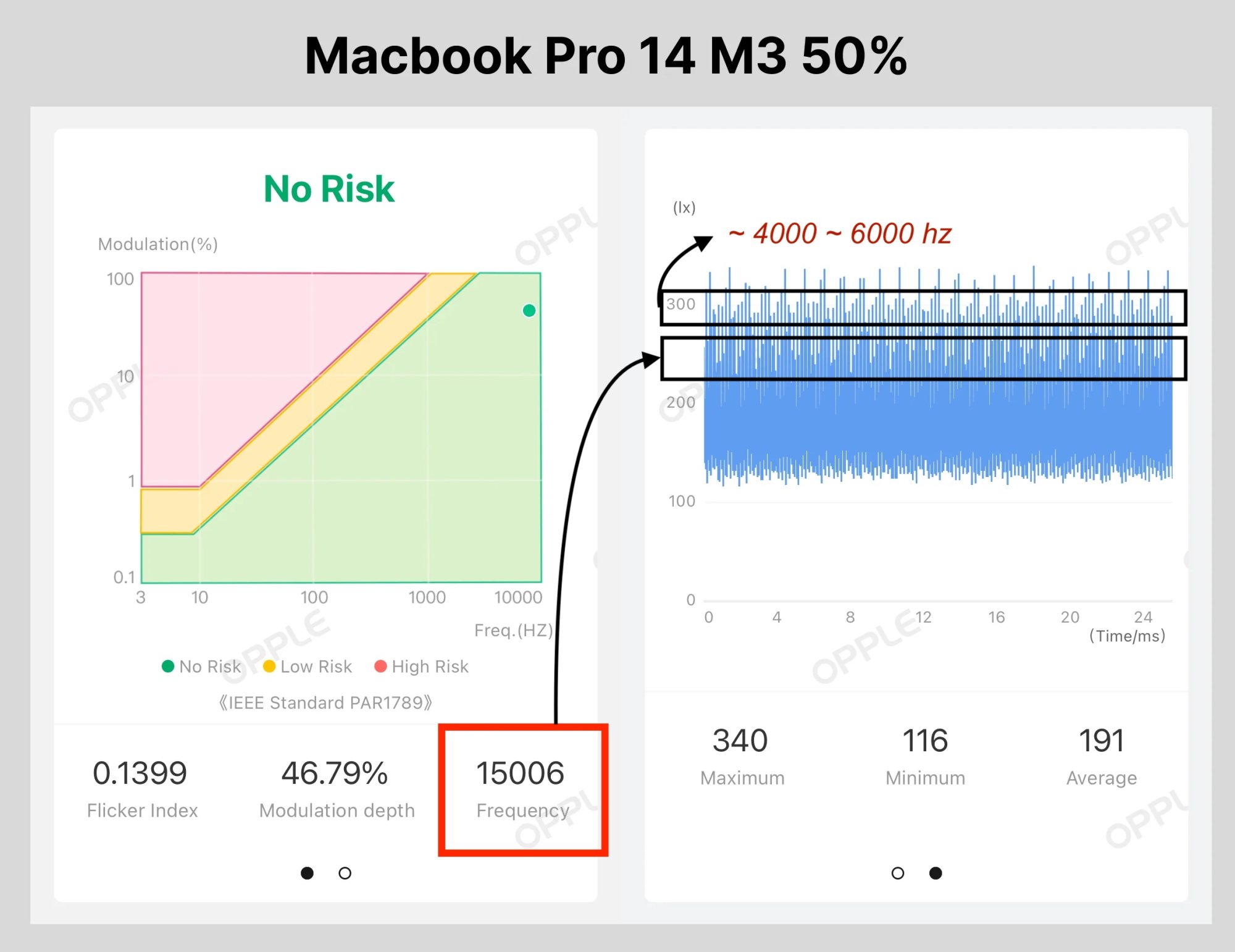

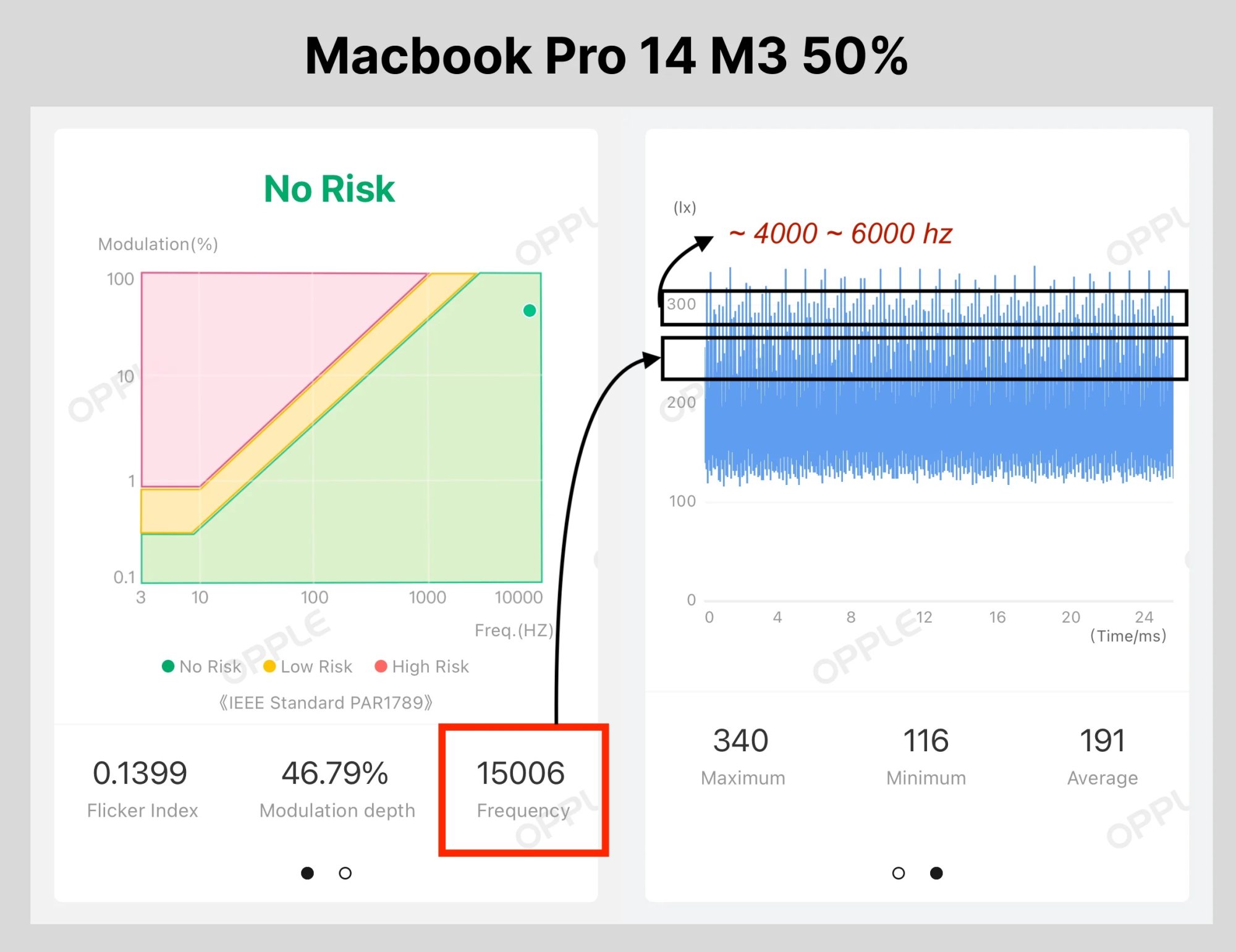

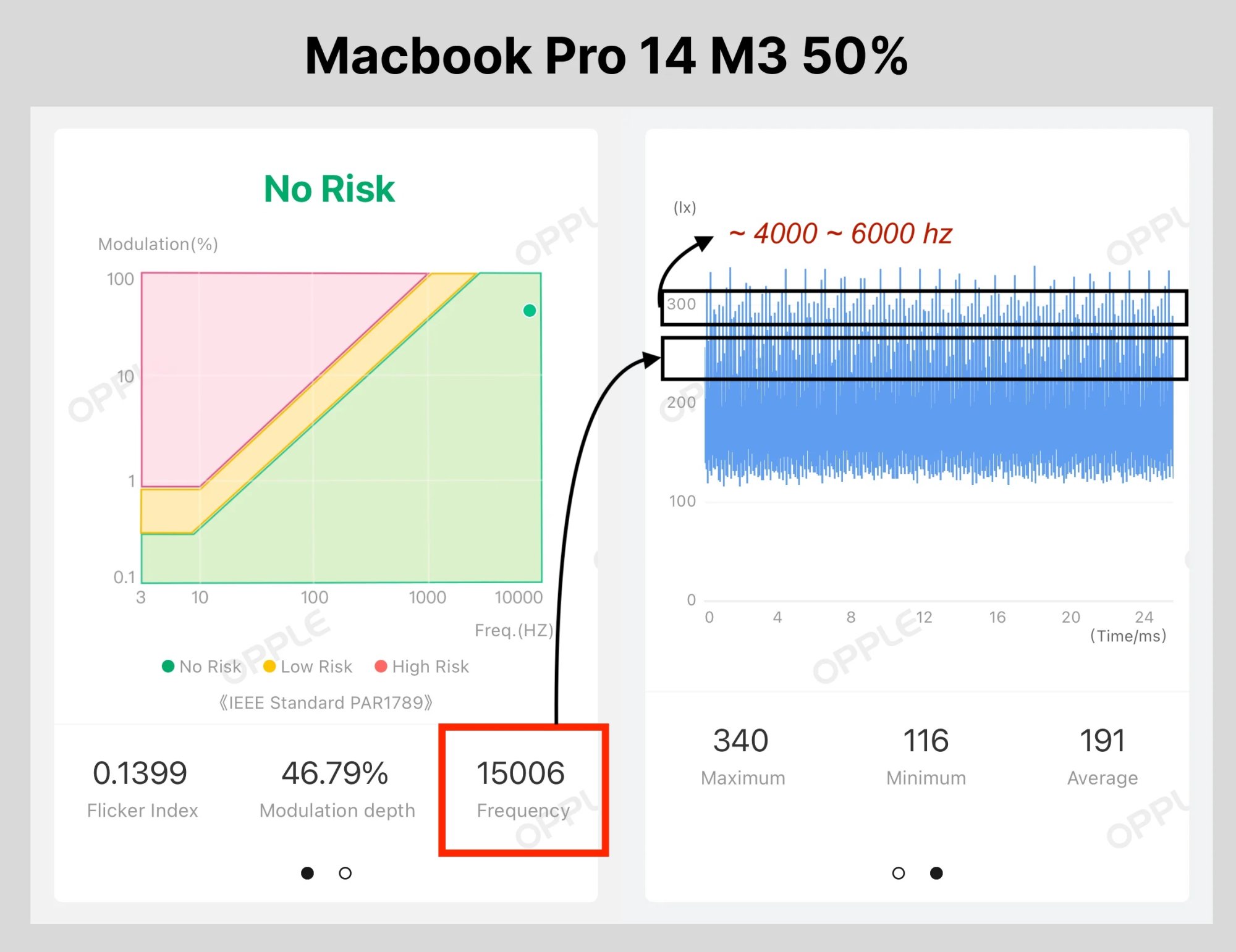

For those that are still on the fence wondering if Apple's macbook pro mini led of 15khz will help to mitigate eyestrain/ headaches, a fellow member of ours has posted and updated some significant further insights into this mini-LED implementation methods.

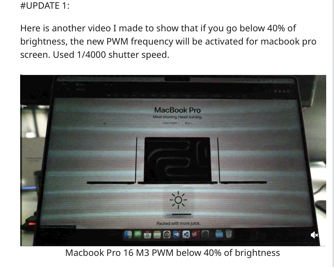

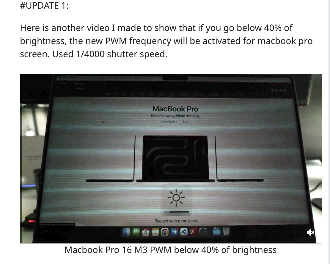

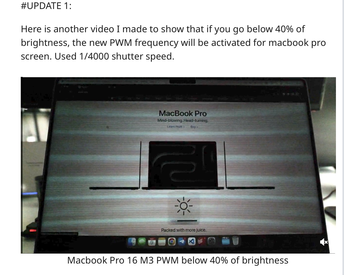

An additional PWM flickering of ~80 hertz was found if panel brightness is below 40%. Op also validated this additional low flickering hertz findings with a fast shutter speed.
Something additional I have just observed based on the post readings ~
While above 40% brightness, there is an additional ~4000 - 6000 hertz flickering. This is evident in Opple graph and was also showed in Op's fast shutter speed of 1/16000.

I also looked at the MacBook Pros and can confirm the 40% thing is accurate. Above 40%, seemingly no issues, but below, PWM was blatantly obvious. I didn't bring in the Opple tonight. Instead, I used my favorite iOS app: Illuminance Pulsation Meter. It's my quick and dirty way to test for PWM/flicker/naughty displays.

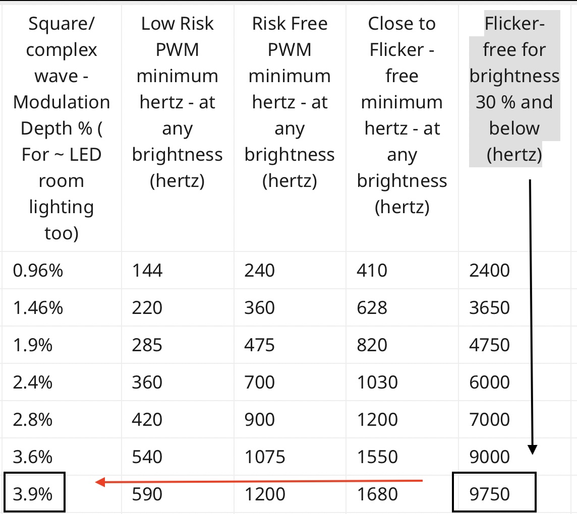

Can you guess which type of system the SE is using from the frequency or modulation depth at 100% (9846Hz, 3%)?
This was why I have prepared this chart below for future reference. 🙂
Ok for Opple readings, if said panel flicker frequency has exceeded 40,000 hertz, the system will just crop out a portion of it and report it as 9846 hertz.
This is how it work around its limitation(Max 40,000 hertz).
If the iphone SE is getting 9846 hertz and modulation depth % of 3.9 (or below), and while tested between its 30% to 50% brightness level, then it is without a doubt, lighting system (1).
If the modulation % is not 3.9% and below, then it could be other lighting system from the top 4 panels.
