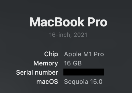

Hi everyone, I had a MacBook Pro M1 Pro and experienced this issue for a few days. I tried all the usual methods to fix it, but nothing worked. Eventually, I reached out to Apple Support, and they suggested the following steps:
  1. Back up your Mac using Time Machine.
  2. Revive the Mac by following this guide: [How to revive or restore Mac firmware].
  3. Upgrade macOS to the latest version.
It’s a long process, and you’ll need access to an extra Mac, but in the end, it worked for me. I didn’t lose any data—it was just a firmware update. However, make sure everything is backed up before you start. After completing the DFU revive, the macOS update process worked as expected.

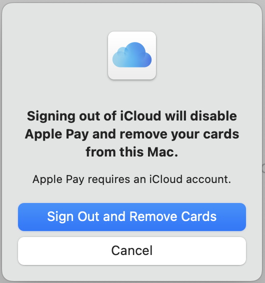

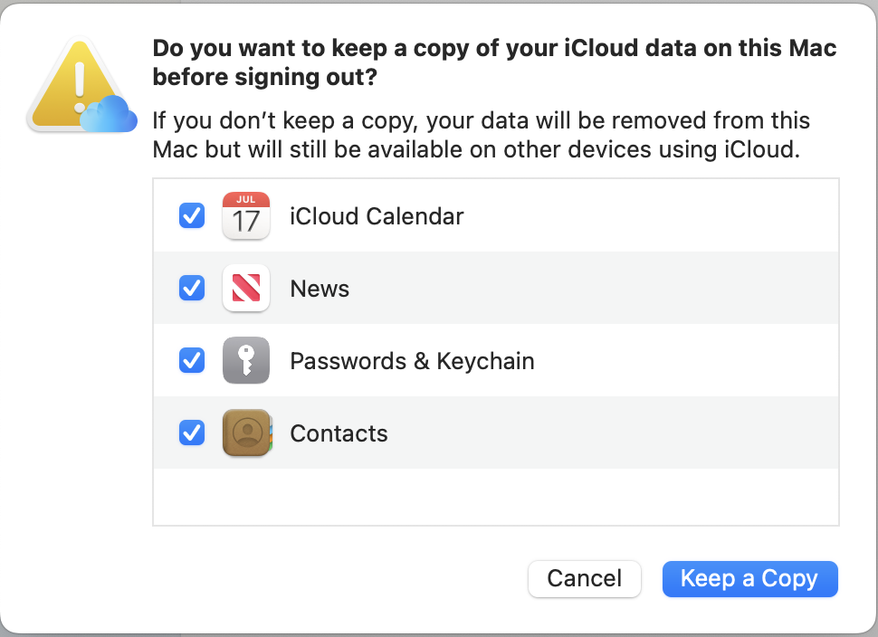

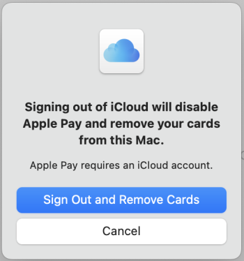

If i go to settings and try to sign out of iCloud it shows this:
I don't want it to remove all my credit cards as I have to readd and reactivate them. I have a lot.
