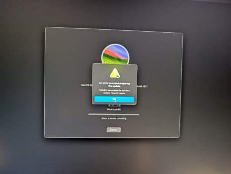

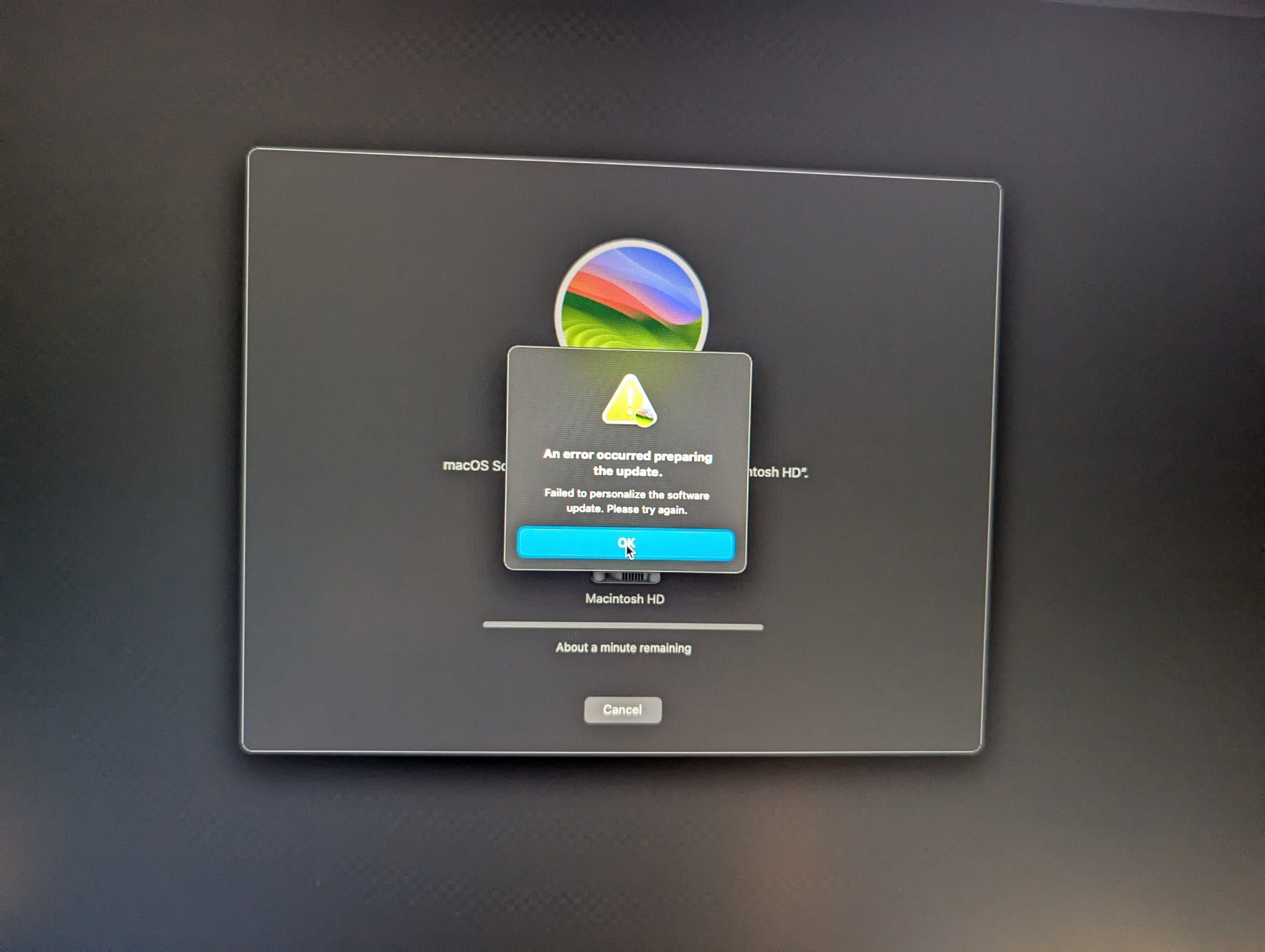

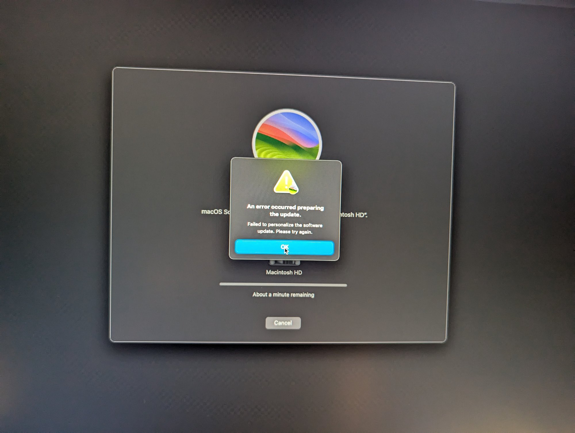

Facing similar issue. Escalated the issue with Apple support and I don't want to take my mac mini m2 to service centre for revive and recover process.
I have already tried restarting my machine, switching to different wifi network, safe mode, Recovery also failed with error message, uninstalled VPN, Kaspersky and Adguard and even updated the DNS to 8.8.8.8
Attaching the recovery failure popup.
