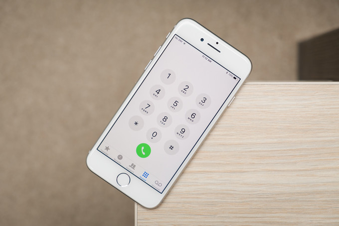

From Phone's Arena:
In an unexpected upset, Apple really drops the ball with click-ridden voice-calls
It feels like for the vast majority of phones we review, we can breeze right through the call-quality tests; so long as nothing goes horribly wrong, there's usually not a ton to say. So we're a little surprised to find ourselves thinking so hard about the iPhone 8, after running into some unexpected issues with its voice-call performance.
While engaging with callers, we often observed an intermittent clicking sound coming from the phone's earpiece. This artifact doesn't seem to be emanating from the distant end of the call, and only popped up when testing the iPhone 8 (and 8 Plus, which we'll be addressing separately).
Curious if this might be a consequence of the phone's noise-canceling feature, we tried turning that off, yet the clicking continued. It's possible we just have a bad phone (or rather, bad pair of phones), but we're a little shocked to see an iPhone get something so simple so wrong. It's not like the clicking makes calls unintelligible – and some users will dismiss it as too minor to care about – but for a phone of this pedigree, and this price point, we expect voice-call perfection.
Ridiculous considering this design has been around long time.
