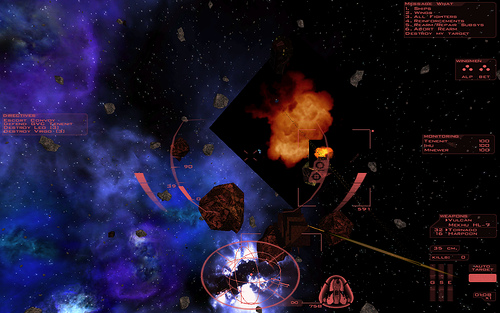

Asteroids
Well, I decided to go back and replay the main freespace 2 campaign. Loved it the first time! However, on the first mission with the GTVI, I have to protect the Iceni from asteroids. Problem is, the asteroids aren't there. They can be targeted, but I can't actual shoot them. Is this a part of the X1600 bug? Is there a way around it? I can post screenshots if needed. Thanx.
Asteroids sort of fixed

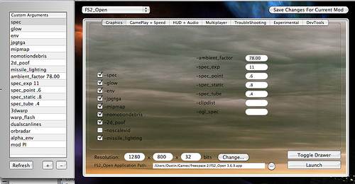

I activated the jpgtga option and got some results. The graphics are not exactly there, but they can be destroyed now. They seem to swoop across the screen randomly. Anyways, it's better now. Is there anyway I could help with the X1600 issue? Can I write something to apple or ATI? I just wouldn't know what to write so that the issue is understood.
I got everything to appear when i looked in my FS2 folder and realized all my vp files were in folders, i pulled them out, put them in the main folder and BAM, everything was there. Even before I did that, I remember being able to destroy the asteroids in that mission.
The first time I played this mission I was able to destroy the asteroids, but the graphics still weren't there. It is a weird issue, but it has to do with my graphics card. What graphics card are you using?

I've never had any luck getting 3rd party campaigns to work. The graphics are always jacked up. Here is a screenshot from the procyon insurgency. I have always used soulstorm's launcher cause it rocks and I'm lazy. Let me know if you have any ideas or if it just always looks like this. I'm also including my config file.
