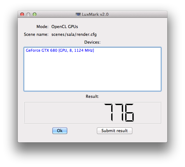

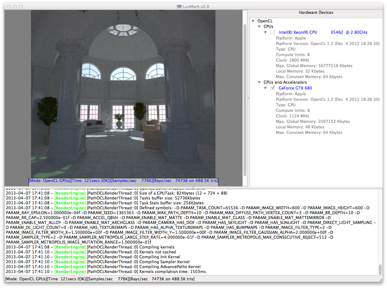

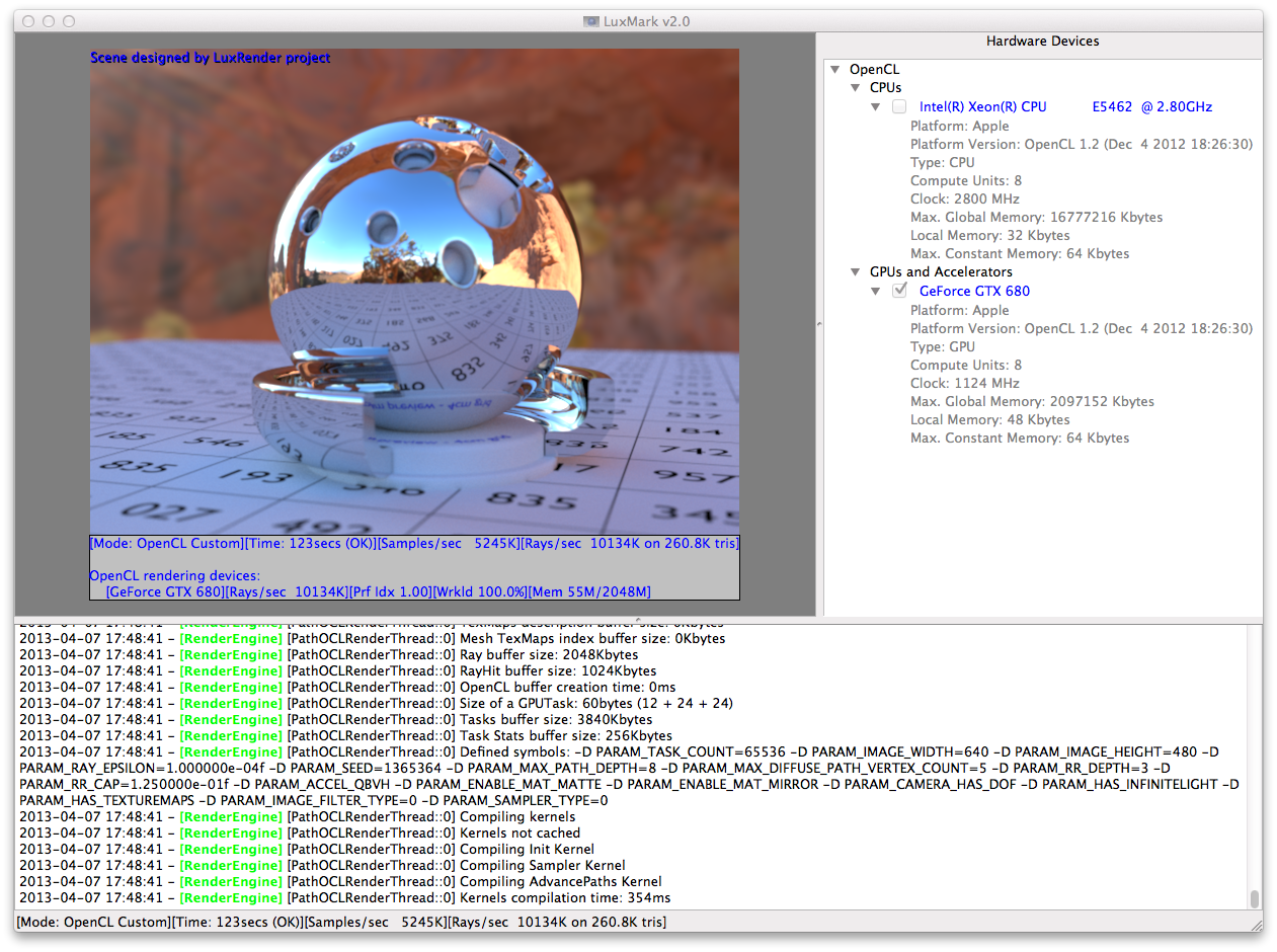

Asked before, but not answered;
According to LuxMark my EVGA GTX680 "only" has 8 compute units in 10.8.3, and I think that was higher in 10.8.2. Also my LuxMark score is abysmal.
Is this a driver issue, and we're just waiting for the NVIDIA driver, or do I have a faulty setup?
The number of compute units before was 32, which was wrong. 10.8.3 correctly reports that now.
What was your score in LuxMark (what scene?)
Hi omnius,
My LuxMark test was on the medium scene, and the score was a terrible 776...

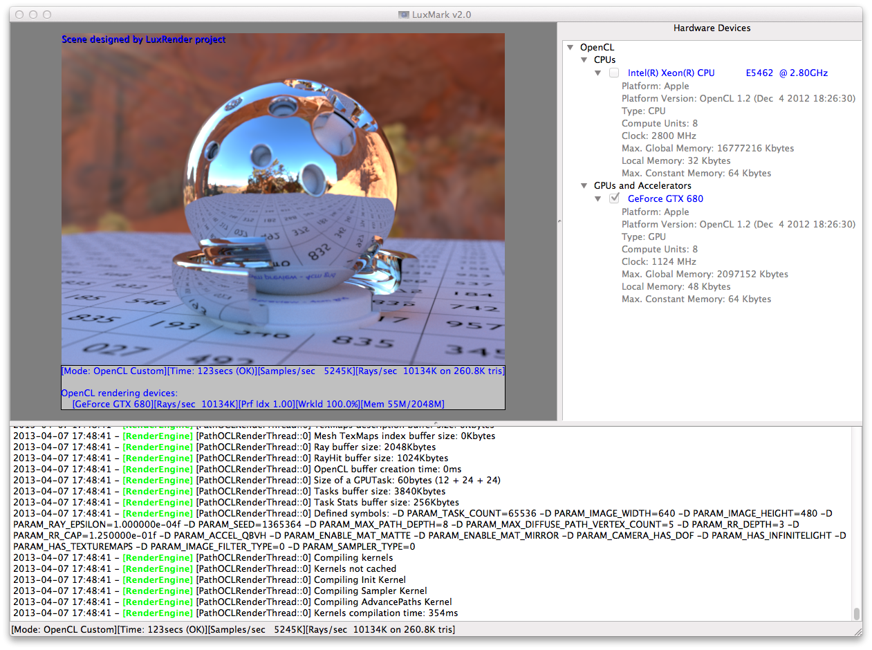

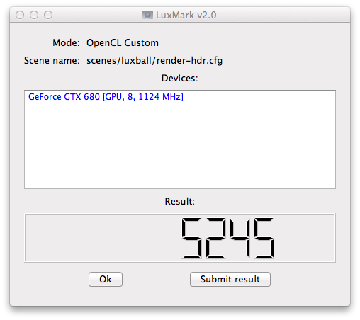

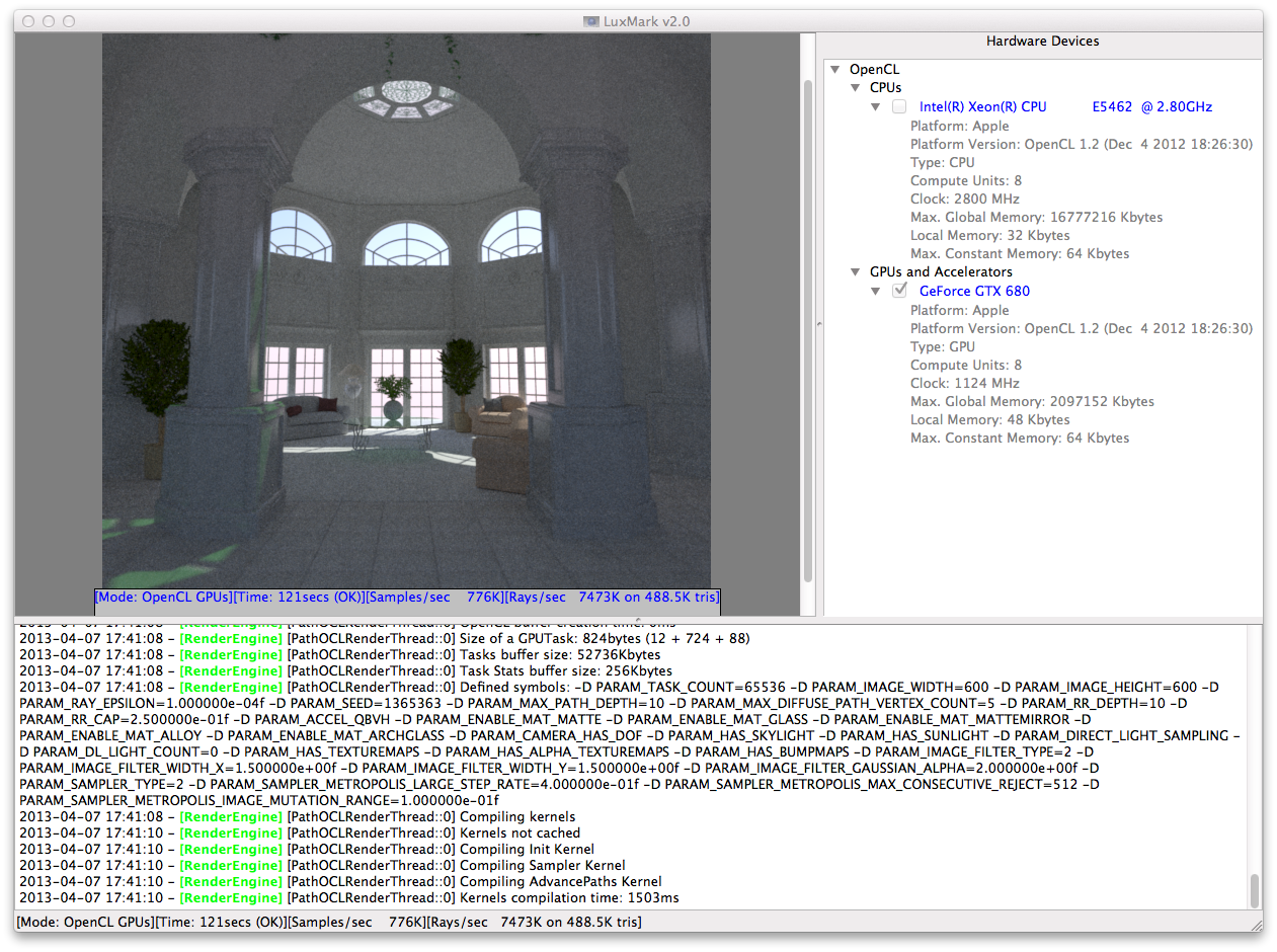

With the small scene it get's better, but...

Hi omnius,

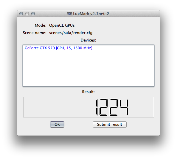

Huh, that's really bad. My GTX 570 scores around 1150.
Average score for the 680 in the Luxmark database is 1418, although it ranges from 1191 to 2011.
Maybe other 680 owners can post their scores, so we might get a better feeling what the "right" value is.

Hi omnius,
In the first screen shot I posted you can see I ran the Sala test (medium scene) and got 1211. That was in Lion 10.7.5 with a PNY GTX 680 4GB and default clock.
I just ran the test in Mountain Lion and the score was 732. The drivers in the system are default 10.8.3 ones 304.10.65f03.
Not sure what to think of this. I already know that Mountain Lion, as well as Lion, are steaming pieces of turd when it comes to Operating Systems so I'm not surprised at all at the lousy scores. :)
