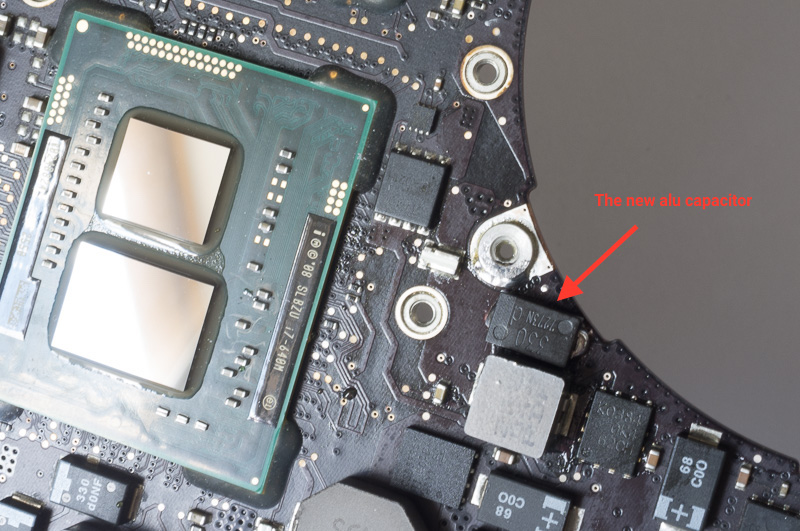

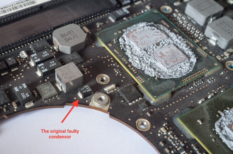

Guys, do not worry too much about software hacks, just solder in a new capacitor and you will be fine! I got the unused capacitor from Volker (many thanks btw!) to do that, and GPU switching is working again ever since (including Cinebench and External Screen). Still to be seen whether it reverts to faulty state later on: I had the GPU und Video ram replaced last year as this was the suggested fix then- only to find that it reverted some 2-3 months after the replacement to the faulty state again. Probably the heat of re-soldering temporarily "fixed" the capacitor or so. But anyway, I am optimistic now.
Many thanks to all who found out and have been testing these fixes. Our machines are far too good to be thrown away. And to be thrown away because of this ridiculously cheap capacitor - this is the sad part of the story. Some geeks fix it - the rest is going with workarounds or just buy new. Sad enough, Apple, that you never found out the real cause(s) for the GPU mess with the (but not only the) 2010 MBP 15, or did not bother to let us know, and that you never had the cool to just say, hey, it is just this crappy capacitor and we will fix this for you anytime for free. Because this is what I would expect from the most profitable company on earth selling really great products.

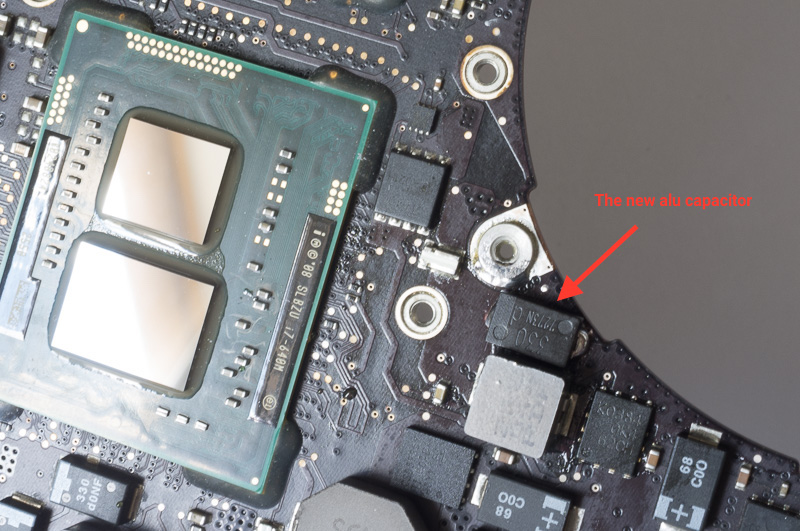

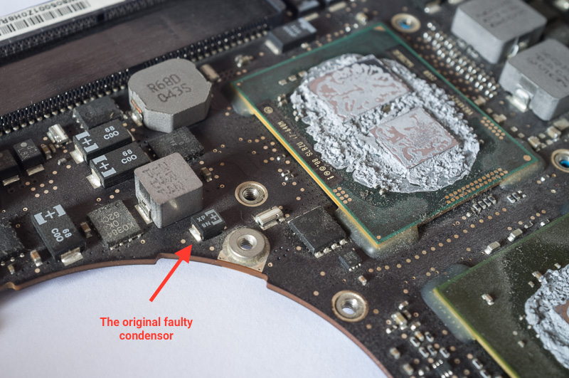

Had the same issues with my 15-inch Mid 2010 machine. The repair extension program had since expired and because the machine had entered vintage status, replacement parts were no longer available.
I'd already bought soldering tools to repair a Mid 2009 MacBook Pro, so I decided to have a shot at changing the troubled capacitor. Problem solved. Not the easiest repair in the world but it would be a straightforward job for an electronics repairer or anyone skilled with a soldering iron.
This would be the better solution for anyone that isn't content with a temporary software fix, boots between multiple operating systems or needs the use of the higher powered graphics hardware.

Just wanted to provide an update for my mid-2010 i5 15" MBP.
I had the capacitor replaced with an aluminium capacitor for $76 CAD. Before I left the shop, I ran the cinebench 15 test with a clean installation of 10.12.6 and it finished without any panic.
I'll test it over a few days but I think the MBP will be good for a couple of more years.
I actually bought this i5 MBP for parts but decided to try and make use of it since it did boot and everything worked. I was happy until I discovered the panic issue. I bought it for $65 CAD without a charger and hard drive. Add in the cost of the capacitor replacement and the total cost was only $141 CAD. A bargain in my opinion for a functional mid-2010 15".

I just replaced my Cap, (the kext solution did work, but somehow re-setted once in a while and I had to re-apply it).
The following Cap was used (requires scratching the PC board a bit) and seems to work well so far, zero crashes
https://www.digikey.fr/product-deta...c-components/EEF-CX0D331R/PCE4275CT-ND/816445
It was a bit difficult to get the old Cap off, be sure to use a solder iron that can heat up well and don't use a tip that is too small. I also added some more solder to both sides of the old Cap, this helped to maintain the heat while switching quickly from one contact to the other to keep the solder points liquid.
At the same time I did a nice clean out of the whole board as well as replace the thermal paste on the CPU and Graphics chip, Apple really did a terrible job!!
I live in France, if anyone in surrounding countries wants a Cap, let me know, I had bought a few.

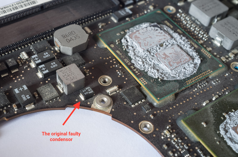

On the left the original Cap and poor thermal paste job - on the right, replaced bigger Cap and cleaned CPU.
I hope the machine will remain stable over the long run, will report back if issues.... :)
A BIG THANKS to the community and especially Fabio Roberto for all the help!

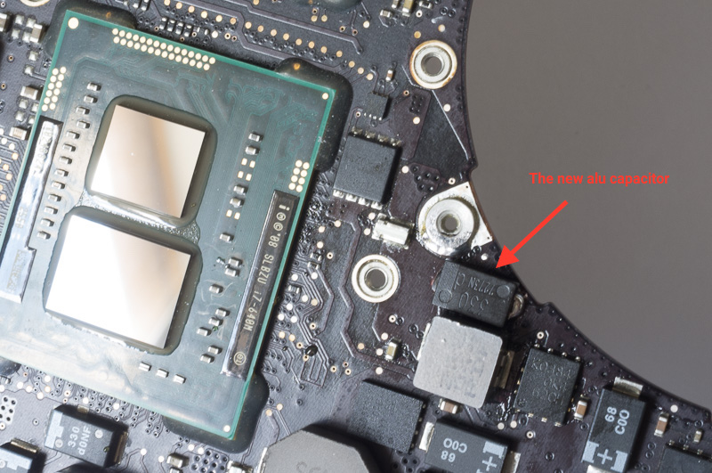

I've successfully soldered a new capacitor a couple of weeks ago. My machine feels like brand new now!

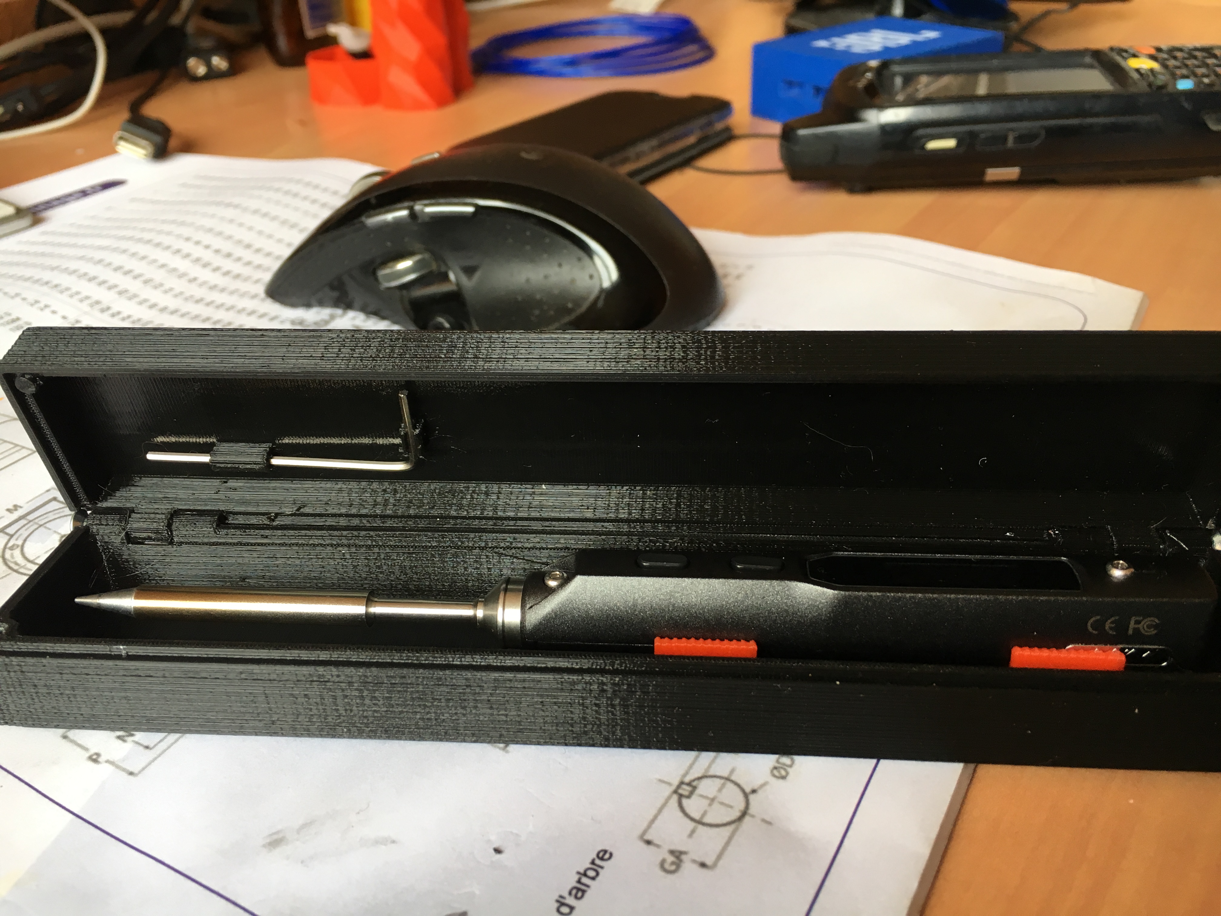

I've done a little bit of soldering as a kid but haven't really touch it for 15 years or so. I used a classic soldering iron with a fairly small tip. It belongs to a friend, he bought it for quite cheap on Banggood.
I went with the Panasonic EEFSX0E331XE I bought on Distrelec. They shipped it for a descent price considering their Chinese or United States counterparts (I live in France).
I'd say the difficult part was to remove the old capacitor. I had to heat it for a bit as it was well soldered on the motherboard. Scrapping the track to make room for the bigger capacitor was easy with a tiny flat head screwdriver. I had some flux spread at all time but it's the first time I were using it. To be honest, I'm not sure how much of a difference it makes.
Finally, As shown on other's motherboards, the original thermal paste job was really crappy and it ended up drying off after 6 or 7 years. I cleaned it up with isopropyl alcohol and applied a fresh one before re-assembling everything together.
I've ran Cinebench three times and have been using it quite intensely on Netflix and internet browsing. It's frequently plugged on a second screen and it hasn't failed on me so far. Before the fix, it would crash within the first 5 minutes after being swithed on (most of the time, I wouldn't have the chance to even launch apps like Chrome or Safari).
