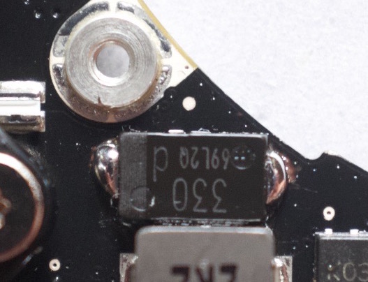

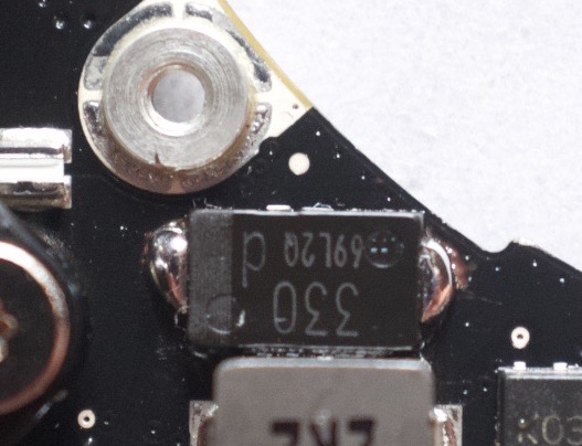

Hi, UK-based 2010 MacBook Pro rebooting-due-to-to-GPU-kernel-panic long-time sufferer here.. something I'm unable to avoid via any software tweaking as the machine is permanently connected up to an external monitor.. used to happen every so often though now seems to be happening several times per day.
Very interested in the replacement capacitor fix - can someone please confirm the precise recommended capacitor I need to buy? The following two Panasonic models recommended appear to be the most frequently recommended: EEFSX0E331ER and EEFLT0D331R, then there's also the EEFCX0D331R, EEFSX0E331XE and EEFSD0D331MR - what's the difference between these various options and, most importantly, which is optimum for this fix?!
Thanks.
Hey bro, I got this one from UK ebay
Cap ebay
fabioroberto, one of the most important guys in this thread, who found the software fix, told me this is one of the good ones for the job. Plus, it has 2 positive lines, so it’s possible to use one of the lines without scraping the board, which I prefer. Haven’t installed mine yet, time, skills issues LOL.
Go for it, man.

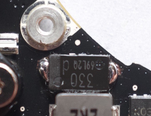

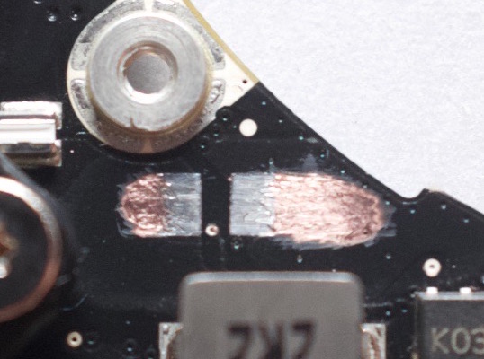

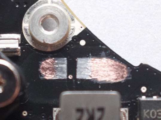

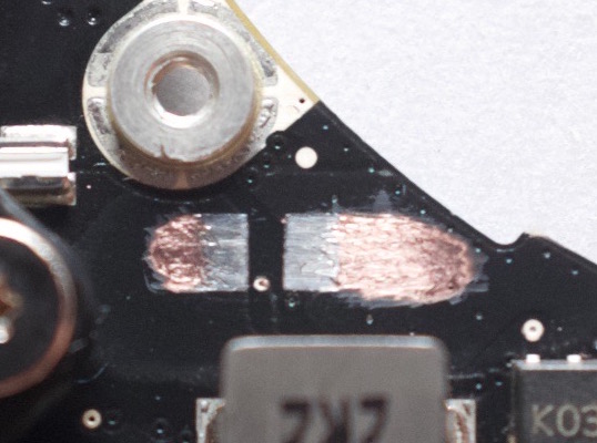

It is a good capacitor. Correction: 2 negative lines.
it has 2 negative lines, so it’s possible to use one of the lines without scraping the board, which I prefer.
Well, this is only possible if you use an hot air station to solder the capacitor.
If you use a soldering iron, you'll be unable to solder the central pad properly.
So you will have to scrape the board to solder the negative pad at the tip of the capacitor.
And if you use a soldering iron, I recommend to scrape also the positive pad of the motherboard by a few millimeters, it does help to solder the positive pole of the capacitor properly.
View attachment 715467View attachment 715468
Good to know, bro. Thanks for the advice.
Planning on get my MBP fixed, so I'll ask to a friend o'mine who has some good equipment and experience if he has the blower so I can fix it properly.
Thanks again.
This new video from L.Rossmann shows how the "large" size capacitors with two negative pads can replace the "small" tantalum capacitors, without having to scrape the board.
This fix if not for the 15" Mid-2010 Macbook Pro, but the capacitors used are the same.
Again, this only works if you use an hot air station to solder the capacitor.
If you use a soldering iron, scrape the board on both the positive and negative pads, and solder the new capacitor by using its ends, not the central pad.
