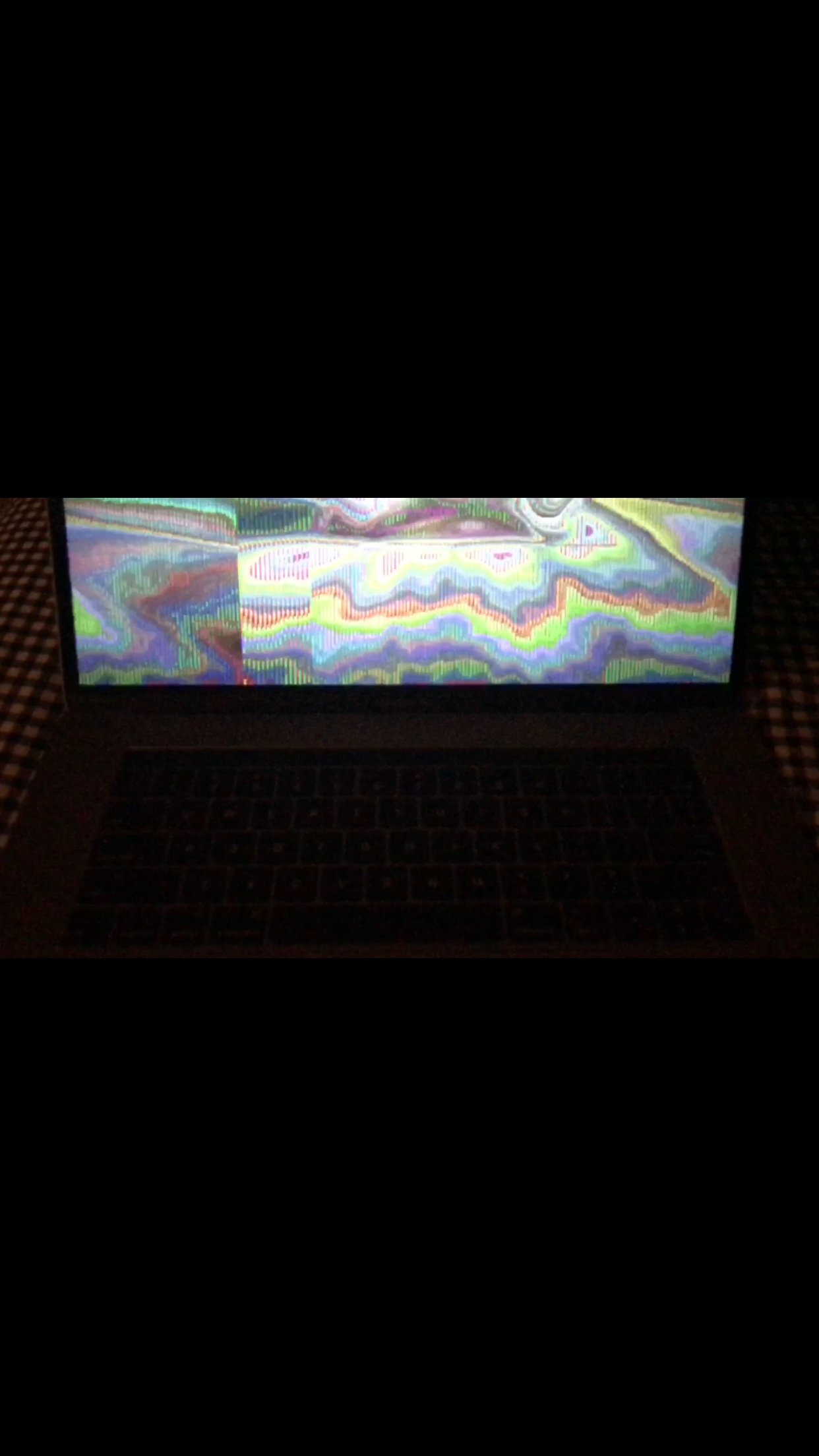

I have a thread , see attached pictures, I have an appointment tomorrow with the Genius Bar.
The guy at the Genius Bar told me to order a new one. I will give mine back when that arrives. In the meantime I will not use the software that causes the problem (Adobe Media Encoder)
