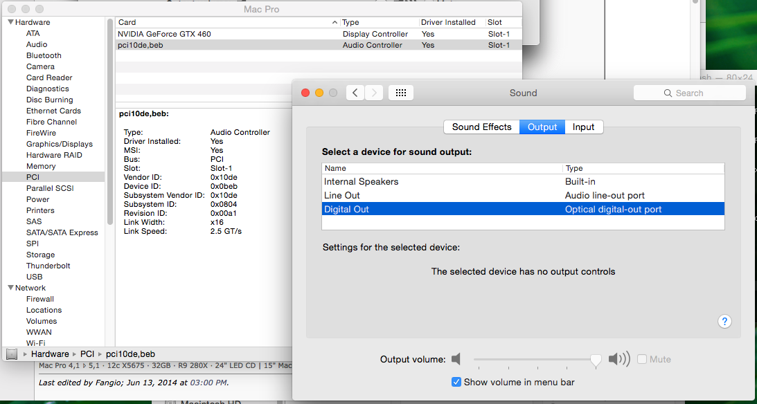

Hi guys I've used 1.1 version and system information I see audio controller, but with weird name "pci10de,beb" and now HDMI under output tab in sound window. Does anyone know how to sort this out? Thanks in advance.
attachment.php
