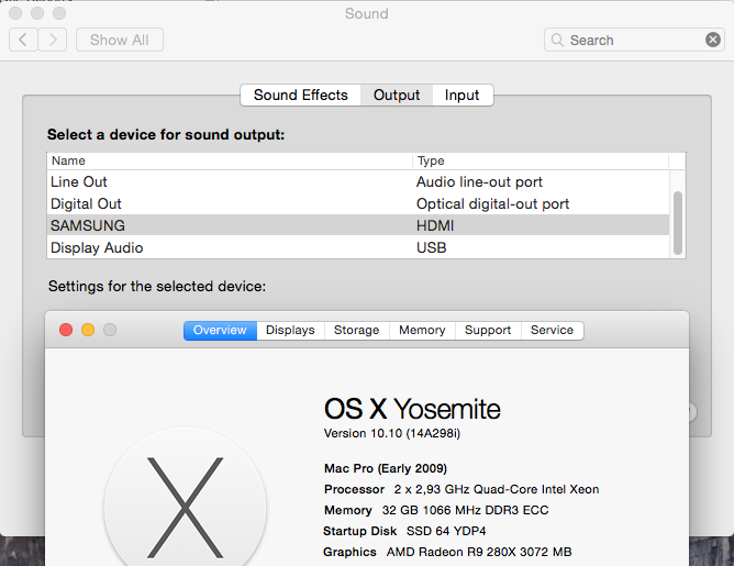

HDMIAudio 1.0 now works in DP4 without kext-dev-mode=1.
Console / all messages filtered with "hdmi"
Code:
25/07/14 08:37:28,000 kernel[0]: HDMIAudio: Found 0x1002aaa0 on PXS1
Can anyone with the public beta confirm that?

[url=http://i268.photobucket.com/albums/jj35/MacFangio/Apple%20Stuff/GraKa/AMD%20Radeon%20R9%20280X%20Mac/DP4ampHDMIAudio10_zps69e6c931.png]Image[/URL]
I have not been using kext-dev-mode=1 since DP1 and have been using HDMI audio just fine. That was only needed when Chameleon hadn't been updated to r2380.
