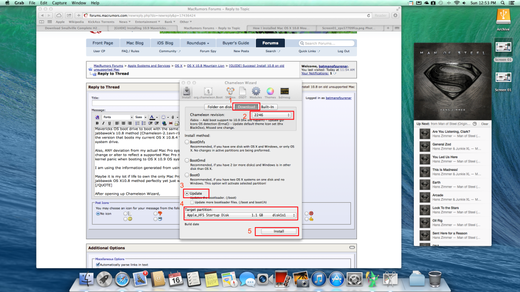

After opening up Chameleon Wizard, make sure the "Download" tab is selected. click on the drop down box next to "revision" and select "2246", hit update (If you have an older version of chameleon installed), select the drive chameleon is on, then hit install.
The version of chameleon I used is "revision 2246".

Got it I am in Chameleon Wizard now....
just to clarify...you used a both a "mach_kernel" as well as a "boot.efi" file that are different/modified and/or hacked alternatively to the "stock" files present/found in the OS X 10.9 Mavericks .dmg ?

got it. By the way thank you for exchanging and the mutual dialogue with me. In this zip file there appears to be only the "mach_kernel" file. A short while ago you mentioned an alternative boot.efi file you used. Is that no longer the case or do you happen to perhaps recall where you acquired that ?
You're welcome ;) . It should be in there with the "mach_kernel" file, plus with 2 kext files and a chameleon installer (The kext files and chameleon installer aren't needed)
EDIT: ***** it - both files, if it's against the rules I'll be happy take it down. http://sdrv.ms/19GLlAc
When I unzip it, the folder only contains four (4) files. The chameleon installer, the two (2) "hack-type" kext files as well as the mach_kernel. Am I missing something or is it possible that is has been removed ? Might you or someone else trying unzipping the file and report what the are getting ?
Got it. Do you recall regarding the "boot" file if you also dropped it into the root of the OS X 10.9 Mavericks install.dmg along with the mach_kernel or did you place it in a different location ?
I dropped it in the root of the Installer Disk. I also dropped "mach_kernel" into "Macintosh HD" after finishing the install. You may not need to, but I got KP a few times during boot without it.
