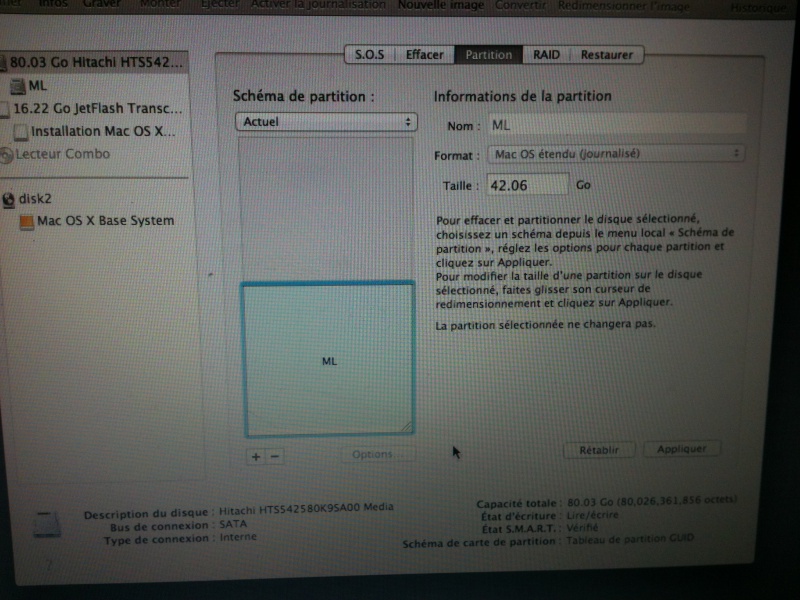

FYI guys I deleted the useless Lion partition (I was in dire need of space) but unfortunately it seems impossible to fusion the free space into the Mountain Lion partition so you'll ended up with 2 partition instead of 1, see for yourself:
I think you can click on the ML partition, and change 40 to 80 so that the partition getting resized from 40gb to 80gb. Than click apply. Hope this helps.
