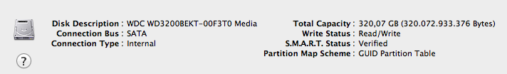

Hey,
After a long time (about few weeks), trying unsuccessful installation MLPostFactor, I now know that I have tried all possible solutions, and I always get the same result.
I followed all your instructions, but I always get the install partition which is big approximately 1 GB when MLPostFactor Installer succeed, and it has that data:
Uploaded with ImageShack.com
I have:
• MacBook 4,1 (320 GB HDD, 4GB RAM)
• 10.8.4 legit appstore app in Application folder (copied from ML compatible device, legally purchased)
• disk0s4 installer partition (20GB) - empty
• disk0s5 ML partition (143 GB) - empty
• disk0s2 Lion (active) partition (153 GB)
• MLPostFactor V0,3 in Applications
The whole disk sheme looks like this:
Also, yesterday I formatted the whole disk and installed OSX Lion system.
I tried to change the place of the Install partition with disk0s4 or disk0s5. It did not help.

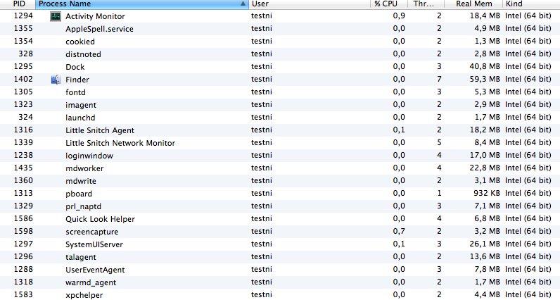

I killed absolutely all applications except LittleSnitch (also removed everything from startup apps; even created another user account)…
There are only active these processes:
Disk partition scheme is GUID, and I have also repaired the permissions... (for everything I can):
Uploaded with ImageShack.us
Each time the installation “succeed”, I see that this is attached in a Disk Utility:
It is located in: Install OS X Mountain Lion> (show package contents)> Contents > SharedSupport
When I mount it I see another installer app. Also tried to run it (it says that I have unsupported computer), and then re-run MLPostFactor. Now, I opened the log of osx installer. I’ve notieced this:
Jul 31 14:57:33 macbook installd[1143]: ./preinstall: cp: ./Dats/MLPostFactor.app: unable to copy extended attributes to /Volumes/Install/Applications/Hack: No such file or directory
(and lot of that…)
Also, there is hidden image called BaseSystem.dmg, when I tried to mount it, and re-run MLPostFactor. The installation partition in now about 2 and half GB great. When tried to reboot I see EFI32, but after apple and spinning wheel I got: There was a problem installing “Mac OS X”. Try reinstalling.
Logical, because it is half of system.
So, it must be something with mounting InstallESD.dmg (inside the appstore app)because MLPostFactor only installs the drivers
Any idea?
[url=http://imageshack.com/a/img594/1741/tik9.png]Image[/URL]Uploaded with ImageShack.com

My one thought is that Little Snitch is NOT compatable with MLPF and the resulting ML install. You should have at least 4.5 gb of stuff in a proper Install partition.

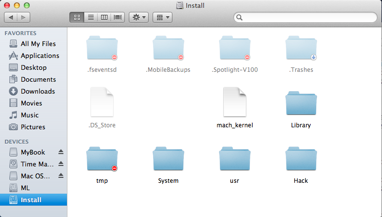

Hi everybody,
it's my first post here. Could you please help me out installing a legit 10.8.4 ML copy? What has already been done:
- purchased 10.8.4 from Appstore (thanks to Parallels)
- downloaded MLPostFactor v0.3 32-Bit from OSXHackers website
- placed the files into 'Applications'
- set up 2 clean partitions (10GB named Install and 20GB ML)
- successfully installed MLPostFactor with files (728.4MB) as follows on the 'Install' drive. It took up to 5 minutes.
Then I tried to reboot my computer with 'option' key held down but no MLPF drive (EFI) came up. What I only get is Macintosh HD or Recovery HD.
I've just tried with a Flash disk. MLPF installed but no EFI disk at startup.
My computer specs: MacBook 13" Early 2008, 2.4GHz Intel Core 2 Duo, 4GB RAM DDR2, GMA X3100, OS X Lion 10.7.5.
Thanks for any suggestions.
