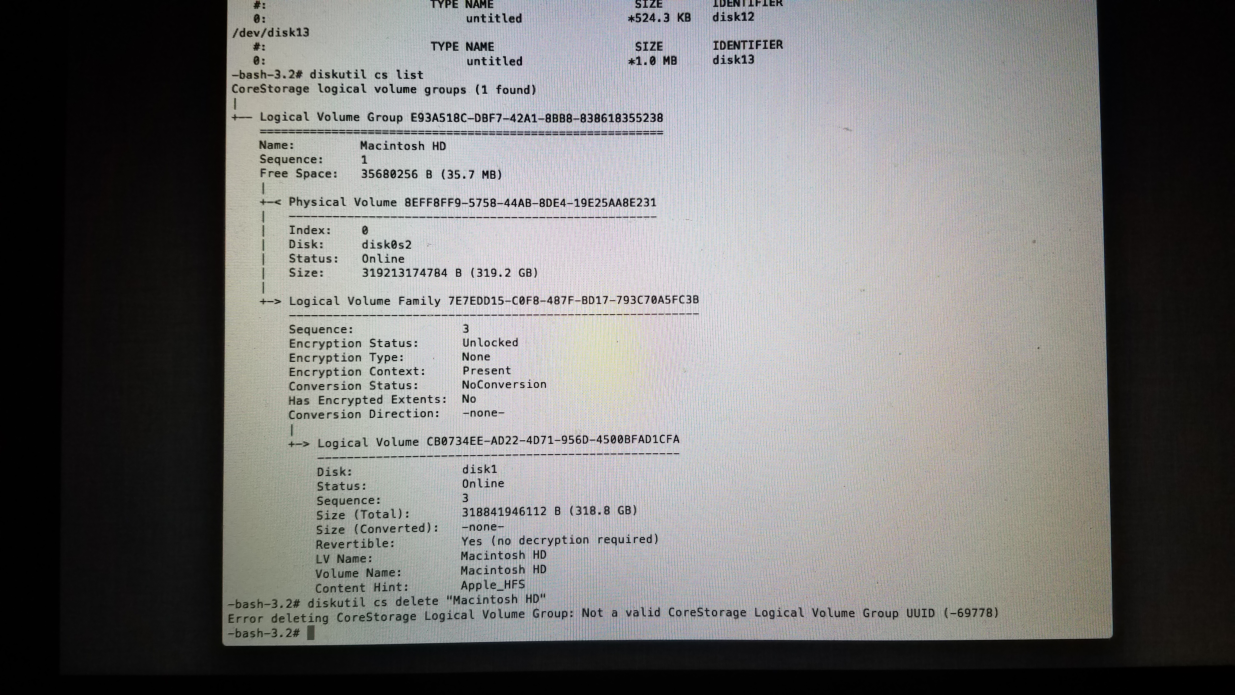

The last thing I have showing is the response from my "diskutil cs list" command. Again, it's all whacky. Could I send you a screenshot?

Also, here's the pic, showing my response from terminal , after the diskutil cs list command... and trying to delete "Macintosh HD" It's currently powered down.

From what you are describing here, it sounds like you have a failed drive. This can also be caused by a bad internal drive cable.

Did the pic of my screen give you any clues as to what's going on?

Short of replacing the drive and cable, not really no. If you want to keep the laptop, it would be worth buying an SSD and new cable and installing those to get it running.
