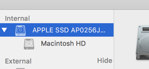

Heyy I NEED HELP! I tried Factory resetting my imac and when i clicked on Disk utility i clicked on Restore instead of erase, when i tried to Download an os from the internet it says its locked like his^^^. I did what you said with terminal but it does not work, it is still locked . What can i do to fix it?
[doublepost=1493422315][/doublepost]
Okay... this will kill it. The issue is you copied my earlier command with Fusion HD in it. I gave the other user that command because that is what his drive was named. Yours is named Macintosh HD so the command is different.

I followed what you told him but my HD says something completely different

[doublepost=1493424871][/doublepost]When i go to Disk Utility "Erase" is greyed out,

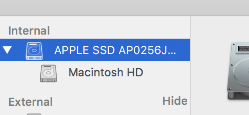

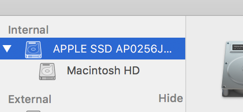

It does not look like you have a core storage volume on there. Start Disk Utility and go to the erase tab, then select the drive itself at the very top of the left column like in my screenshot. Then select Mac OS Extended (Journaled) from the dropdown and apply that format.
You will need to do this from Internet recovery (command-option-r boot)
Thank you so much ! My mac works again, Youre a true hero!

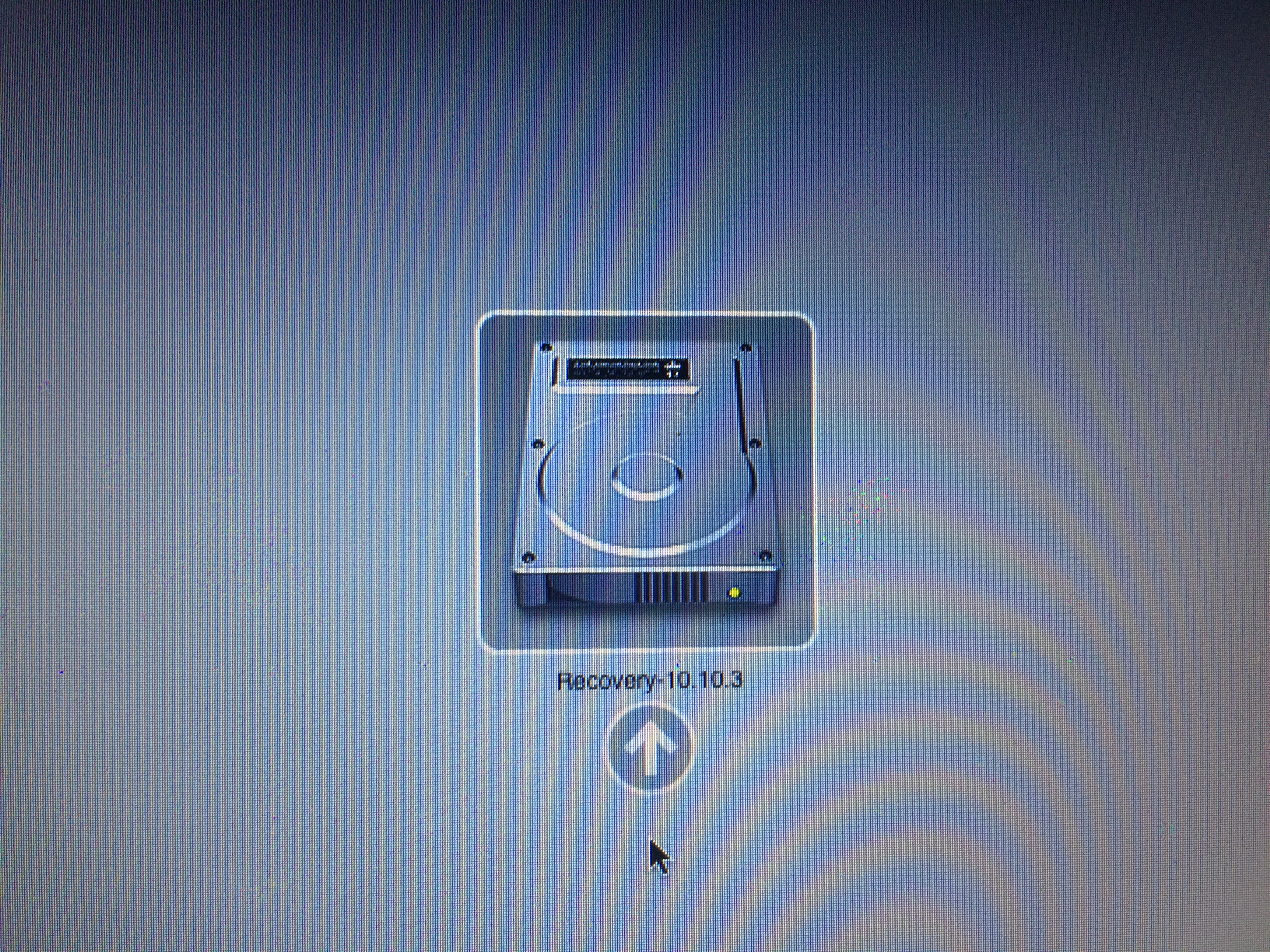

I bought my first macbook pro like a month ago and wanted to reinstall os. It's macbook pro 2009 15" i made bootable flash, format HD and never saw a light of desktop again 🙁 when I try to go for Internet recovery I hold cmd alt r but don't see any globe spinning. My terminal photos
And when I try to boot it with flash plugged in and hold alt key I see only
Thanks in advance
Edit: mbp was running yosemite
You 2009 model does not come with Internet (command-option-r boot) recovery.
Can you command- boot to regular recovery? From there start Disk Utility and go to the erase tab and try to format that OS X Base System partition to Mac OS Extended (Journaled). Then try to reinstall.
When I go to disk utility and try to format or partition it it says that device can't broj unmounted but it is already mac OS extended journaled
It asks me for my iCloud, when I log into appstore to download yosemite it says this item is not available
Have you ever downloaded Yosemite under that AppleID? You will need to use an AppleID that was previously used to install Yosemite.

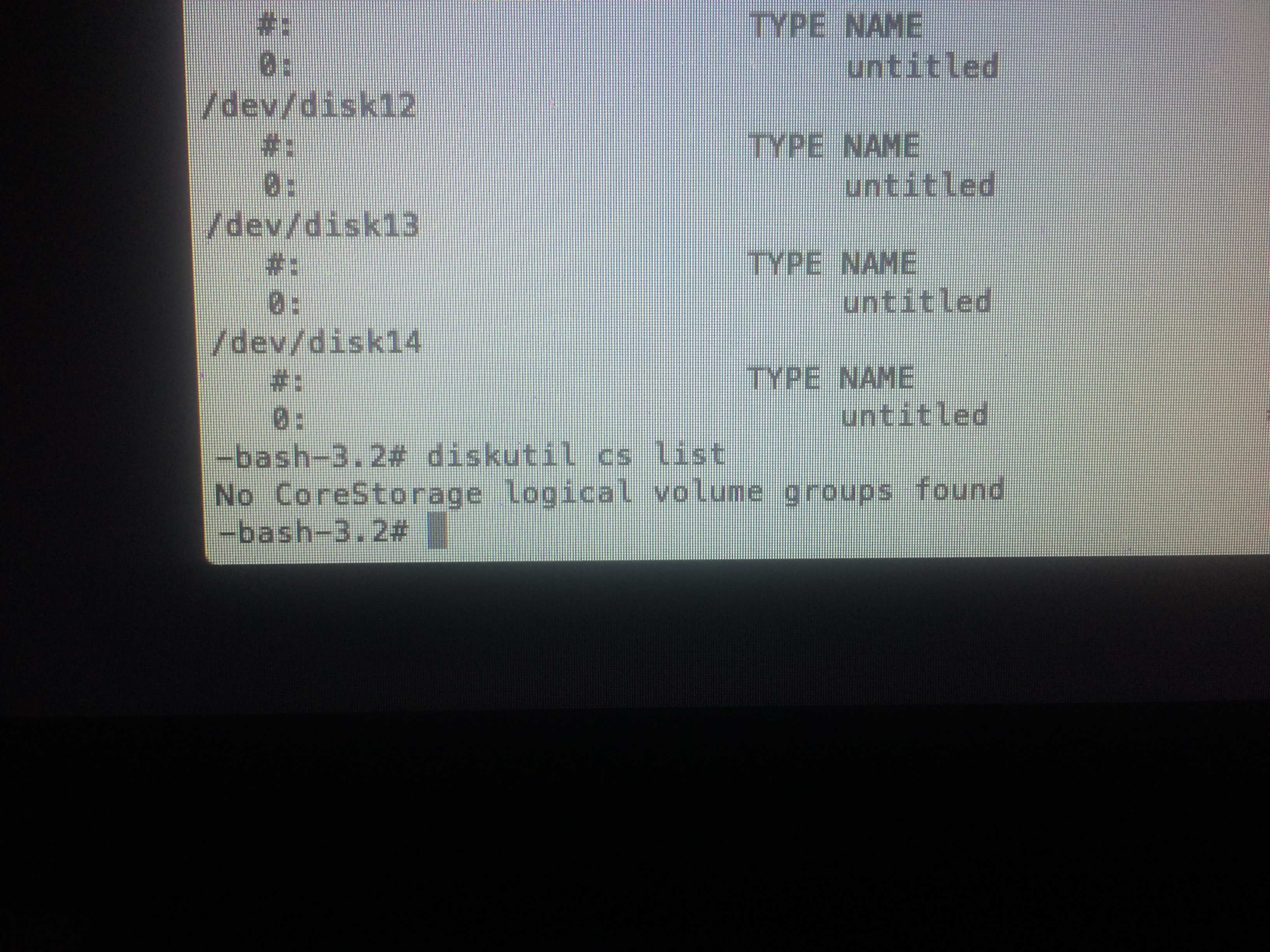

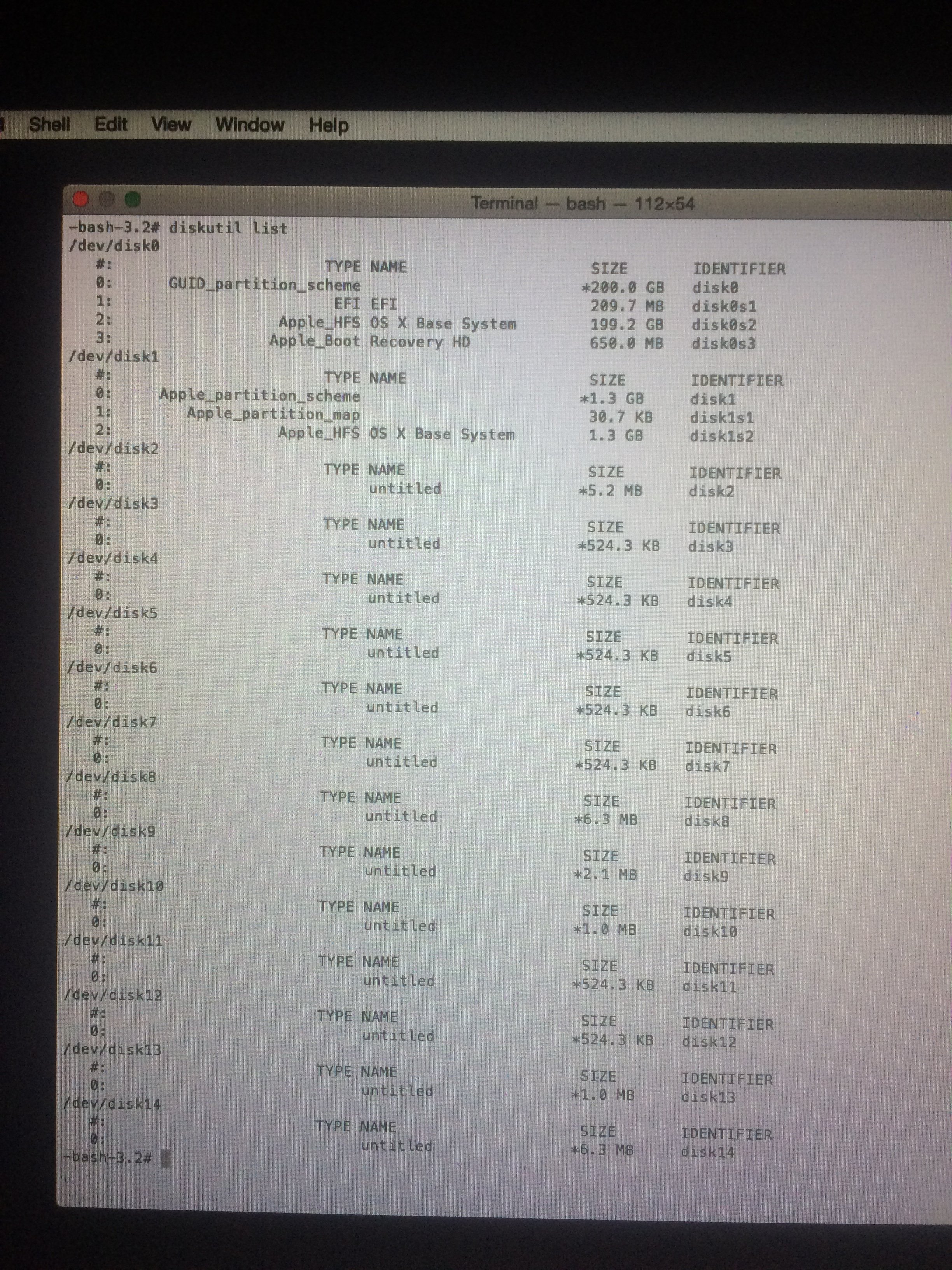

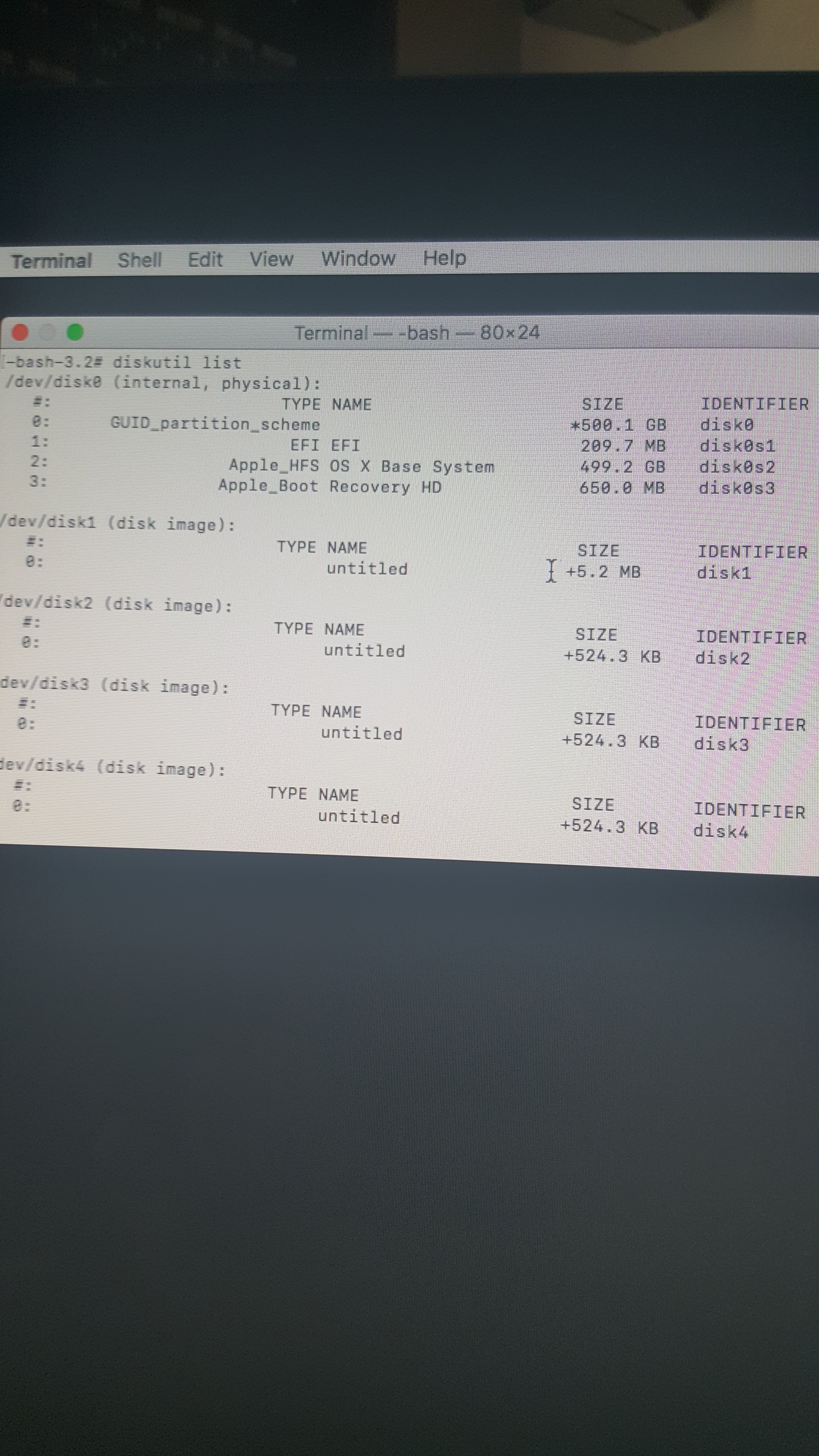

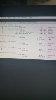

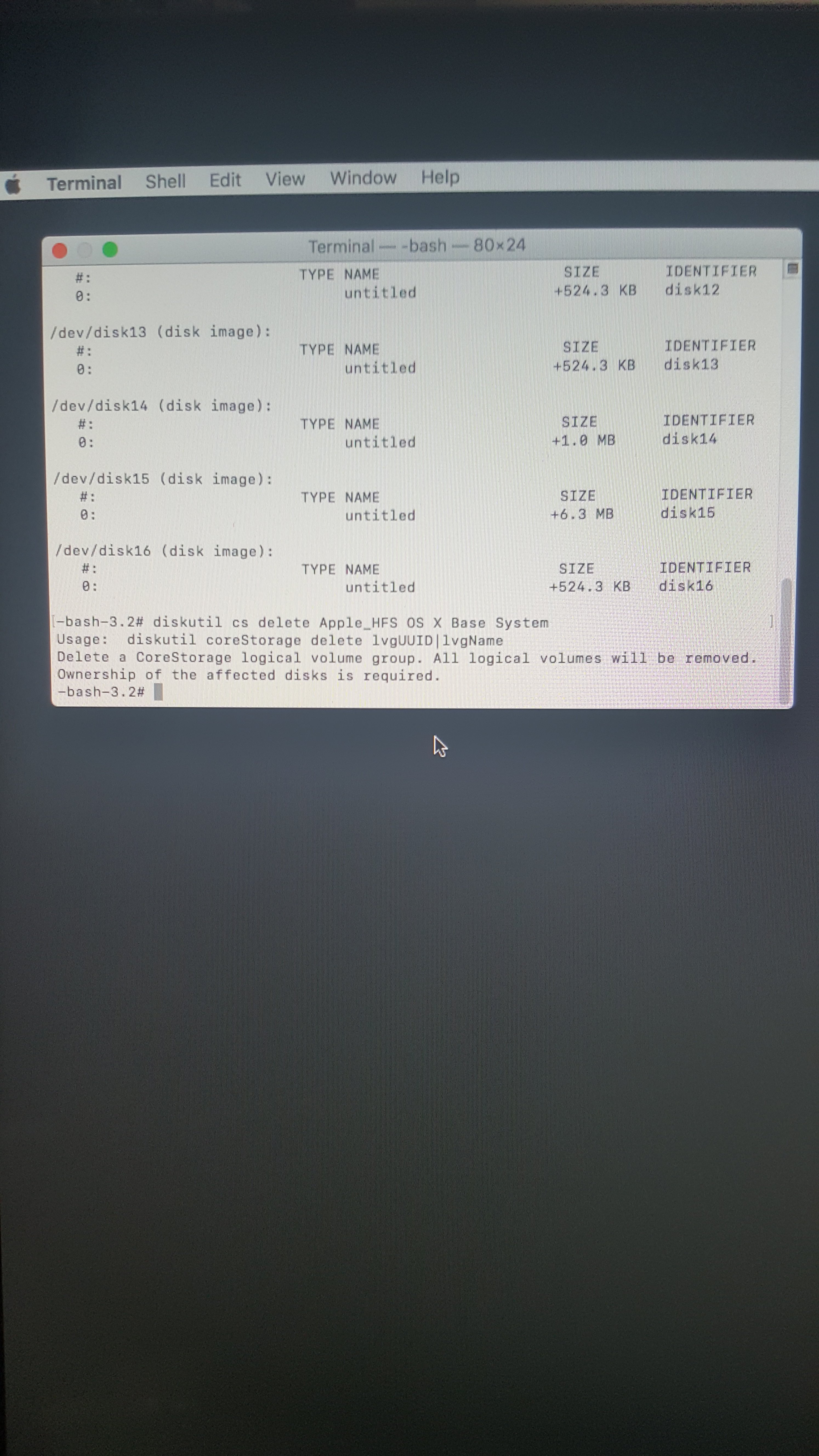

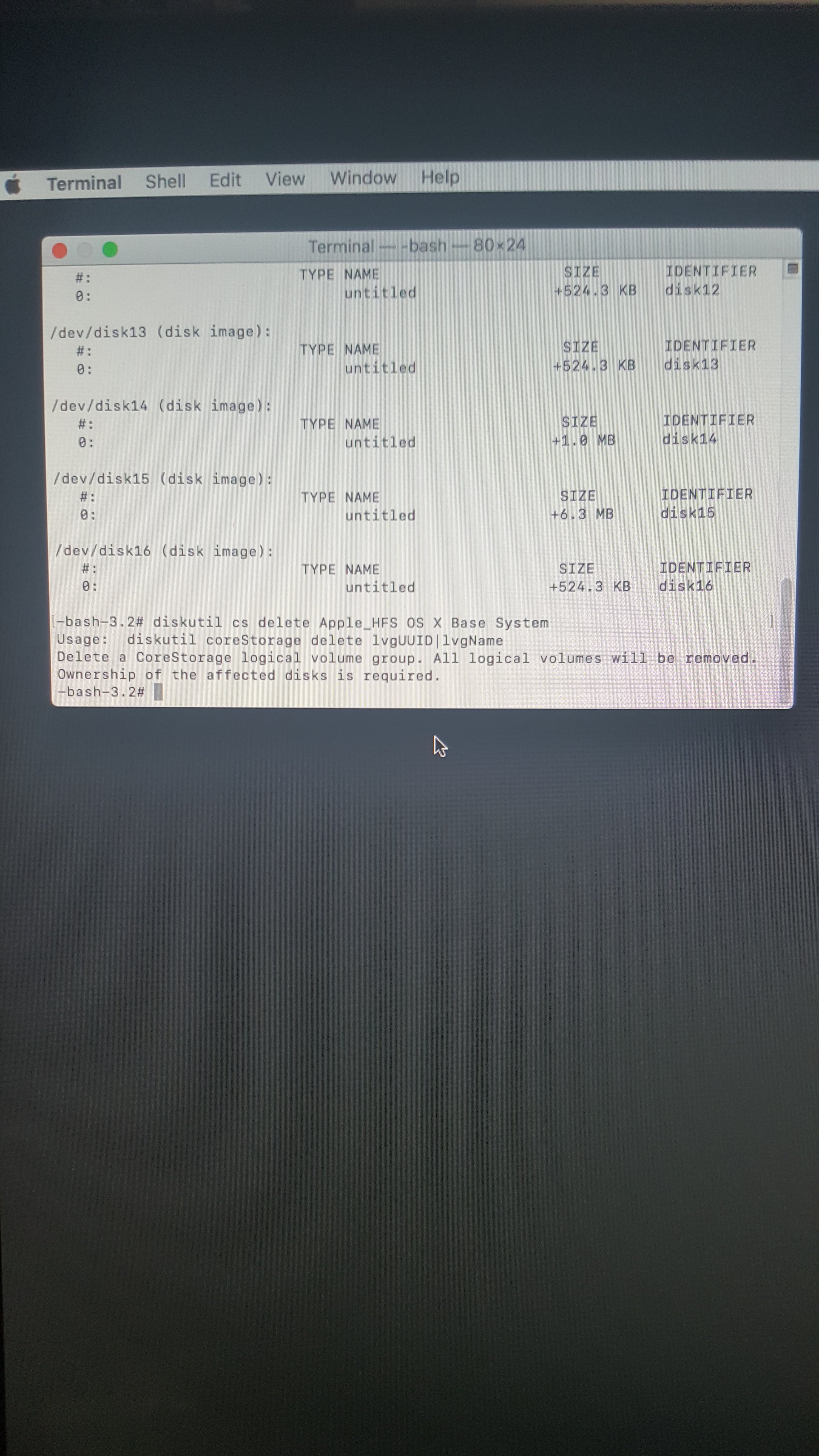

Help! I'm having the same issue where I was trying to reset my computer to sell it. It's a 2011 MacBook Pro 15. I followed some instructions online to erase "macintosh Hd". I did that and went to reinstall macOS. However it's coming up that the disk is locked. I've been trying everything but I don't have many options. I attempted to change the format but it was greyed out. I took some pictures but they won't upload.
Once you get back in recovery, open Terminal from the Utilities menu, then run the two commands below one after the other. Then post the output of each command here so we can take a look.
Code:
diskutil list
diskutil cs list
Code:
diskutil list
diskutil cs list
I did this. I tried attaching the picture but it says the file is too large. Any thoughts?
It looks like somehow you copied the installer onto the main drive, and not you cannot do anything with that drive since you are booted to it.
Tyr getting to Internet recovery by holding command-option-r at boot. Select your wifi then you should see a spinning globe while the recovery utility downloads. Then you will see the recovery screen. Now use Disk Utility to erase the entire drive then try to reinstall.
It showed the spinning globe and said internet recovery but after about 10 minutes this popped up. I tried shutting it down and doing it again but it popped up right away
