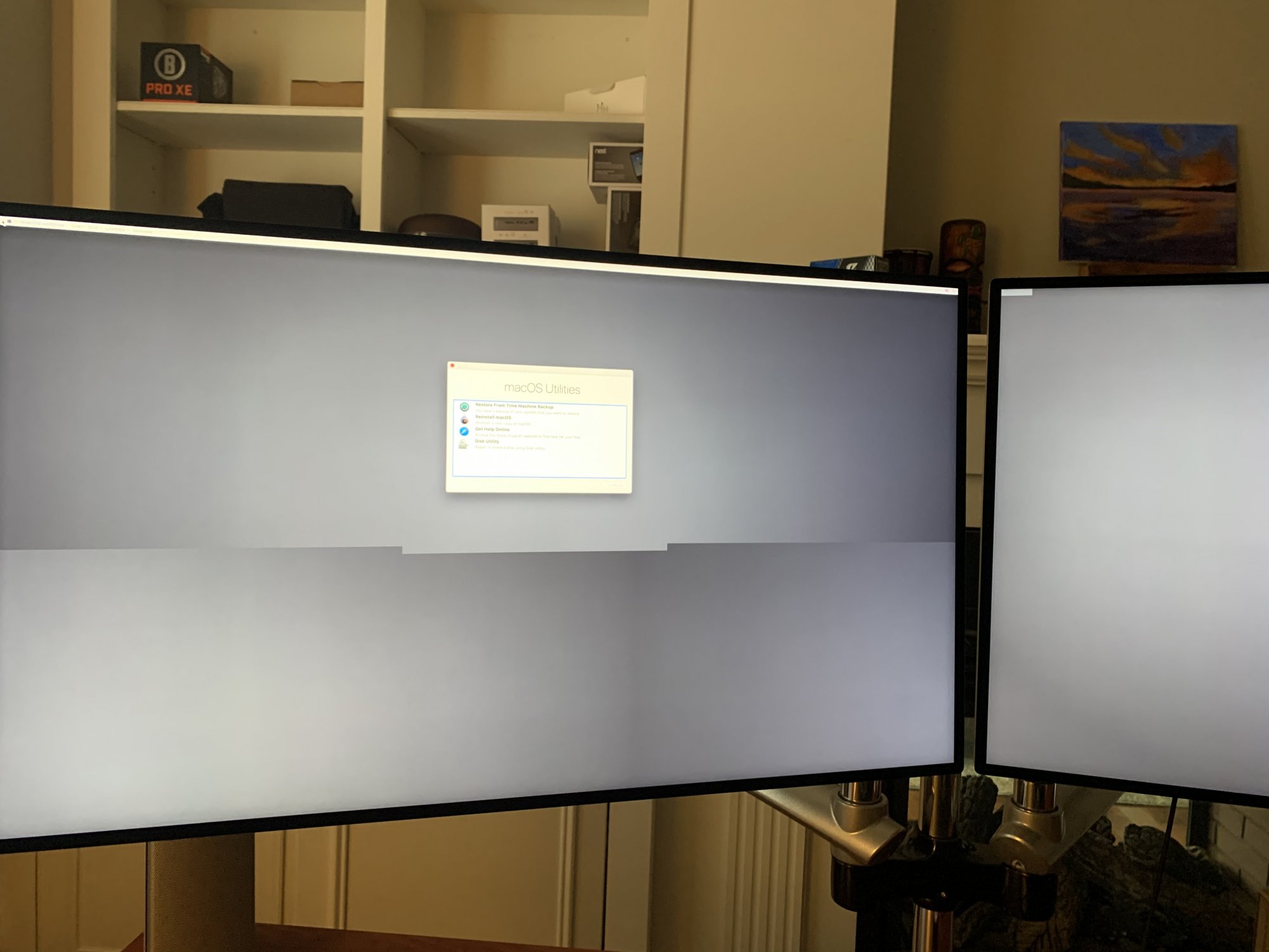

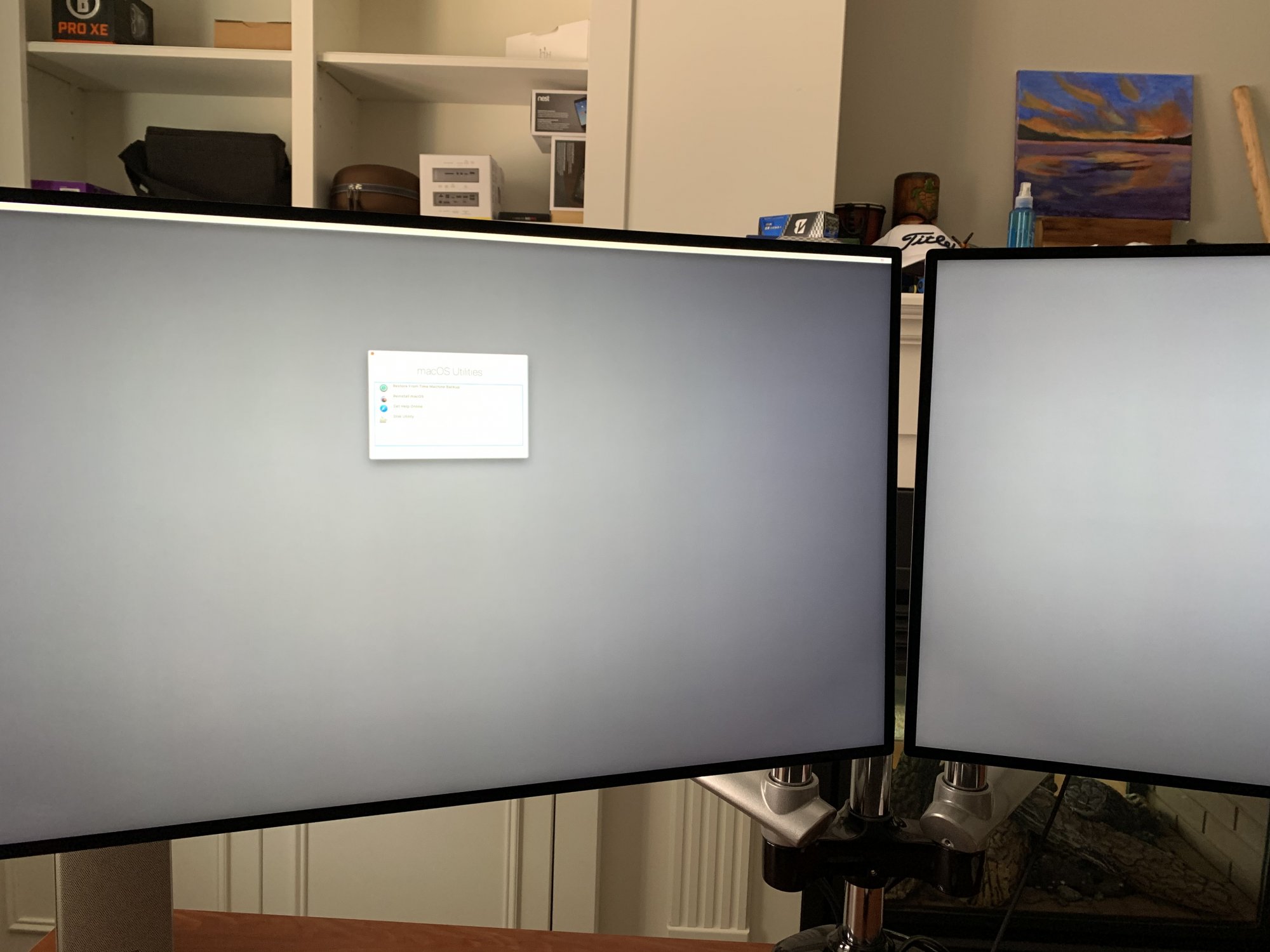

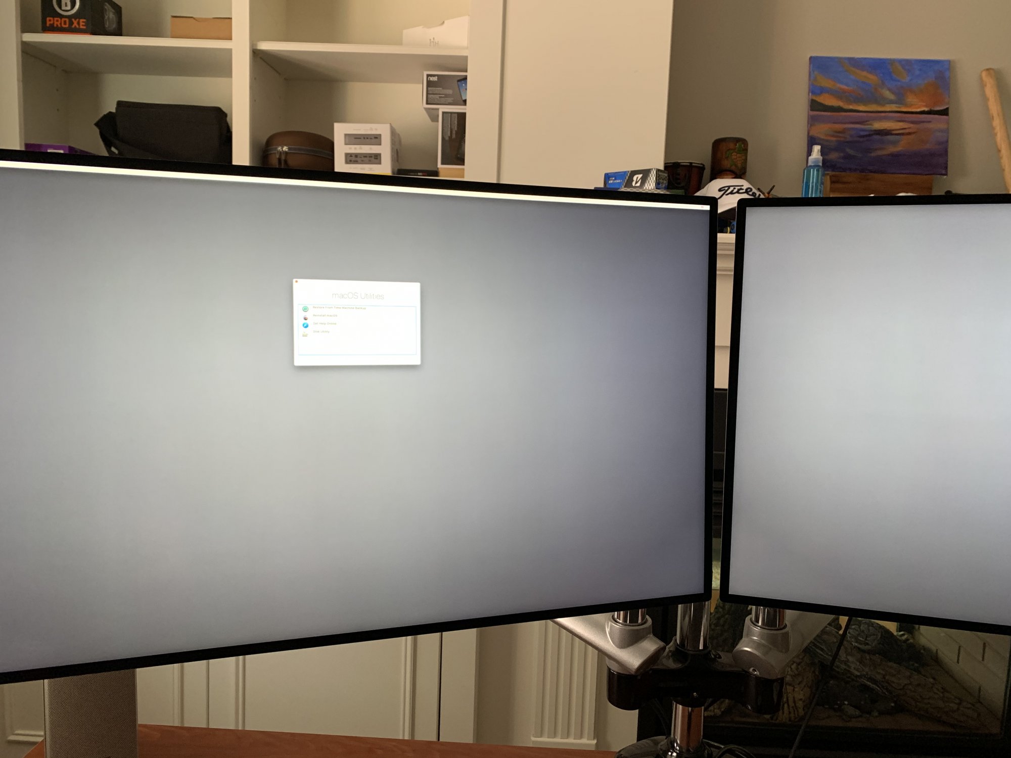

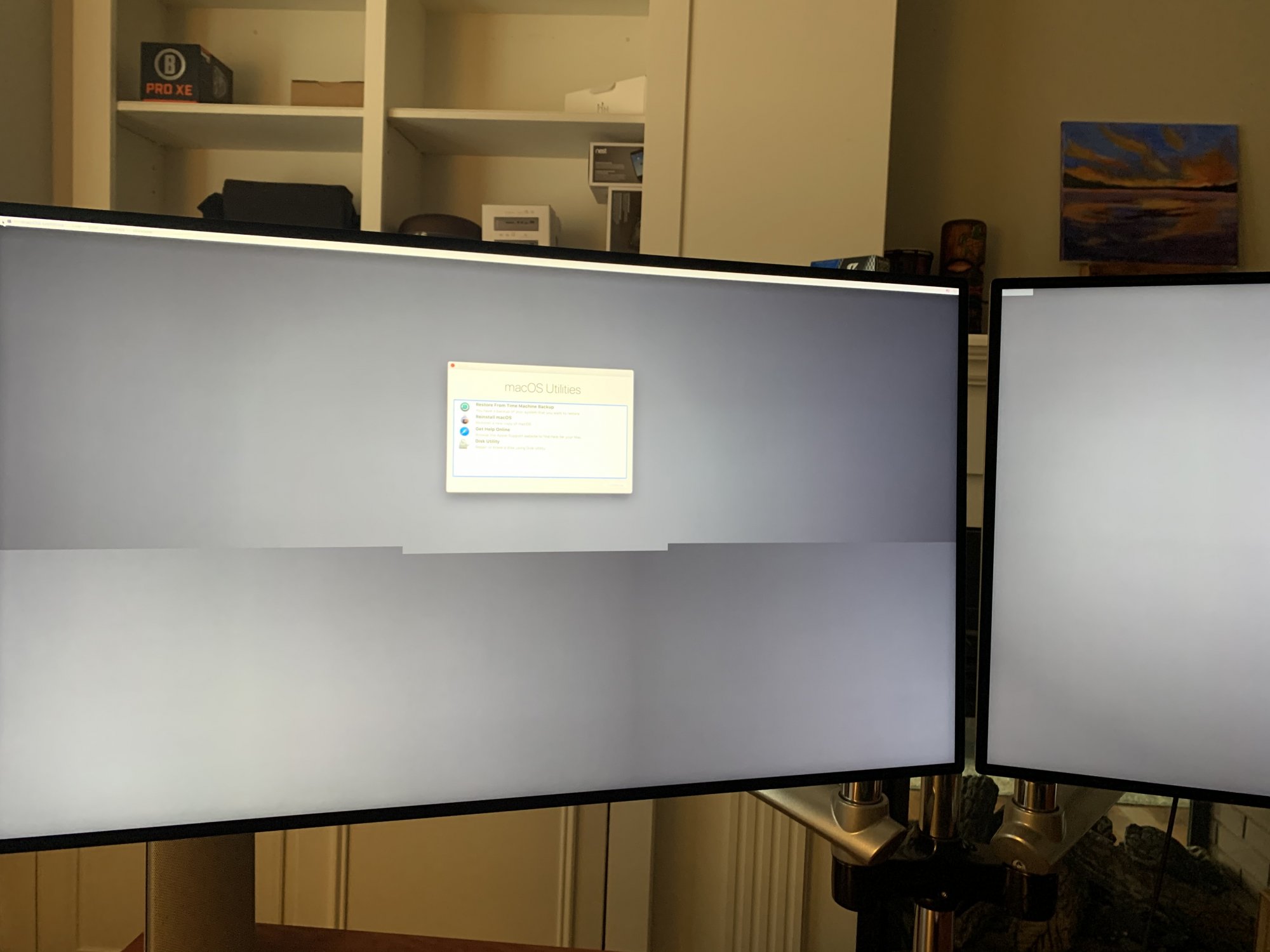

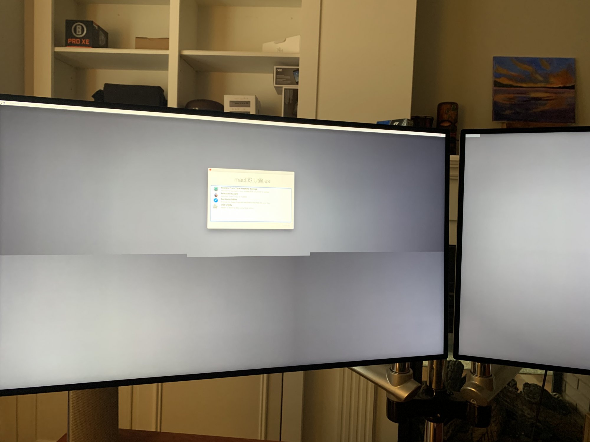

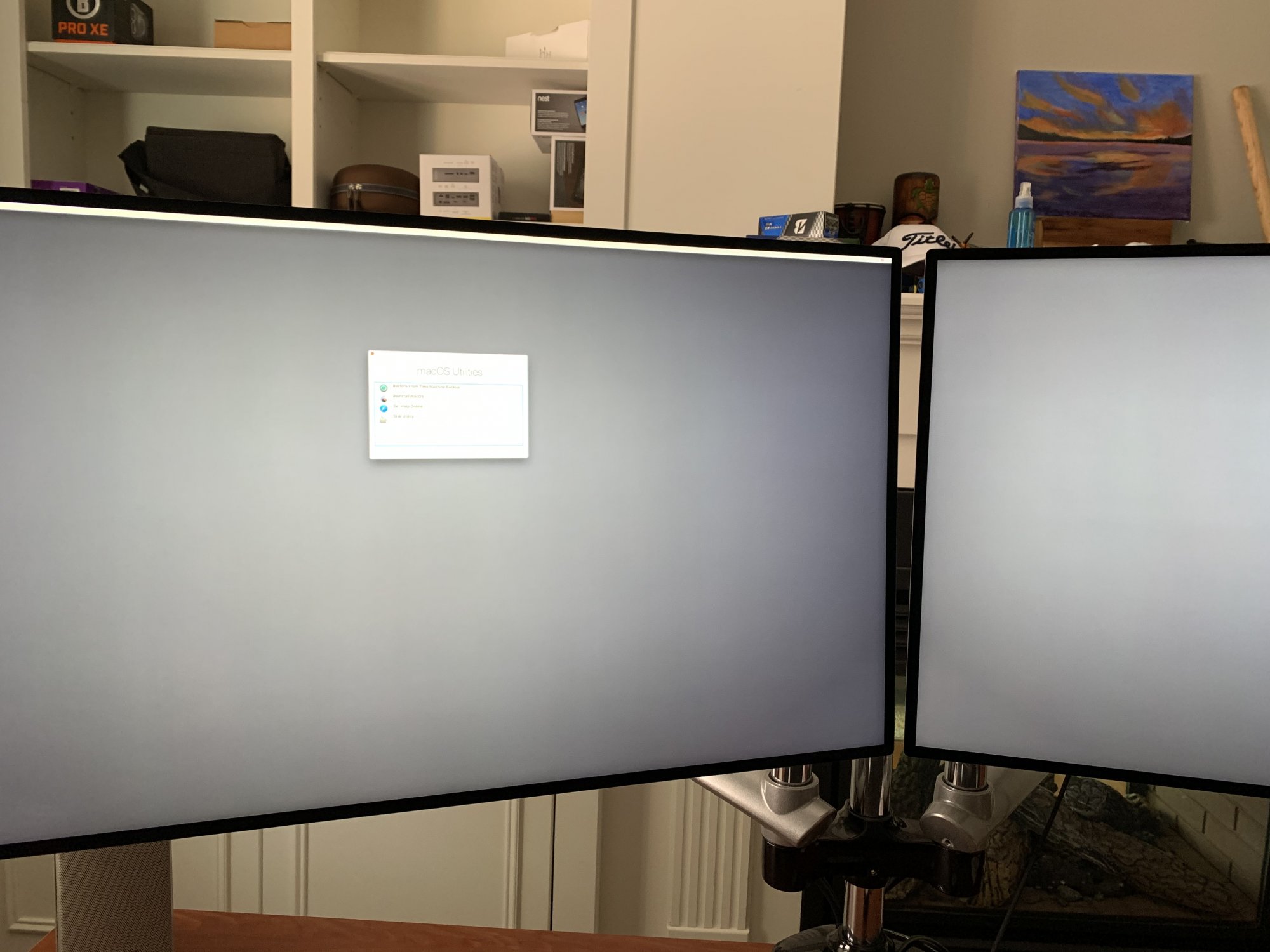

Just received a new system I configured with the Vega II for comparison in my MacPro.
W5700X driving dual XDR displays = completely glitched out on 2 systems I replaced
Vega II driving dual XDR displays = 100% perfect, no corner window glitching, white lines, or blocky corruption as seen with the W5700X in setup screens.
I've documented the issue across two W5700X machines now. Got them. Apple can't deny the issue any longer
