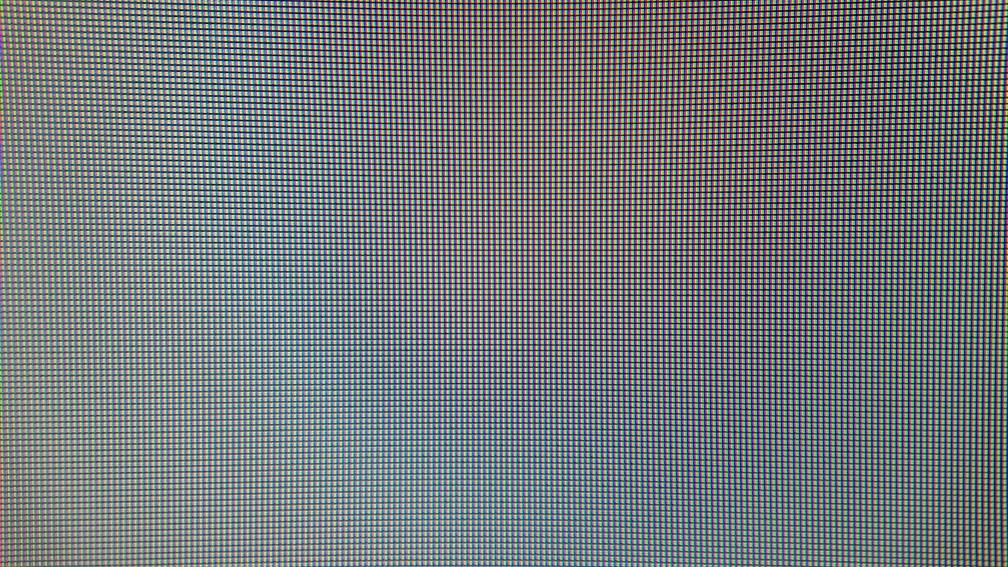

Look at the attached photo of iMac 5K display I took. There isn't enough room between pixels.
