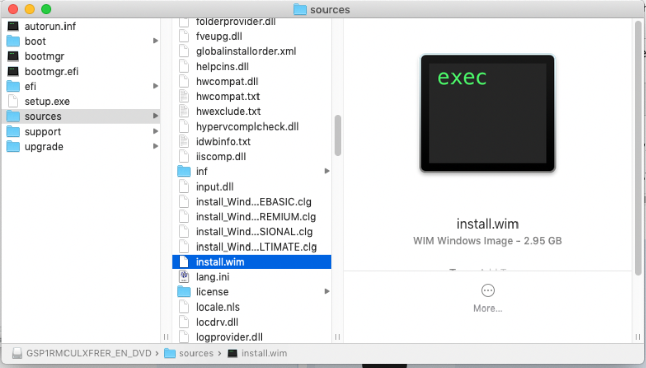

The image may not be original and does not match the path - /V*/*/sources/install.*
Although there would be formatting, but your formatting is also missing.
The same image works fine for hybrid MBR. Also tried the Windows 7 image with the same result. That one also works fine for hybrid MBR.

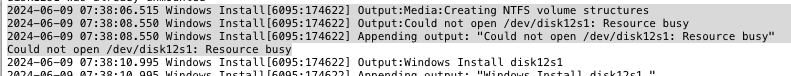

Code:
Could not open /dev/disk12s1: Resource busy
Windows Install disk12s1 Applying image 4 ("Windows 7 ULTIMATE") from "/Volumes/GSP1RMCULXFRER_EN_DVD/sources/install.wim" to NTFS volume "/dev/disk12s1"
Volume BOOTCAMPMBR on disk12s1 mounted
hivexsh: failed to open hive file: /Volumes/BOOTCAMPMBR/Windows/System32/config/SYSTEM: m
It is failing to apply the image to the MBR partition.

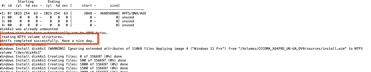

Try changing the name. The mkntfs utility worked, but now Wimlib does not want to work.
Doesn't help. The drive is seen as an external USB disk and I see a lot of unmounts/remounts.
  • Windows Install-Output.txt
Again formatting did not happen. I'm sure it's a disk problem. Above in my attachment you can see that the installation was successful.

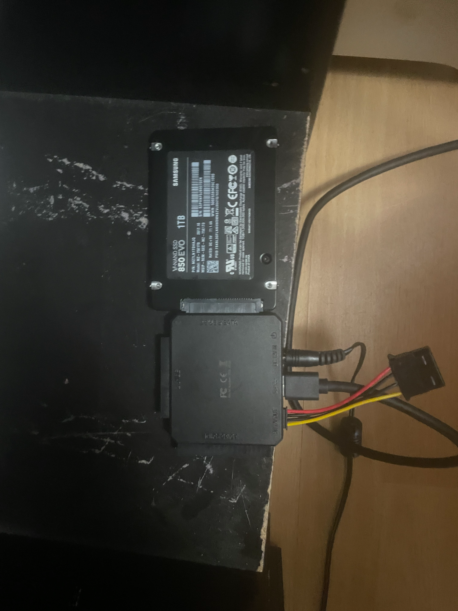

It looks like there is a problem with the external drives. I mounted the SSD as an internal drive below the DVD-ROM and it worked fine.

I install Windows using a program only on an external USB drive, and the first launch of the system with a hybrid partition, or MBR, I do on a SATA connection on my daughter's computer.

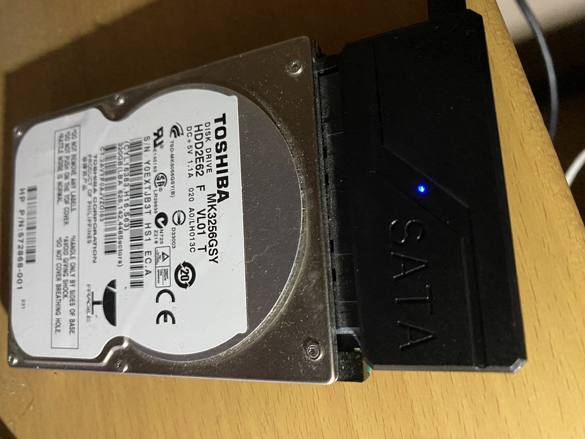

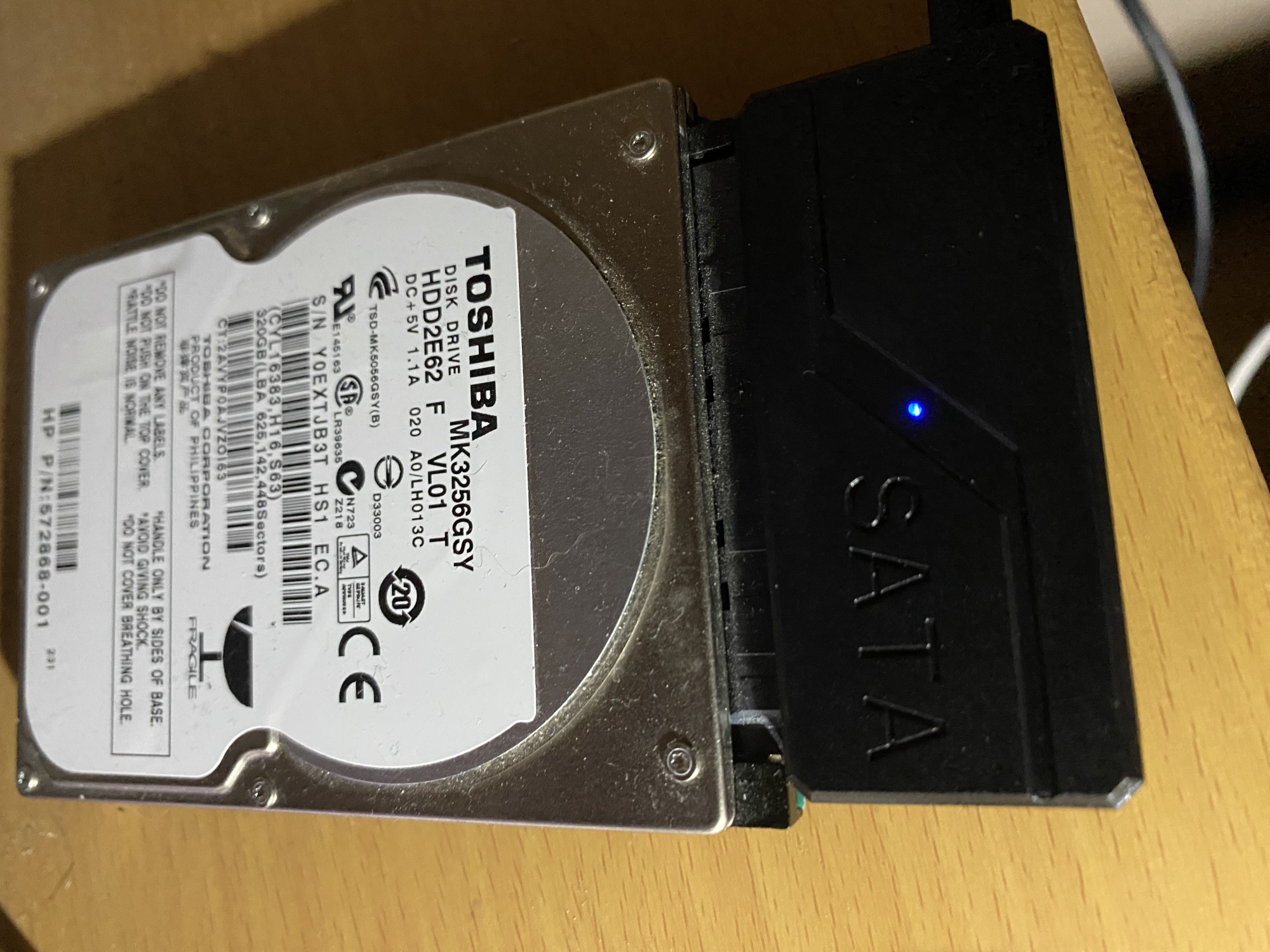

I found a very old HDD disk and three times in a row what happened to you happened, on the fourth time the installation started. I don't think there will be such problems with SATA.tempImage4aDFbO.png

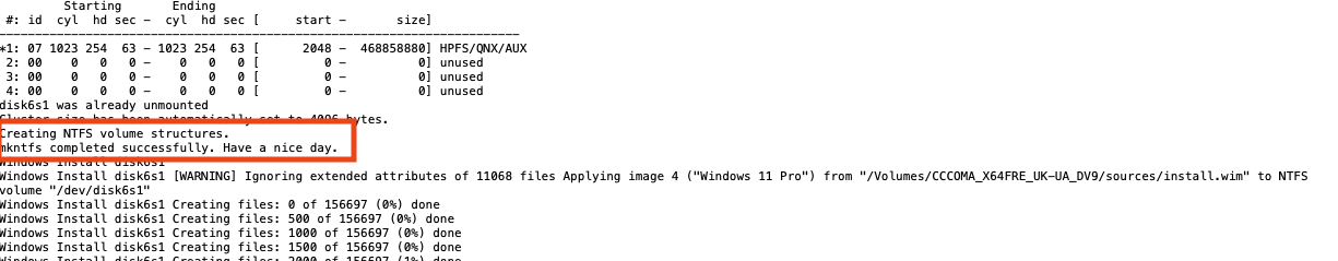

Unfortunately the above procedure does not work for Windows 10 ISO. Go figure.
I can install Windows 10 in UEFI mode, but not in MBR nor in Hybrid on the external disk.
