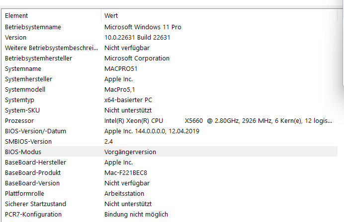

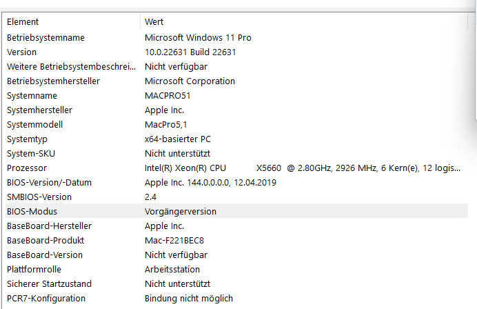

Windows 11 on Mac Pro 5,1 - directly installed with v6.1.6 to a 1 partition MBR Sata SSD:
BIOS-Modus Vorgängerversion means Bios-mode: legacy

Windows 11 Pro - log is OK.
I can assume that the /Volumes/Windows10/Windows/Boot/PCAT folder is not always copied in full to form the bootloader. I will check in the next version. How do you like the "Deactivate Windows ESP" option, is this what you wanted for MacPro?

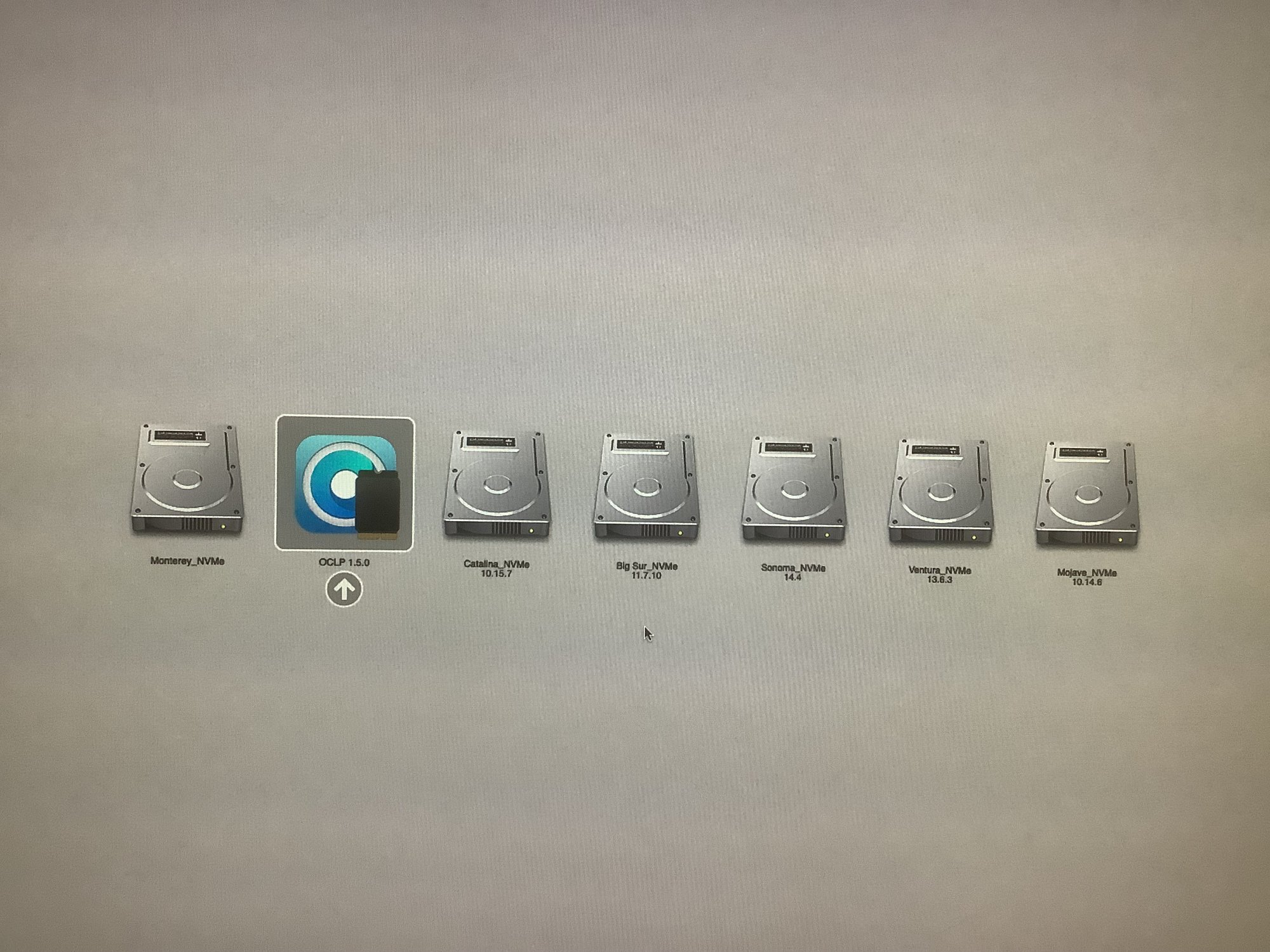

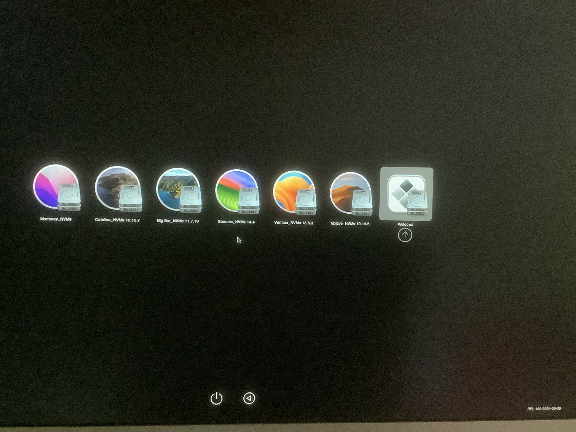

For those who wonder, what deactivate Windows ESP does:
It turns off booting directly UEFI Windows, without use of a bootloader, like OpenCore or RefindPlus.
To avoid signing the bootrom with certificates - as those two bootloaders protect the bootrom from getting certificates.
Native Apple Bootpicker, Uefi Windows is not visible, also unable to start at all
OpenCore, UEFI Windows could be selected and booted, no certificates as OC protects the bootrom

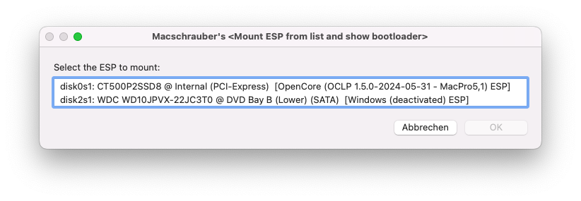

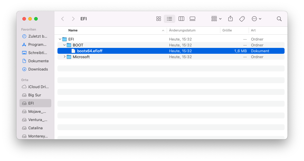

Windows update may recreate the bootx64.efi.
Yes, indeed,
Thats why
mount ESP from list and show bootloader
Asks to deactivate (rename bootx64.efi to bootx64.efioff) when mounting a Windows ESP.
There is also a script: Check ESPs for MS certificates, what scans thru the ESPs, alarms and asks for deactivation.

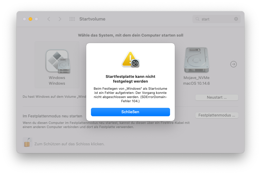

Did the same as #151, only difference: 1TB Sata HDD, 1 Partition ExFat, MBR, formatted before attempt.
This time it doesnt show up in BootPicker
Edit: it appears in Startup Disk, but when selected it threw an error SDErrorDomain 104
In the log there is this line - Unable to open /dev/disk2, Resource busy
Therefore, the boot record did not occur.
Restart your computer and try installing Windows again.
Sounds like a device lock. Most probably by spotlight. You might want to do the disable/enable indexing during the process. Sam as for the autoremount. Plus on such an error the script should ext and say unsuccessful. There is no sense to continue.
You can add a condition to wait a while for the disk. And try again.
Or at least tell the user to take actions to unlock the disk.

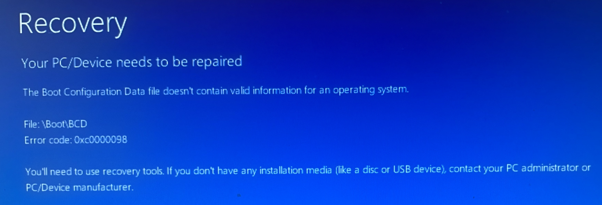

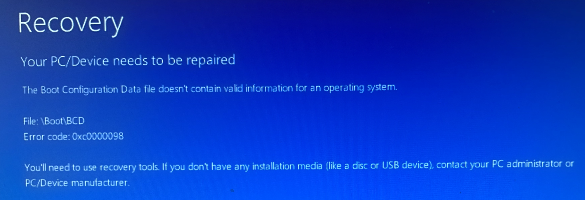

Tried to install Windows 11 in hybrid and UEFI modes on MacMini6,2. Got BCD error in UEFI and no boot disk in Hybrid modes.
  • Windows Install-Outputhybrid.txt.zip
  • Windows Install-Output UEFI.txt.zip
UEFI installation - for some unknown reason the hivexsh utility did not work. If this happens again, try chmod 777 /Users/mavericksserver/Desktop/Windows Install.app/Contents/Resources/tools/bin/hivexsh
Installation hybrid - ms-sys utility, compiled on MacOS 10.13, should now work.
