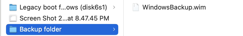

I have attached the external drive to my MacBookPro15,1 running Sonoma.
Disabled indexing sudo mdutil -i off /
Unmounted manually the partition and Installed Window 7 in MBR mode.
Enabled indexing sudo mdutil -i on /
As you noticed, I left the option to install on a hybrid and MBR from a system higher than MacOS 12, but your bootloader is saved in /Users/mbp151/Desktop/Legacy boot for Windows (disk6s1). Then manually copy to the Windows disk using third-party programs.

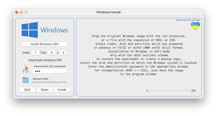

Test version 6.1.6
What I added and corrected:
version 6.1.6
1. Added disabling auto-mounting for external drives
2. Minor fixes
version 6.1.5
1. Installing Windows on MBR (format the disk only exFat)
2. Deactivate Windows ESP for Windows UEFI (also works for restoring bootloader EFI partition)
3. When installing Windows UEFI, if the drive is hybrid, it is converted to GTP
4. Checking the disk for disconnection
5. Eliminating random BCD error
Do not forget that this is testing, there should not be any valuable information on the disk.
I tested three options on a second generation Intel PC - «Install Windows UEFI» (GTP), «Install Windows legacy boot» (GTP+ MBR) and «Install Windows legacy boot» (MBR). Installed Windows 7, Windows 10, Windows 11.
