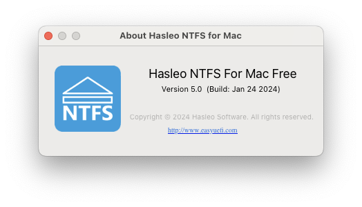

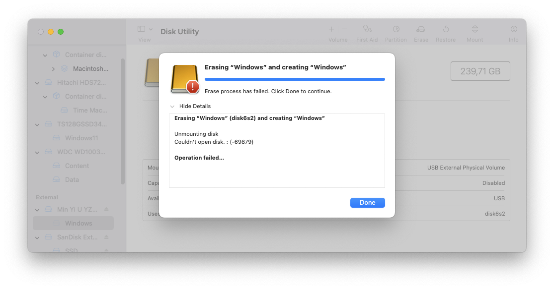

This will not let me write.
You must first unmount the partition and then mount.

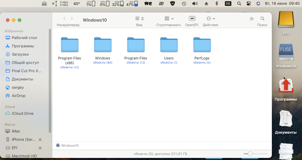

Oh, first time I caught “Resource busy”
And did not allow me to format the disk.

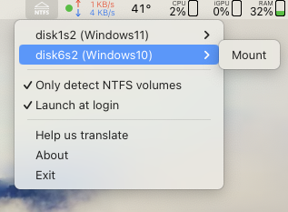

I did not find what the disk was holding. After rebooting the system with the disk there were no problems.
Made - Disable Automount for internal/external disks.

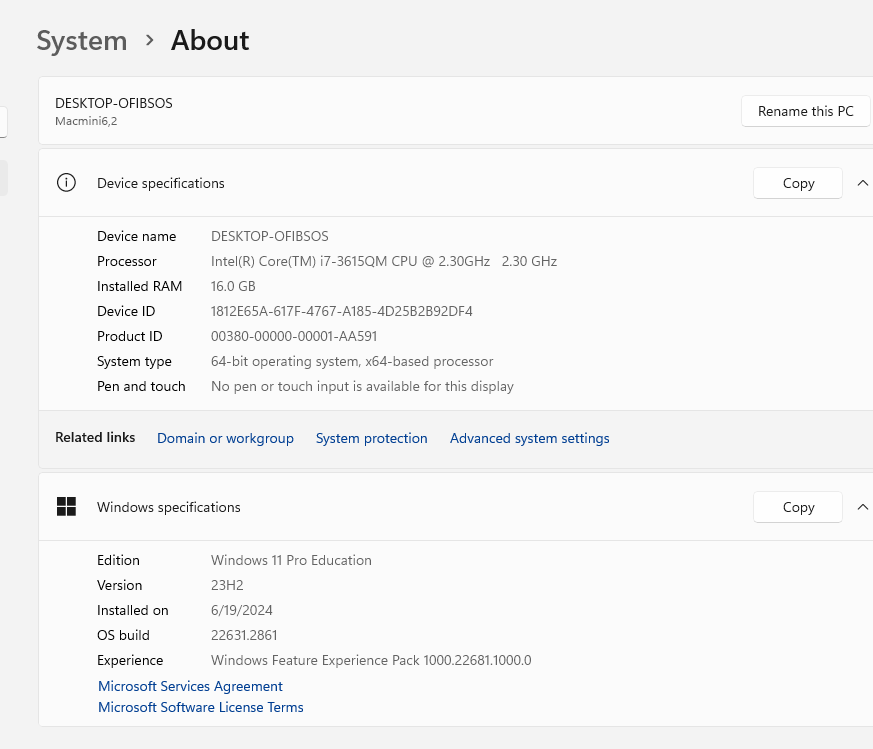

I changed the sequence, now after formatting in NTFS is a create windows boot record and Windows Disk Signature to the MBR and if the disk resource is busy, there is a notification, and the script stops. Next is the deployment of the Windows image and the formation of the system bootloader.
  • Windows Install.zip

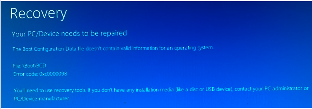

Same error in Catalina for the BCD record.
  • Windows Install-Output.txt
Yes, it's the same error. winload.txt is generated correctly in the user's folder, just like BCD-Windows. I think the system cannot work with the hivexsh utility, there are not enough libraries, or they were damaged. If you want, try reinstalling the system over the old one. I have Mac OS X 10.15.7 and installed Windows from it without any problems.

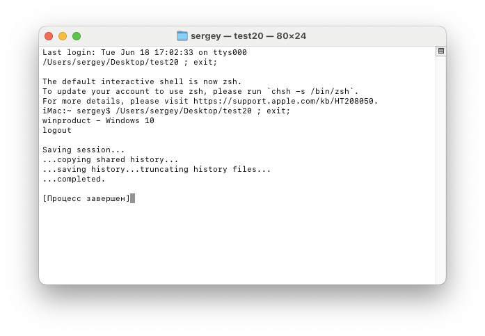

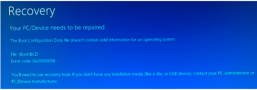

Completely erased and reinstalled Catalina.
Code:
on ttys000
catalina@Catalinas-Mac-mini ~ % /Users/catalina/Desktop/test20 ; exit;
winproduct -
Still the same error on boot.

on ttys000
winproduct -
Did some versions of the program work correctly before? Try running the program from another folder, for example “programs”
Edit:
This could be because the HS partition is on the same drive as the BOOTCAMP partition.
It works from HS if Bootcamp is not on the system disk.
So the only issue is in Catalina. SIP would affect both macOS’s.
Code:
cd /Users/catalina/Desktop/Windows\ Install.app/Contents/Resources
catalina@Catalinas-Mac-mini Resources % ./tools/bin/hivexsh -d -w -f "$HOME"/winload.txt "$HOME"/BCD-Windows
zsh: killed     ./tools/bin/hivexsh -d -w -f "$HOME"/winload.txt "$HOME"/BCD-Windows
In your log file as well :
Code:
/Applications/Windows Install.app/Contents/Resources//scripts/scriptInstall: line 355: 60923 Killed: 9               ./tools/bin/hivexsh -d -w -f "$HOME"/winload.txt "$HOME"/BCD-Windows
Code:
Code:
Yes, this is when SIP is enabled. There are two files, one with SIP enabled and the other not.

4 minutes 43 seconded Windows 10 installation.
Reactions: Sergey-Galan
