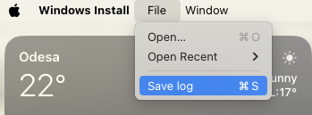

It would be nice to see the log

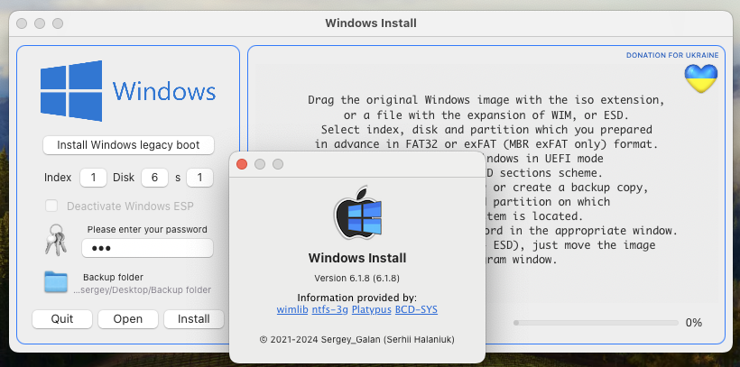

Failed to create main BCD store. But this time the hivexsh utility worked, but stopped without finishing its work. I don’t know what prevented it. In version 6.1.8 added a check for BCD creation.

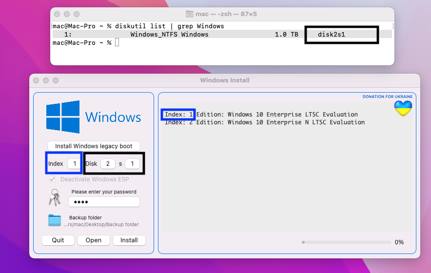

What is the index field and how does it relate to the drive you are using? I've looked back and can't see it mentioned anywhere. I'm guessing that it refers to the list of index that are displayed when you D+D the ISO file?
It defaults to index 10, which is "Windows 10 Pro for Workstations" in this case?
