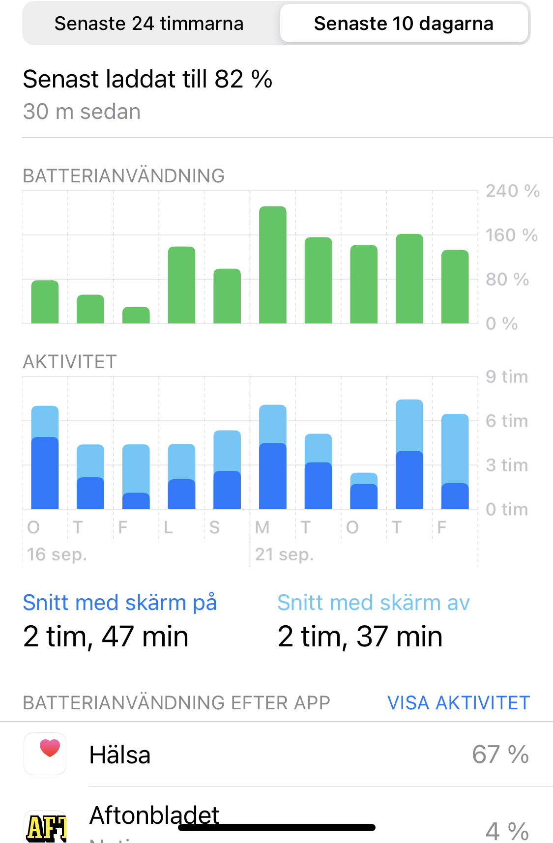

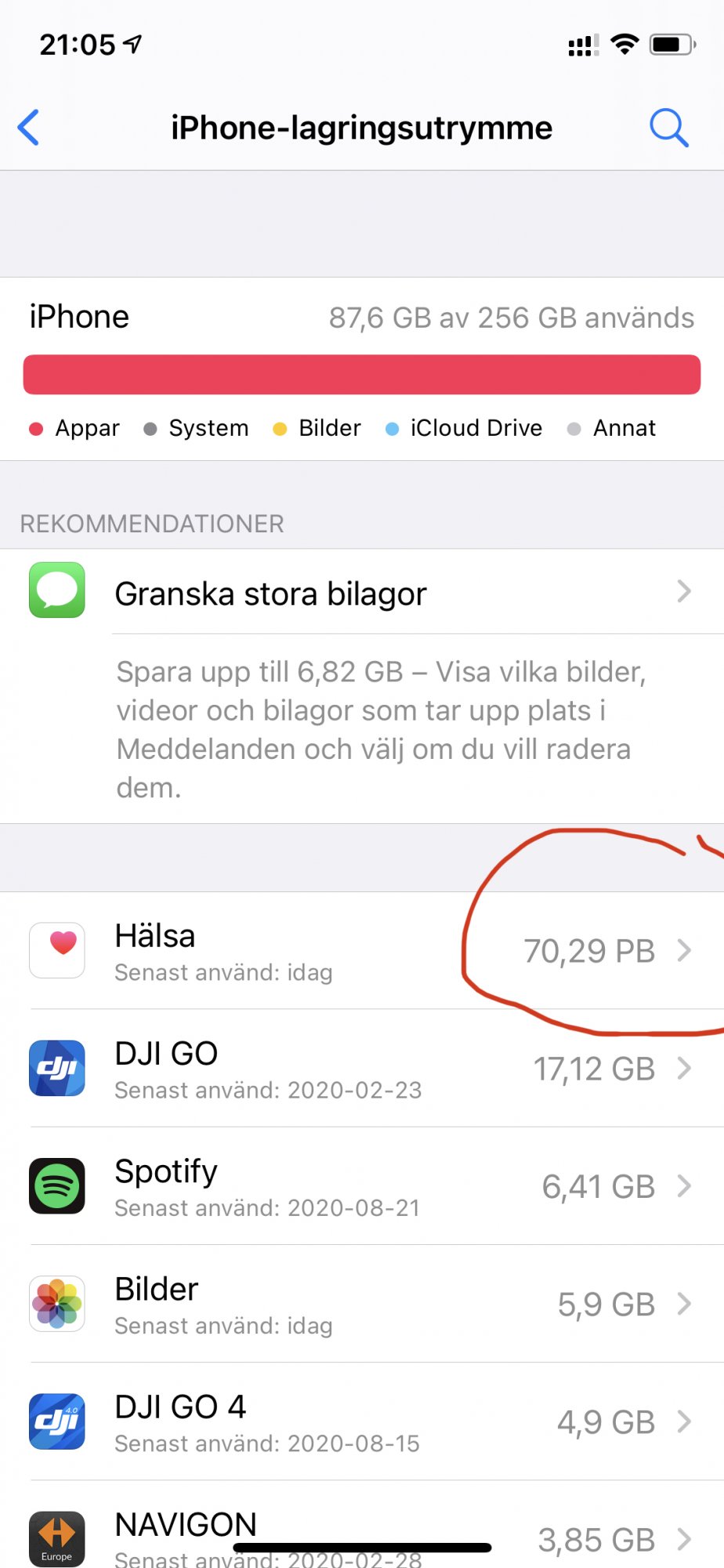

It is actually a bug primarily that make peoples iPhones and apple watches to drain. The health app is continuously trying to sync with the watch and the disk space used is crazy, mine claims 70PB yes petabyte! Ppl with no watch does not get this glitch in general. Apple is aware of it and right now no solution done. They said 7.01 for watch would fix it, but no.Still using 70PB of space on my 256gb phone and the health app is slow, settings app crashes for watch etc etc. Workouts do not sync. I right now charge my phone 2-3 times a day and it’s constantly heating in between. Apple official forum has a long thread about this.
best you can do now until full fix is ready:
1. Disable the new sleep app on the watch , many relate issue to that one
2. Disable iCloud sync for health app
3. Install 7.01 Apple Watch is.
above steps will help you regain battery capacity in both units (phone, watch) but will not solve al problems if your space is claiming petabytes being used. Some people have completely unpaired their watches with some resultin repairing , others just left the watch unpaired awaiting a fix

Hur stänger jag av health appen helt?
Det tror jag inte går, ta disable i icloud sync för health, samt i hälsa slår du av att den ska hantera sömn. De två stegen i kombination med watchos 7.01 har löst dräneringen åt mig, men appen säger fortsatt att den nyttjar 70PB utrymme :)
