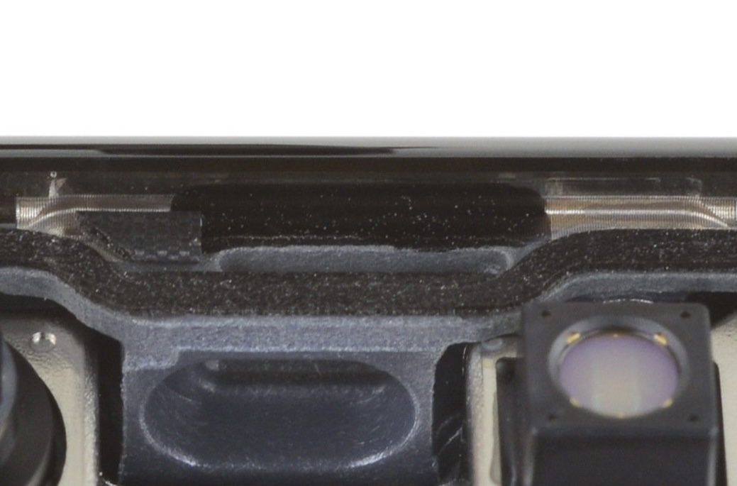

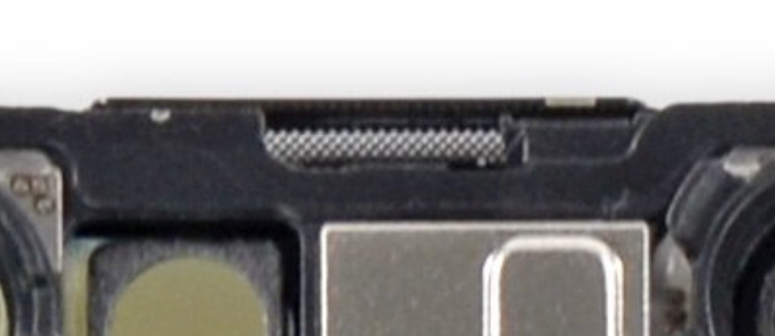

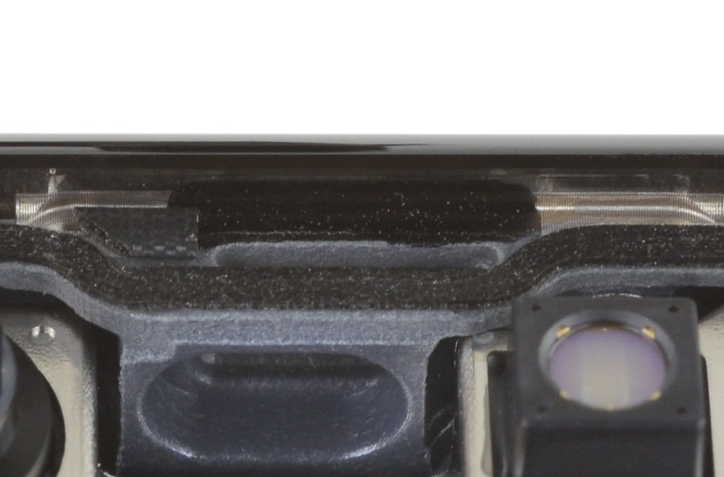

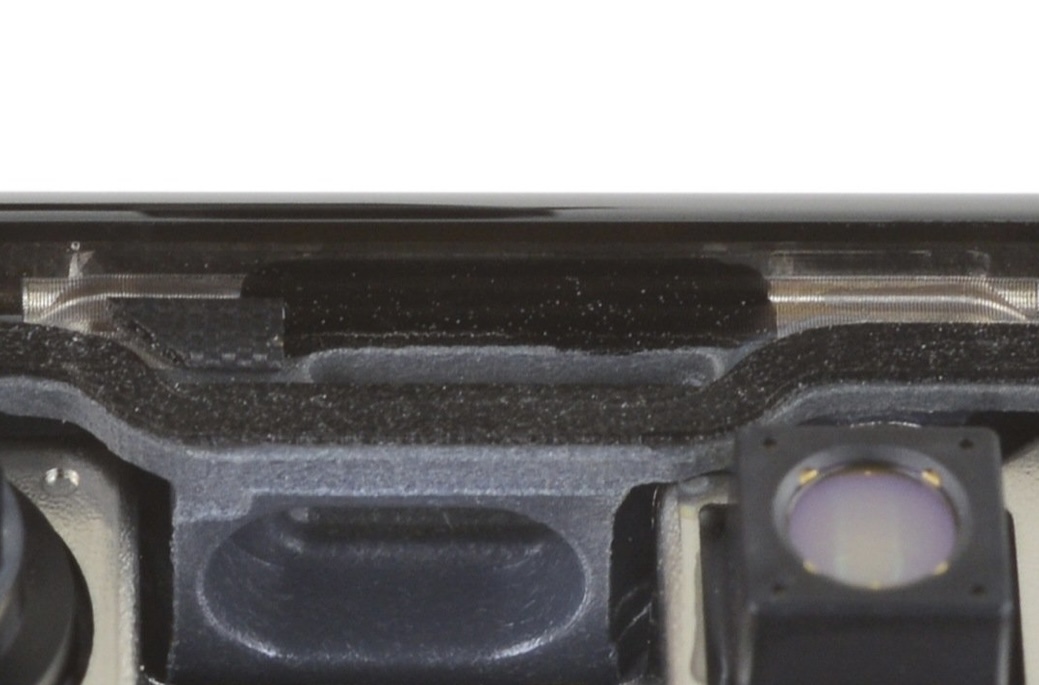

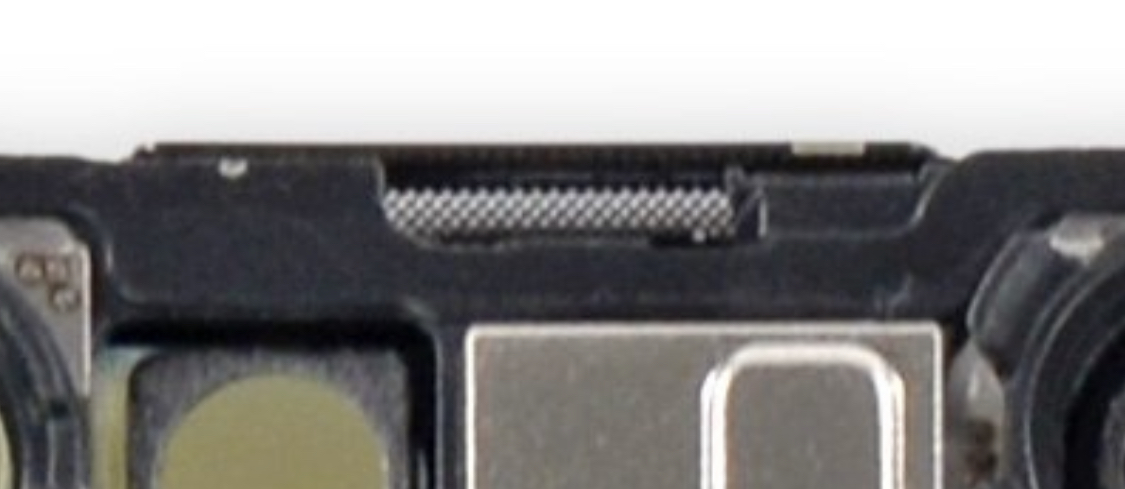

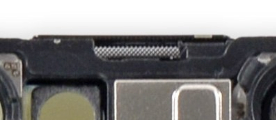

Very good post. I always use a lens brush gently in those pesky gaps. 😂I noticed a few people in this thread say they thought there was “glue” to the left of the earpiece in the top “gap”. This is actually a wedge-shaped piece of black conductive foam. It bridges the phone body to a sliver of exposed metal on the back of the earpiece grille to electrically couple them. For goodness’ sake don’t try to scrape it out!
(NB the black line above the duct here is just paint, the foam is the small slightly lighter piece to the left.)
(NB as this is the back of the grille, the contact point is on the right.)
You shouldn’t be using paper or pins or the like to try to root dust out of the top edge regardless, you will damage that foam or the adhesive seal. If you must I’d recommend a soft size zero or smaller paint brush instead. Hold the phone upside down so you don’t brush dust in to the duct behind the earpiece, which leads to the speaker. The duct is outside of the water/dust-proof enclosure and although the speaker itself it is sealed against water, the duct has some narrow ports which clog easily. You don’t want to accelerate that accumulation by sweeping dust in there.
