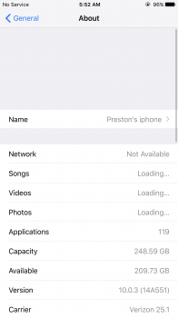

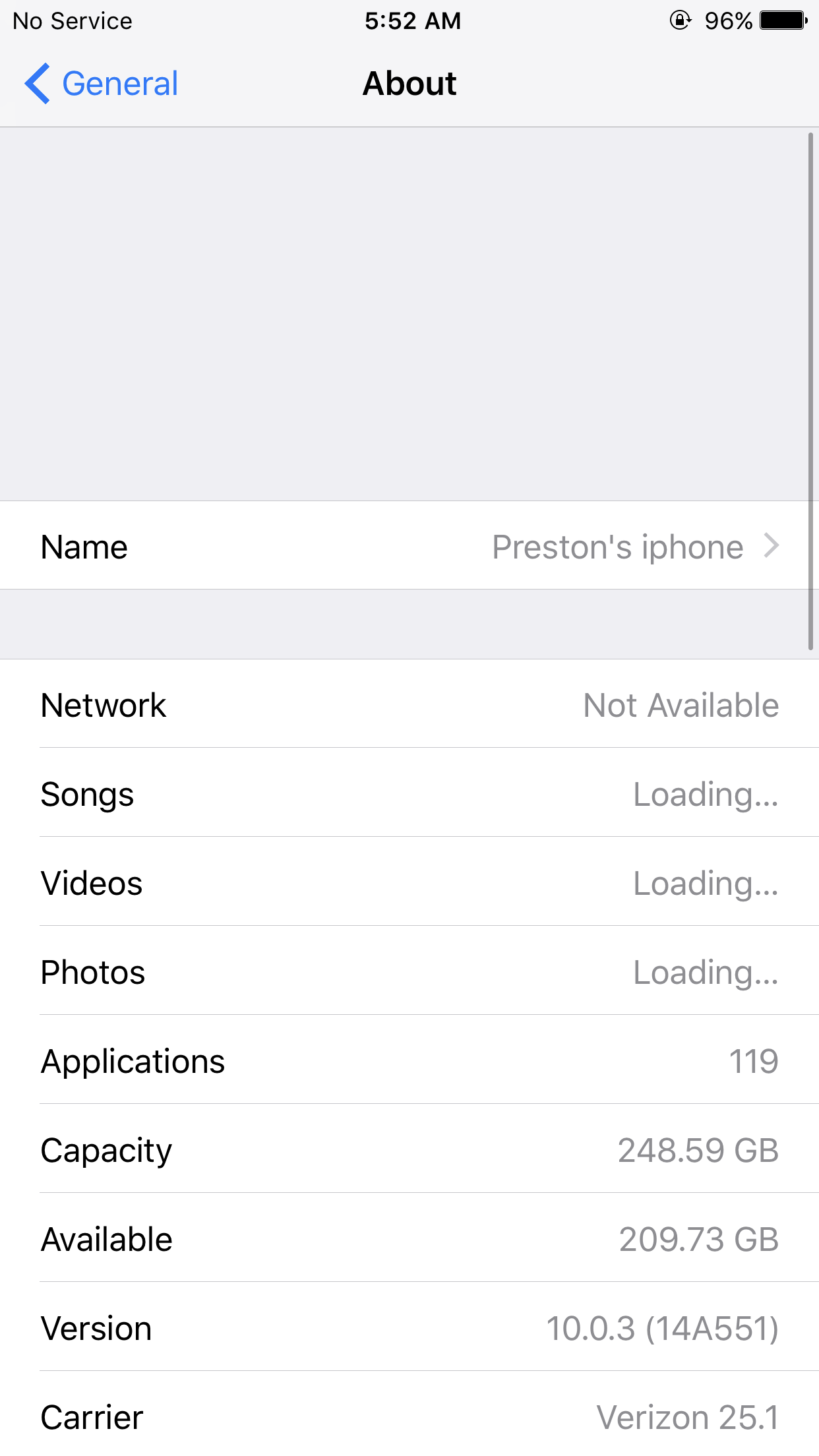

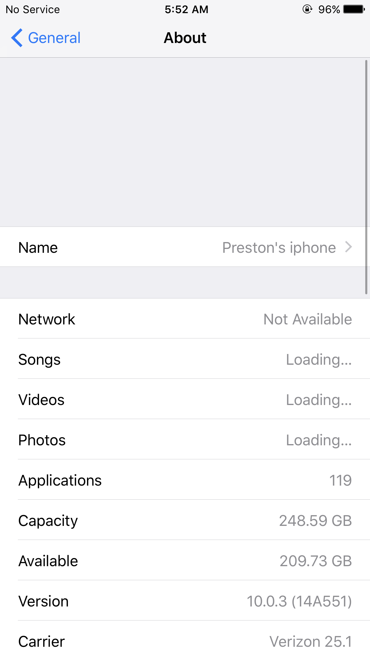

10.0.3 does not seem to have fixed the issue for me. I am still getting drops to no service or 1x and I have to toggle airplane to get LTE back. Frustrating.
I was confident the fix would remedy the issue for me, however just had a drop in an area that I am positive has decent LTE coverage. Right outside my office building. Dropped to No Service for 10 seconds, then fluctuations between 1x, 3G, and none of the above. Toggling airplane mode restored LTE almost instantly. Wondering what Apple did fix 😡
